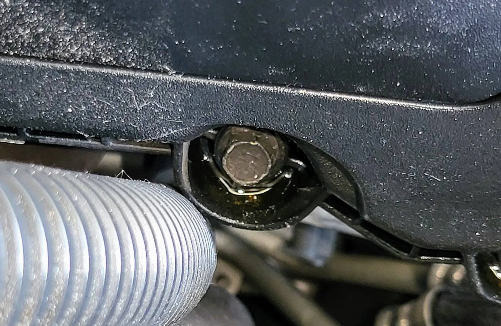

funny you mentioned the "loose" bolts on the valve covers. after the mechanic brought me my car (after the alternator repair), I smelled burning oil. the service mgr and dealership mgr could smell it as well. i opened the hood and you could see it seeping out due to a loose bolt!!! i was pissed!!! i didn't scream/yell at anyone; just told them they lost a customer who purchased 3 mustangs in 3 years. i sent this picture along with my feedback to Ford.
