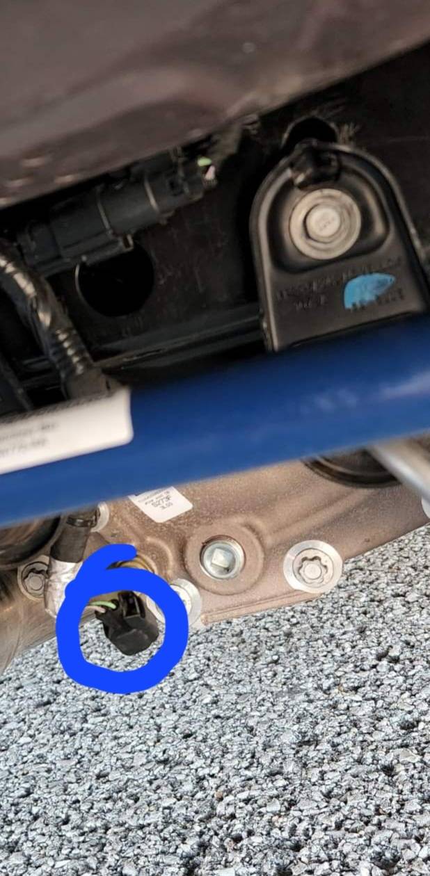

Sadly, my female end to the cap has a broken tab and wont stay on the sensor. Is there a part number for this so i can depin the broken and install a new one? Thanks in advanced

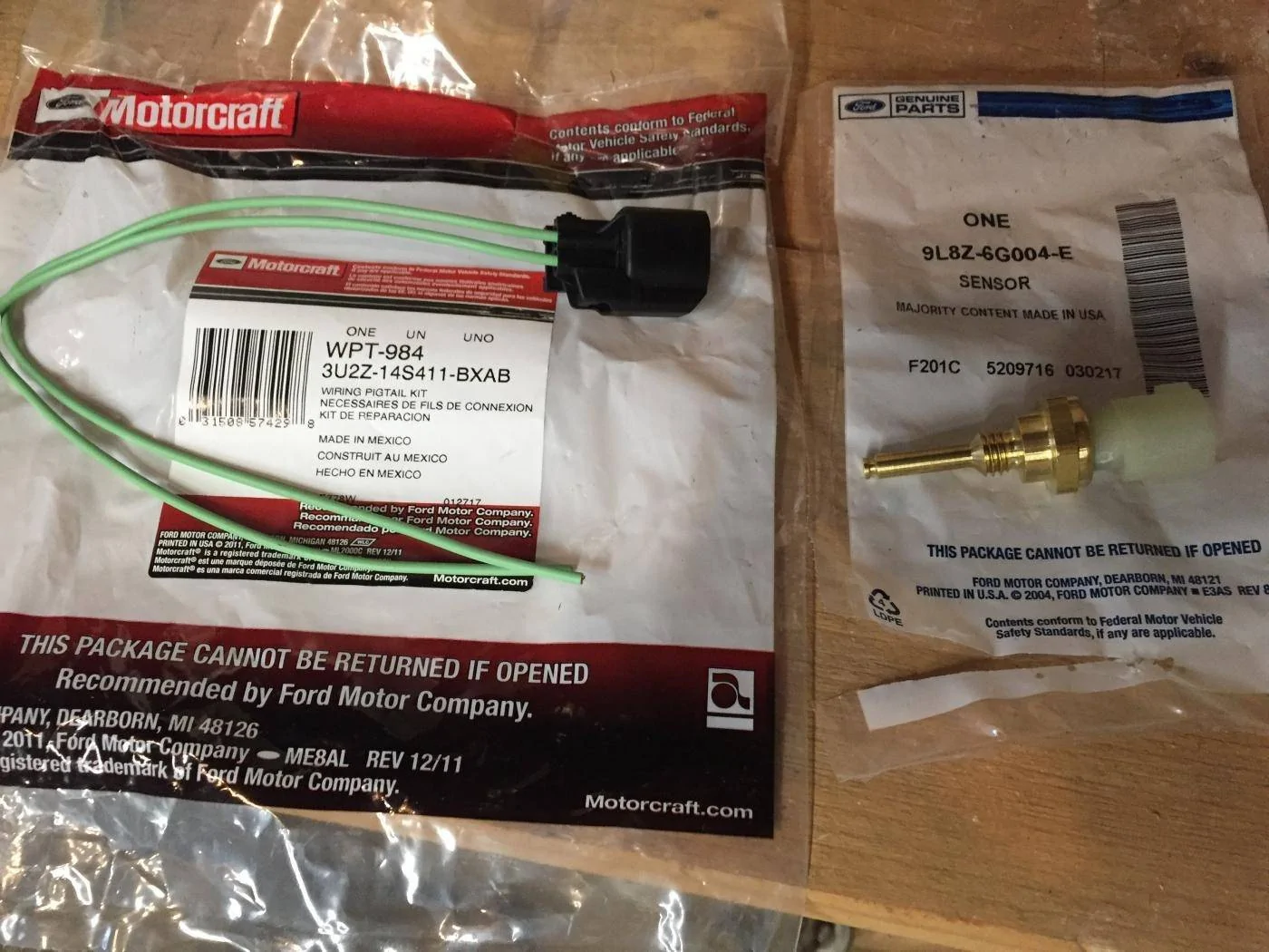

The wire/connector is replaced as a Motorcraft Pigtail.
Here is the pigtail and also the sensor part numbers.
Thank you!!!! Your a life saver
