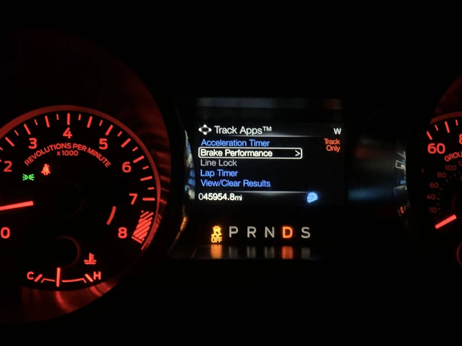

line lock greyed out I have a 2018 Ford Mustang GT Convertible and I’m in track mod and its just grayed out.I have inserted a image to show

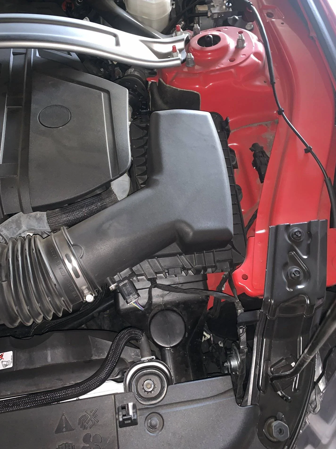

You didn't pull the plug by the airbox, did you? That kills line lock.
brucelinc
Jan 25, 2018
3,104
2,132
MN
Bruce
2018 Mustang GT premium A10 (SOLD)
Drivers side between airbox and fender. I noticed the "traction control off" light is illuminated in your picture. Did you turn it off or does the light stay on? If the plug is unplugged, the light stays on.

You can't turn off the traction control/stabilitrak and use the line lock.
I turned on track mode and it turned off traction control I’ve had it in different modes and it still grayed out

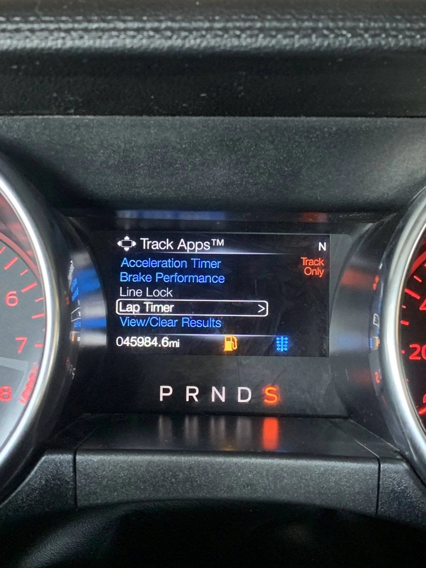

Here it is in sports mode and traction control on

The following conditions must be met to initialize Line Lock:
• The vehicle is on a level surface.
• The engine is running.
• The vehicle is traveling less than 25 mph (40 km/h).
• Selectable Drive Mode is not in wet mode (if equipped).
• There are no electronic stability control faults
nicolasfinta1
nicolasfinta1
Aug 30, 2019
125
Los Angles
Nicolas
Ford Mustang GT convertible premium 2018
I met all those quotes should I get my obd scanner and see if there’s any errors

More,,,
The following conditions must be met to engage Line Lock:
• The vehicle is stopped.
• The parking brake is not applied.
• The driver door is closed.
• The transmission is in a forward gear.
• There are no electronic stability control faults.
• The steering wheel must b

Meeting all of the conditions is all I can think of......

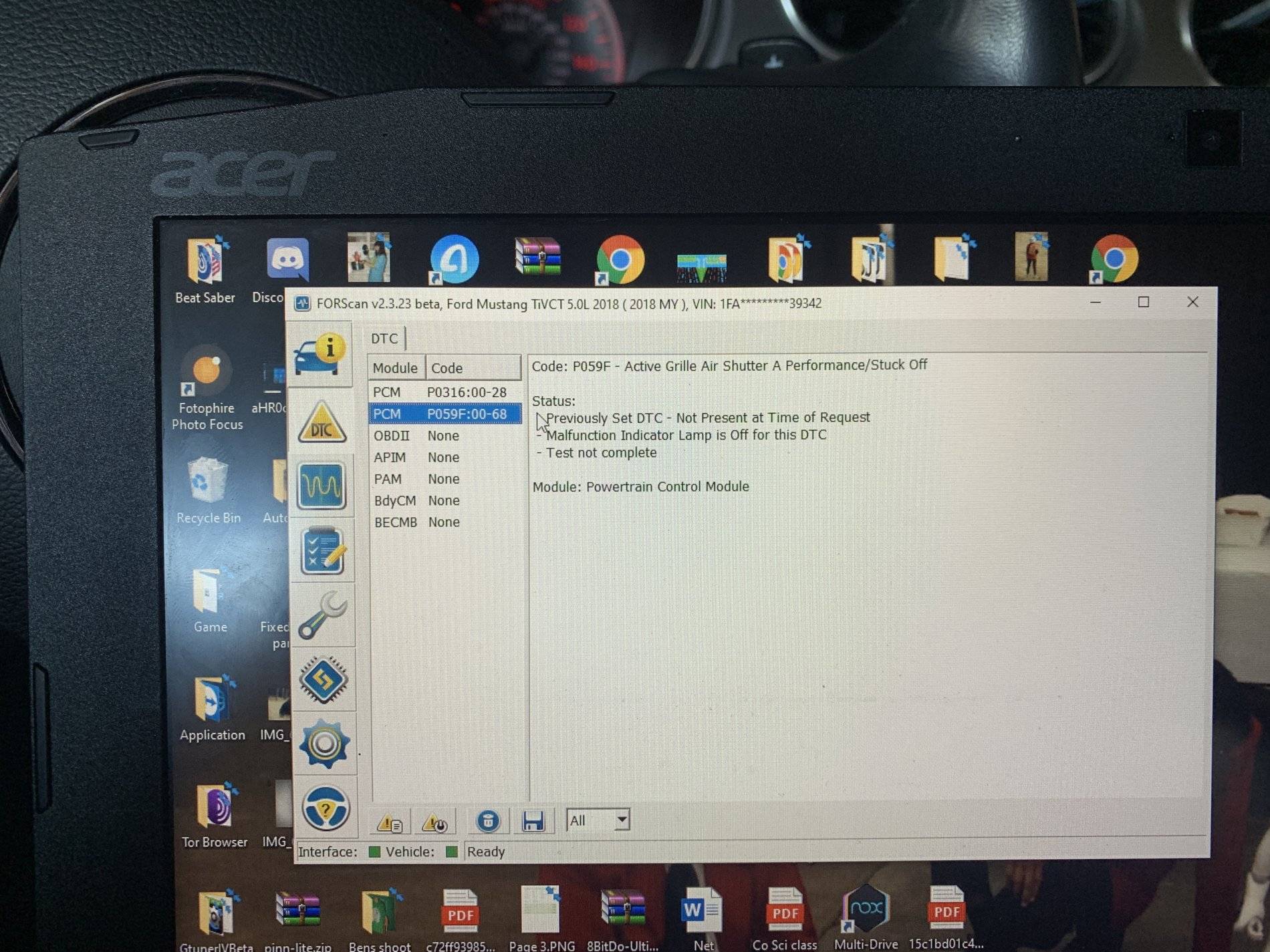

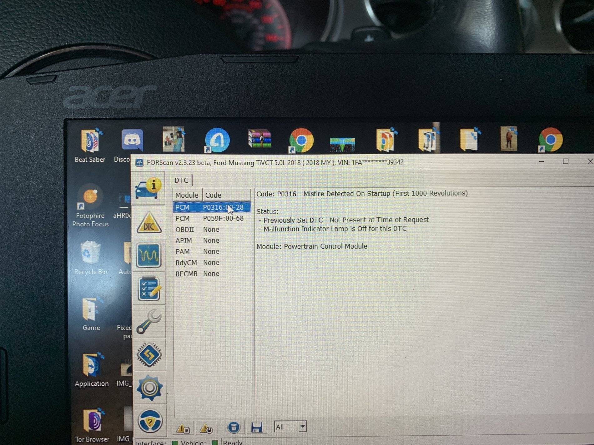

Im in for scan and getting two errors
