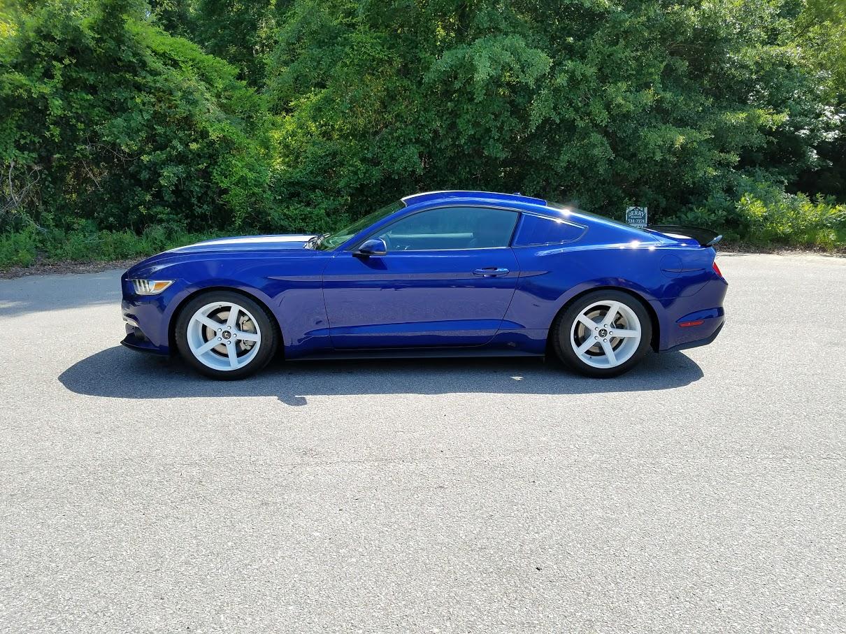

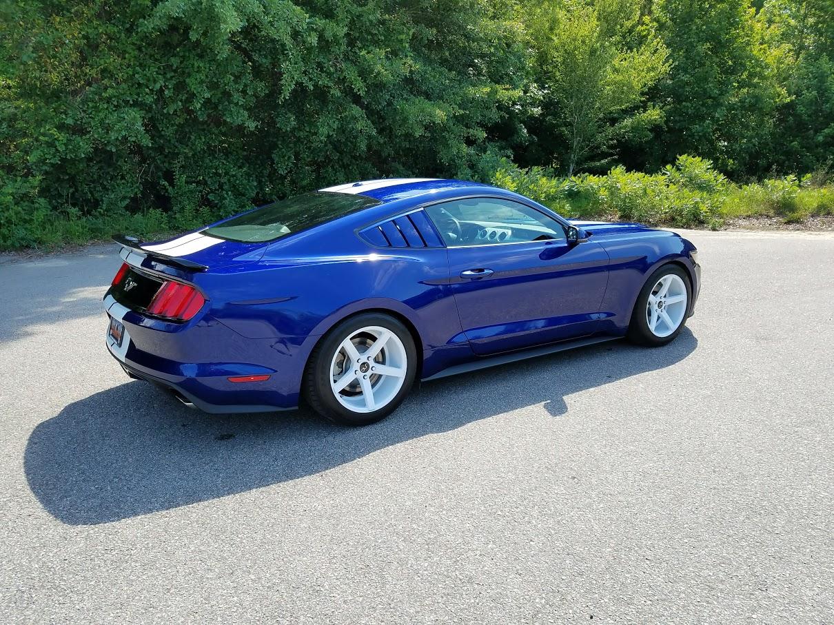

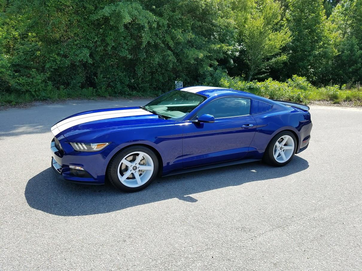

here is the square set i found.

I wanted to be part of this thread so badhere is the square set i found.
