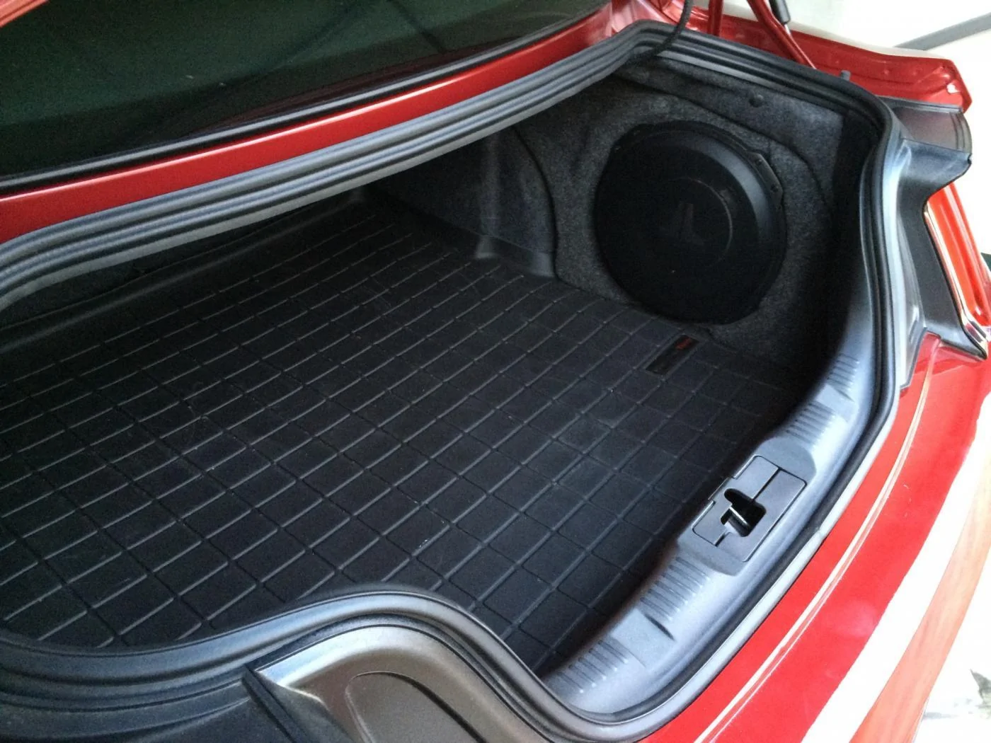

Subwoofer
I choose the cheap way out. I installed the OEM Shaker subwoofer from the Shaker Pro system.
I have the Premium Sound system (base) with the 300A package. Works OK but it ain't no boomer.
Wish you had been on this site a little longer... you would have found the shaker sub is weak and saved yourself some money :(
Actually I completely understood what I was doing. I didn't want to spend a lot of cash & wanted the OEM look. The only other OEM system sub out there is the JLAudio sub that's $800 for just the sub and then you have to purchase the amp.
My total investment was a little over $400. With the JLAudio sub I'd be well over $1000.
I just wish other audio manufactures would be on the bandwagon and develop a OEM style location for the sub. I'd love to get a MTX Audio sub but they don't have one for the 15-17 cars yet. :(
The OEM Shaker sub I have now just fills out the rear with bass. At high volume it does a good job.
Many people on here want the sub that blows them out the windows but this does just fine for me. ;)
