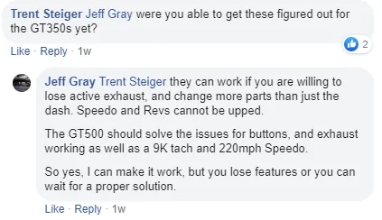

The speedo and tach don't do it for me. I'm waiting on the verdict on the GT500 clusters. Jeff from Hellhorse is looking into it I believe

Correct. Based on the very large thread stickied in the Infotainment section on here, many have confirmed that 2018-2019 digital cluster RPM can only be modified to be 6,500 or 7,500 RPM, nothing more.
I would wait for the Shelby GT500 cluster to be available. Depending on GT500 production figures, if that digi cluster does become available, it’s not going to be cheap. I’d also suspect that even if getting the GT500 digi cluster, there might be other modules needed to getting it to work 100% in anything other than a GT500 due to hardware and software variances between models.
Hoping this may at least be possible. Searched for images of GT500 dash but pics show the display only going to 8K.
