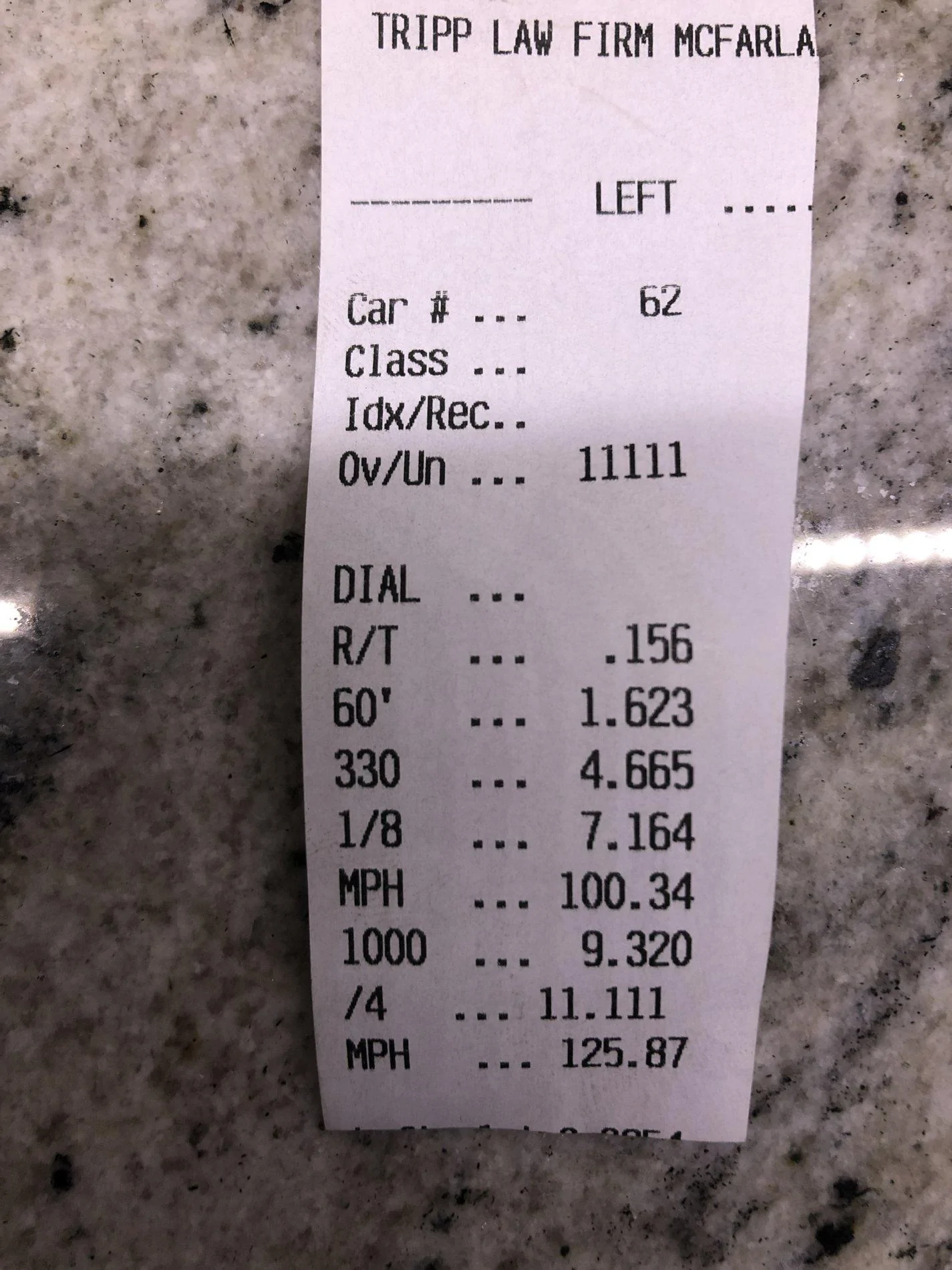

I may have missed my opportunity to hit my goal of hitting a high 10 with loosing low DA weather. I realize I might have to wait until November here in Florida.
I’m able to pull a 1.6 and possibly a 1.5 60ft with my setup right now. My driving is about as good as I can be.
I’m still running full weight minus the spare tire. Next time I go to the track I’ll disconnect the sway bar and max out the front tire pressures too.
My car came factory with 3.55 gears and with a 2018 MT-82 having fourth gear 1-1 I’m trapping at about 5600 rpms. I just installed 3.73 gears hoping for about 6000 to 6200 at the traps.
Anyone with experience with a small change in gears and how effects 1/4 time and trap speeds?
Thanks!

Thanks for both of the replies. By far I need a tune. (Still on the roush tune and original pulley) I was trying to retain the roush warranty. VMP published a great video on YouTube of a 2018 GT A10 with huge gains at the track after a tune.
After I installed a chiller for the Intercooler water I gained a lot of power back. Close to 65 horsepower and 40 torque. Having the Intercooler water at about 45 to 50 degrees F makes a big difference. I figured this would be enough to allow me to sneak into the 10 sec range.
I’ve tried to work with what I have outside of obtaining a tune. VMP will be my choice though when comes time. Here is my last time slip if anyone would like see. Only thing disabled is the active stability and trac control off via button.

You are flying for a Roush tune. I have a fairly simple setup with VMP Gen 2r and 79mm pulley running 10.70s at 130 on VMP (Joe) tune. His tune is solid and the support is there if needed. I like the chiller idea. My iat2s were 110-120 when running those numbers.

Man I wish it was that awesome! I can keep the water temp for the Intercooler at 40 to 45 degrees. IAT2 at the end of a run is about 105 to 110. I’m sure a whipple or VMP Intercooler would yield better results than a roush.
