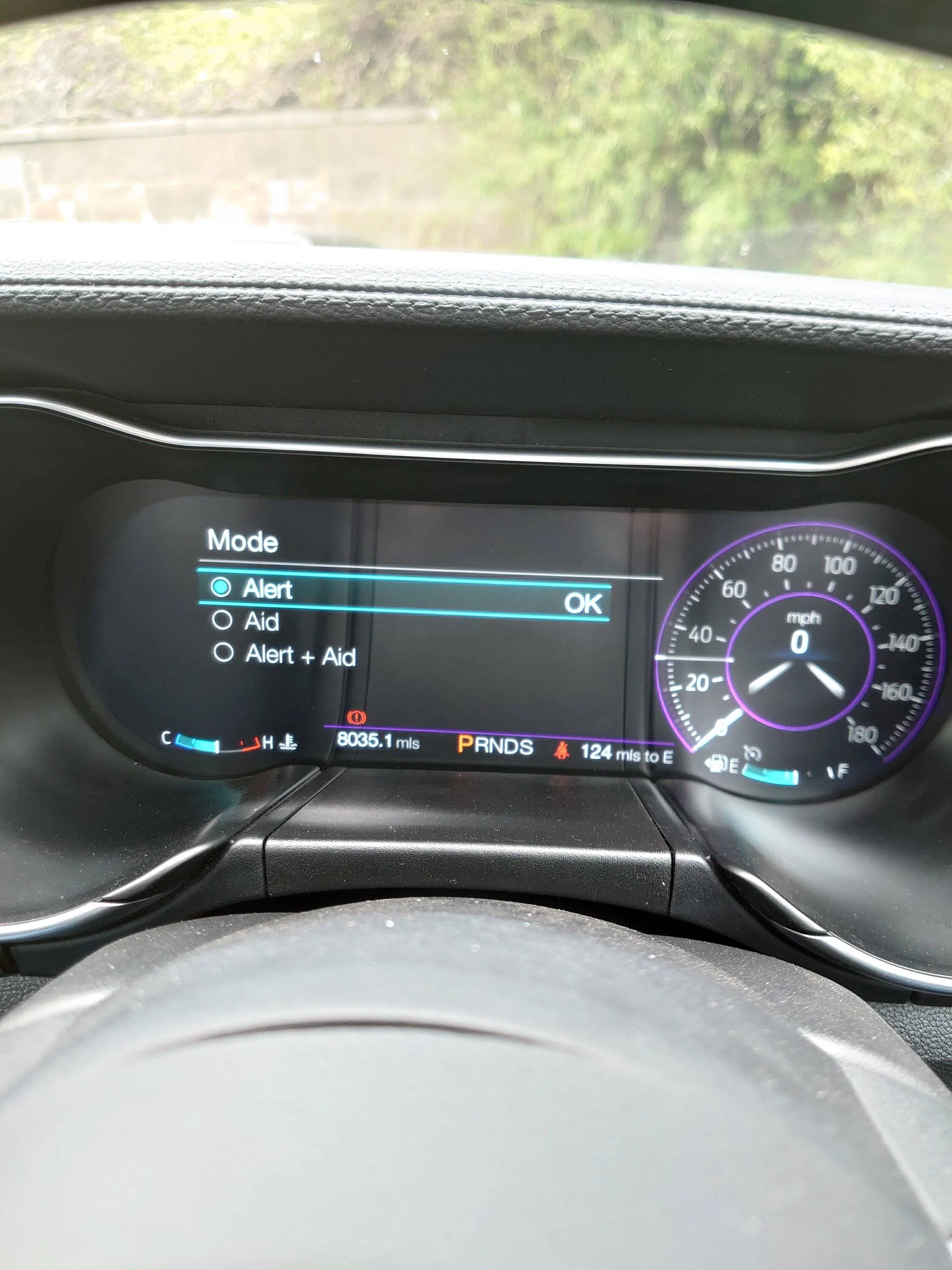

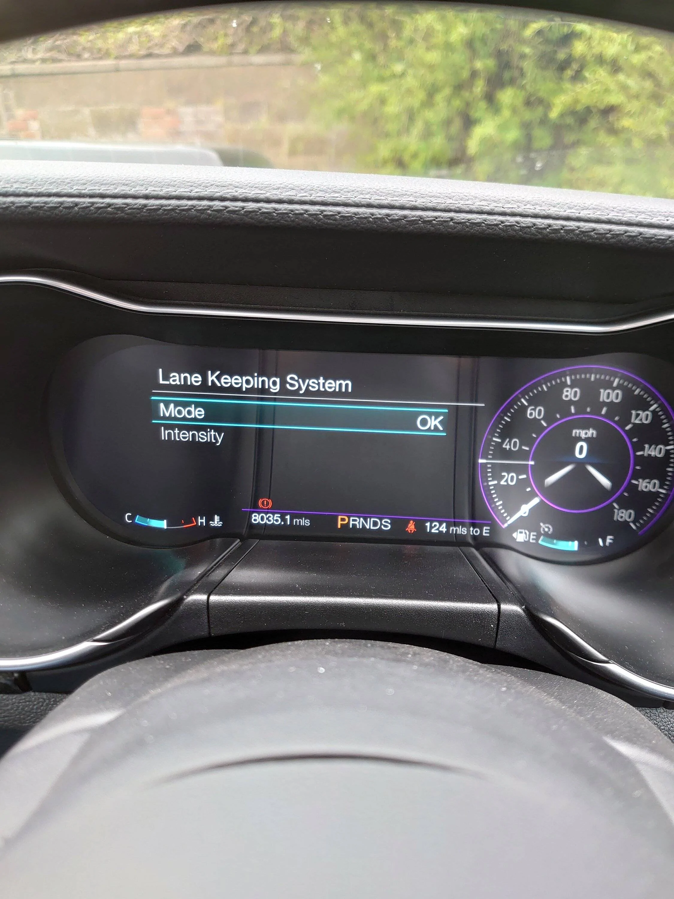

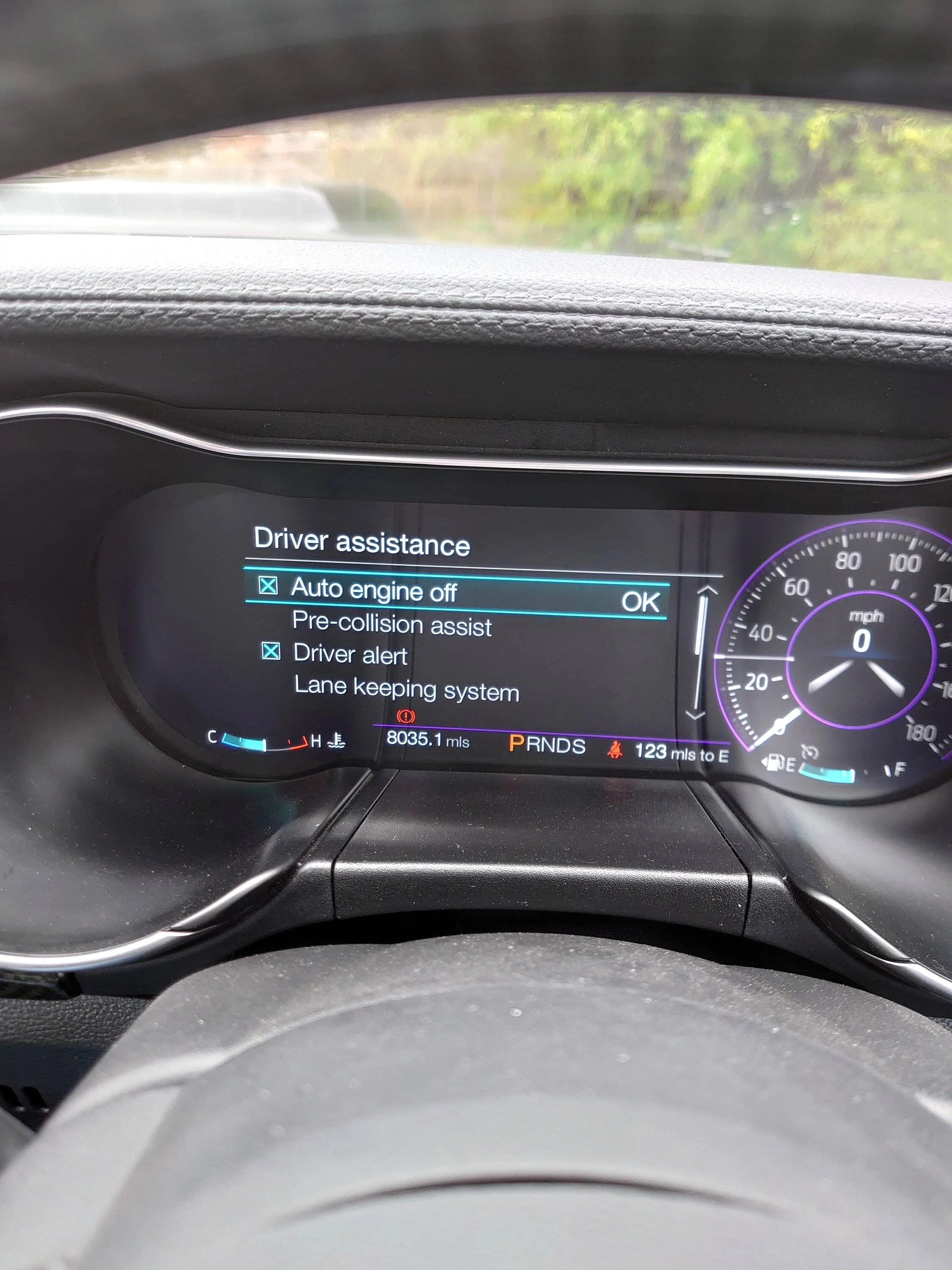

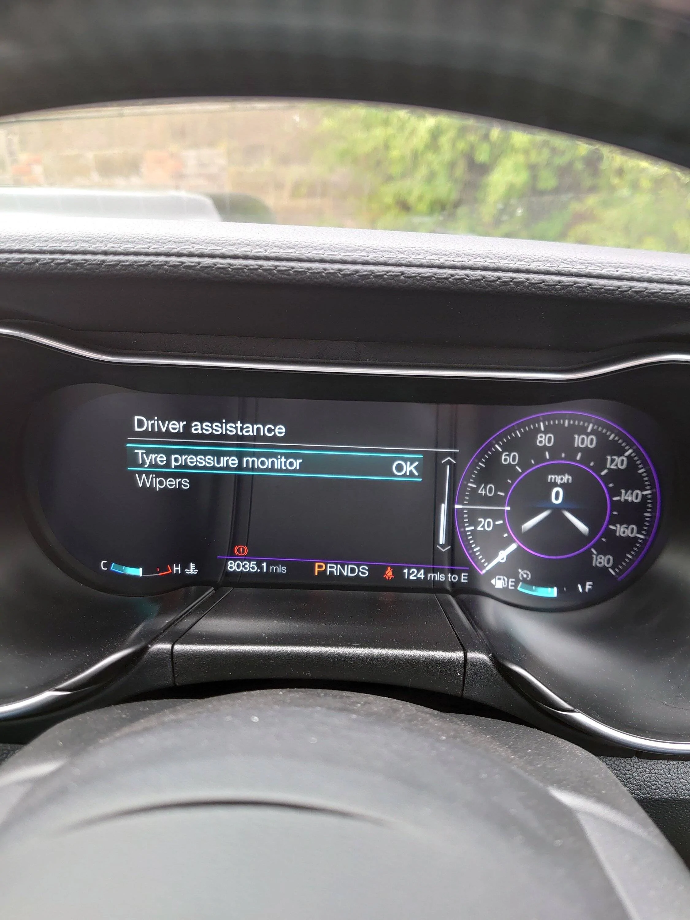

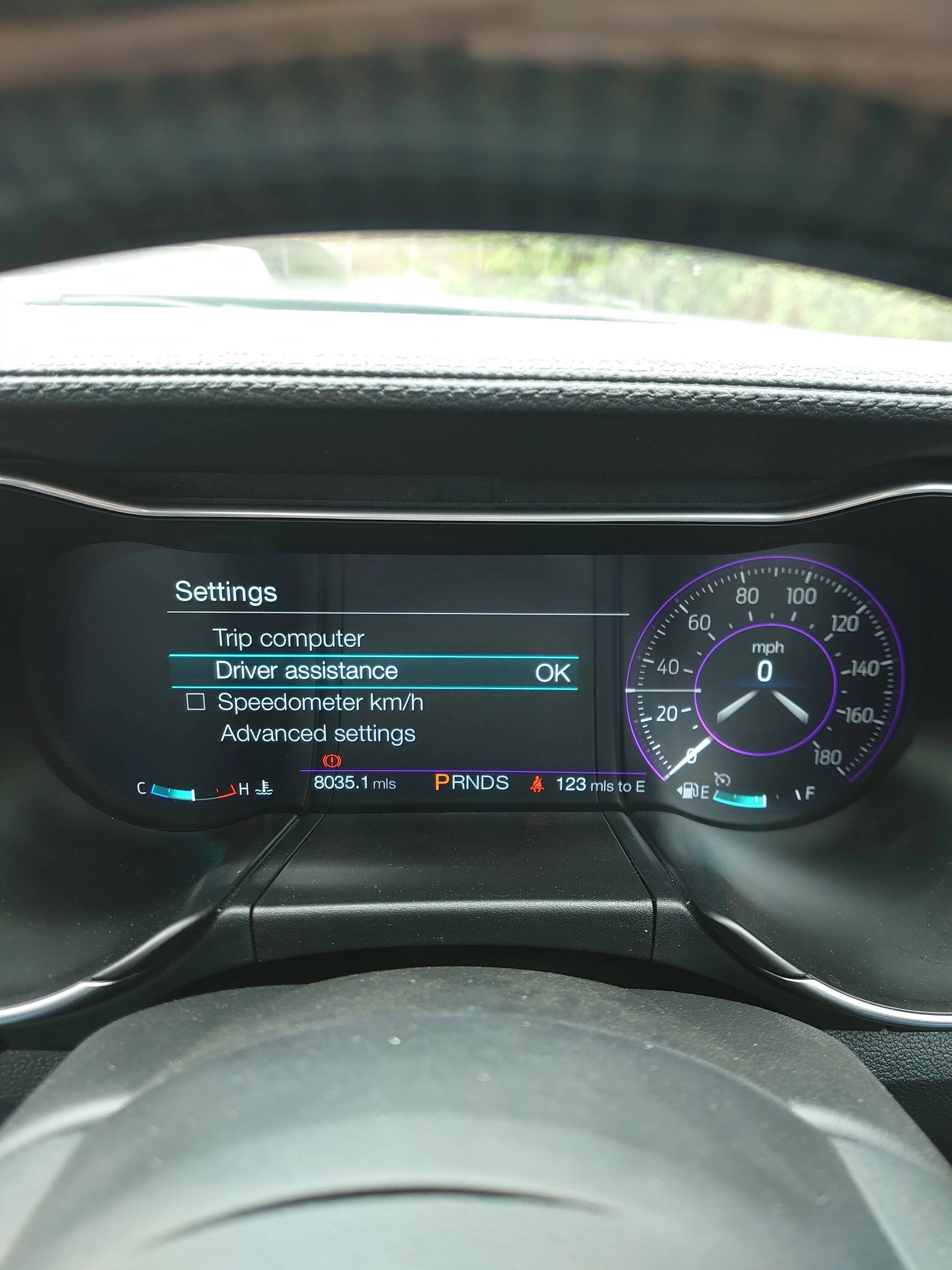

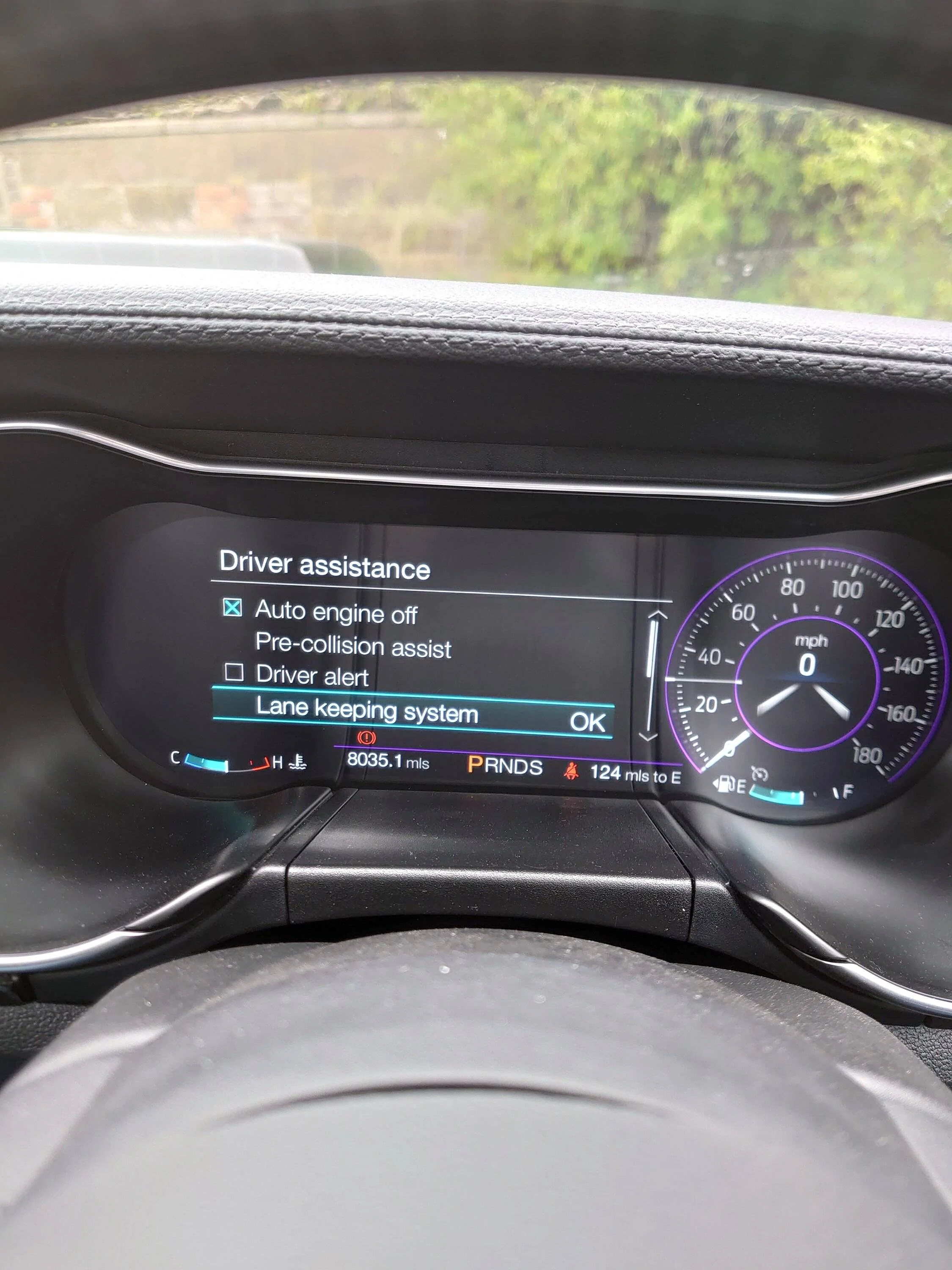

So, without doing anything as far as I know, my Lane Assist has switched on a couple of days ago. I normally had it switched off and it stayed off. However, now when I go into the menus, it seems like the only way to shut it off is to also turn off Pre-Collision, Tyre Pressure Monitor, etc. I have yet to try Greg's advice above, but I thought I could just switch off Lane Assist without turning everything else off?

I bet you have inadvertently caught the button on the end of the stalk :like:

Thanks guys, I'll try just using the stalk tomorrow.
