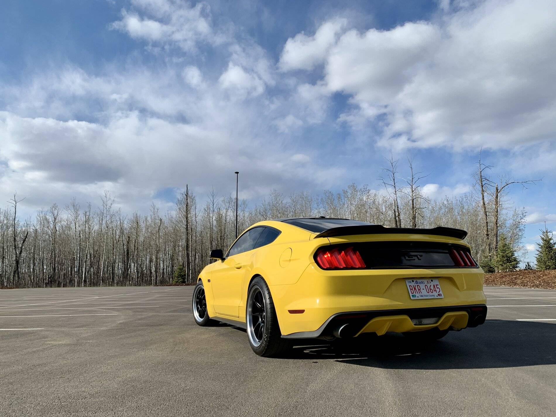

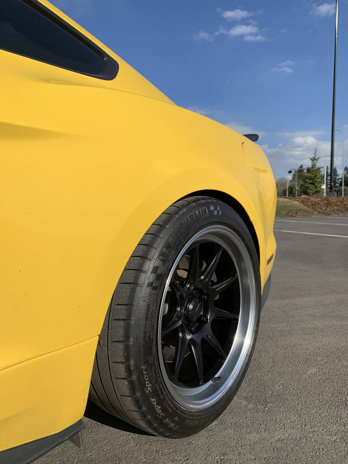

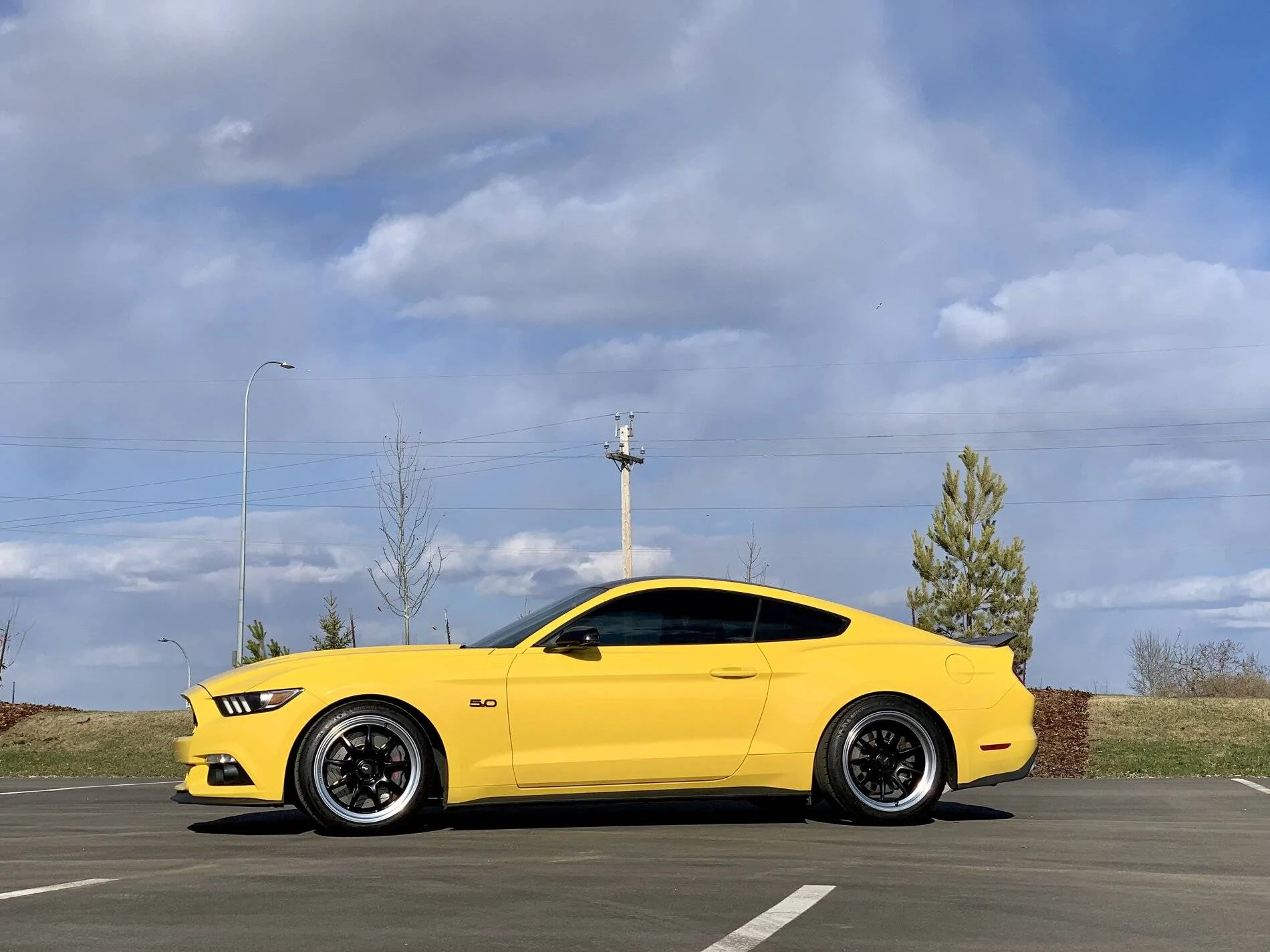

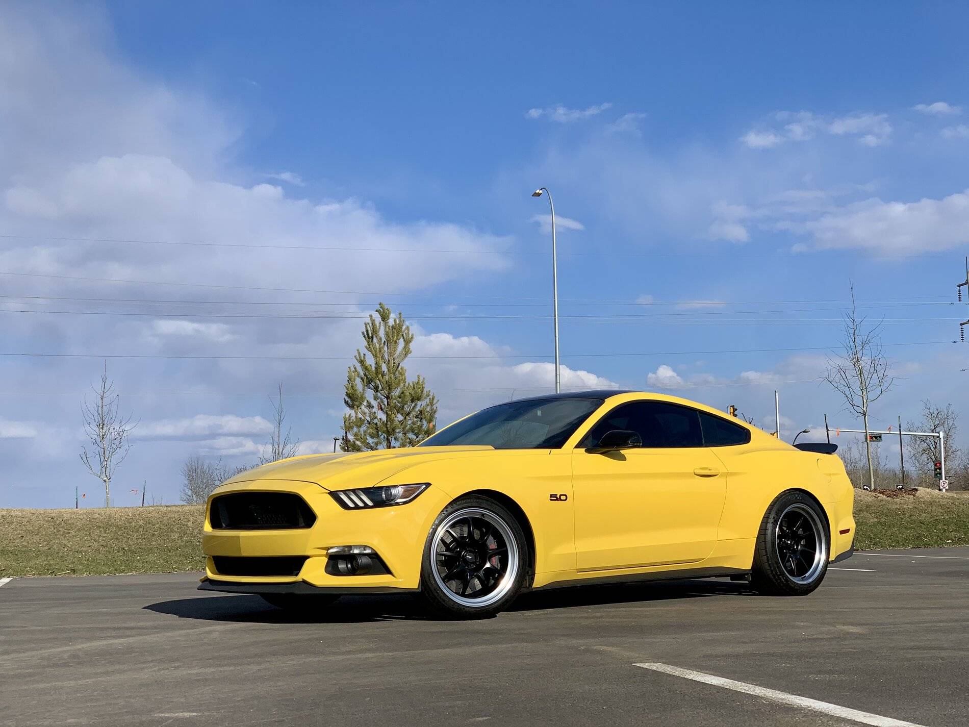

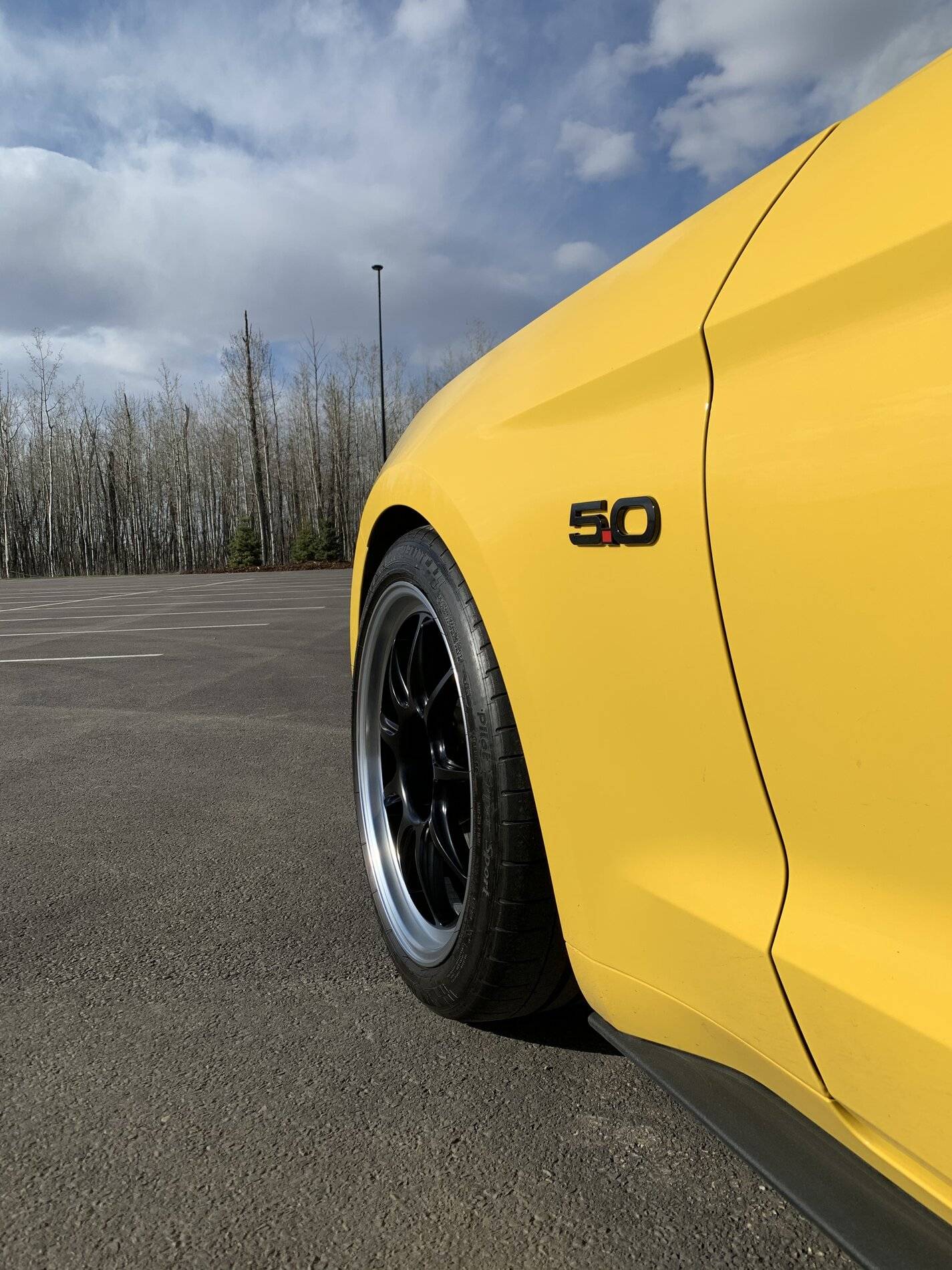

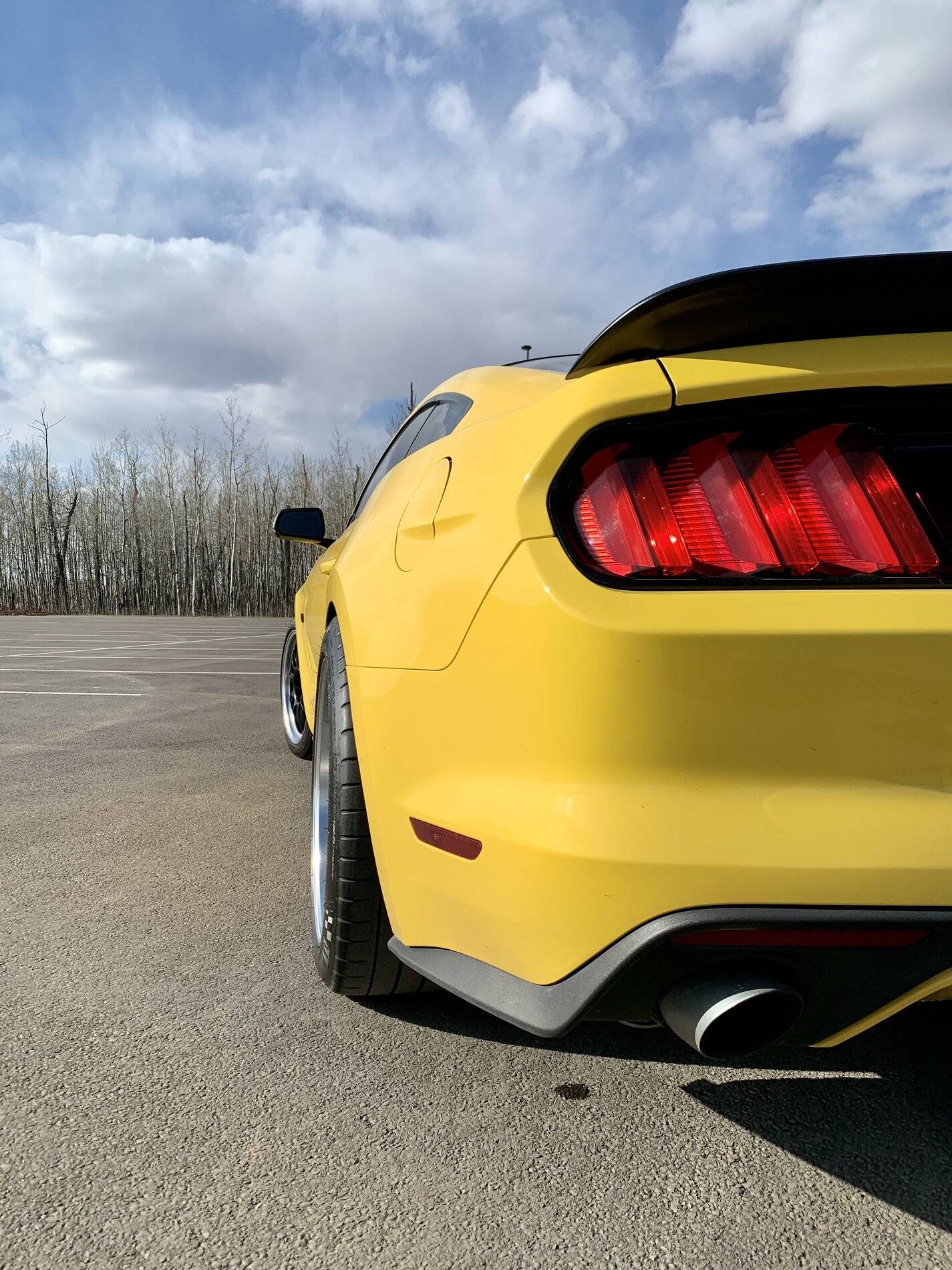

Hey everyone, had these mounted to my MPSS tires the other week and thought I’d share. Open to feedback of all kinds. Curious what other owners think of a tuner style wheel on our chassis.
19x9.5” +25 (A face for caliper clearance)—
255/40/19 front
19x10” +25 — (B face for concave)
275/40/19 rear
25-26lbs each flow formed
All matte finish
will be painting the rotors and rear calipers black so they don’t look so crap after all these winters

Didn‘t try it but I don’t think it would clear based on how it sits at the back. The fitment is thankfully spot on. I need to recheck my alignment though to make sure it’s still dialed in how I want it (Not because of the wheels). I’ve noticed more camber in the rear passenger than rear driver. I think it’s -1.8L and -2R.
I also wanted to be able to reuse my current tires on these wheels for costs purposes this season. 255 would be a bit of a stretch on 10” haha

I think the style looks good. I don't care for the poke in the rear.

Preciate it. So that’s what I want to sort out with an alignment check because the passenger side doesn’t poke like that. It’s more flush and tucks better.
I’m hoping my cradle isn’t misaligned.
This is the alignment report from September 2019 after I installed the new springs and dampers I gave toe specs according to BMR’s street recommendation; he wasn’t able to get the side to side camber adjusted though because I didn’t install adjustable parts.
I have bad roads where I live so it’s entirely possible the alignment is off.

They look nice and the fitment looks good. My only minor complaint is that the wheel design with the lip makes them look small compared to a full face design.

I've had the same wheels on 2 different Mustangs and noticed a difference in rear fitment on both. One side pretty much flush and the other inset a slight amount. (+33 offset.) With the first car I wondered if the cradle was misaligned, but when I saw it on the second car I figured it might just be Ford quality. :) You have less margin for error with +25 offset.

Thanks! That’s totally fair. I know our cars look awesome with 20 inch full length spoke wheel.
My goal was to get a flow formed wheel for strength and lighter weight, as well as not to have an all black wheel. I like the idea of a silver lip so I found these with black spokes and pulled the trigger. It’s a very early 2000s look from when I was in high school.
