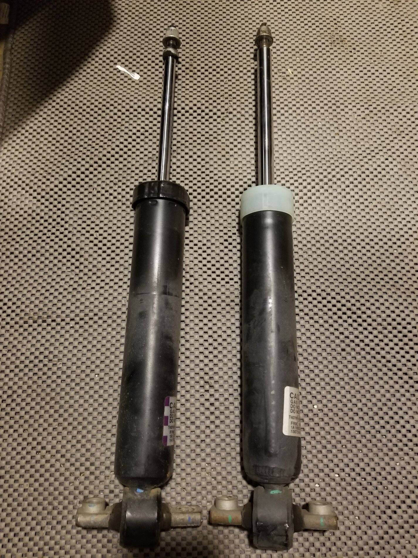

I installed the rear Koni str.t and the ride is much improved over the stock Ecoboost PP rear shocks. The rear has also dropped about 1/4 of an inch after the install.
One interesting sidenote, I purchased a used set of base GT rear shocks for the hardware and noticed the base GT rear shocks have a thicker rod compared to the Eco PP shocks and would be a nice upgrade for any Eco.
I also used the base GT jounce bumpers because the Eco PP jounce bumpers have cracks.
