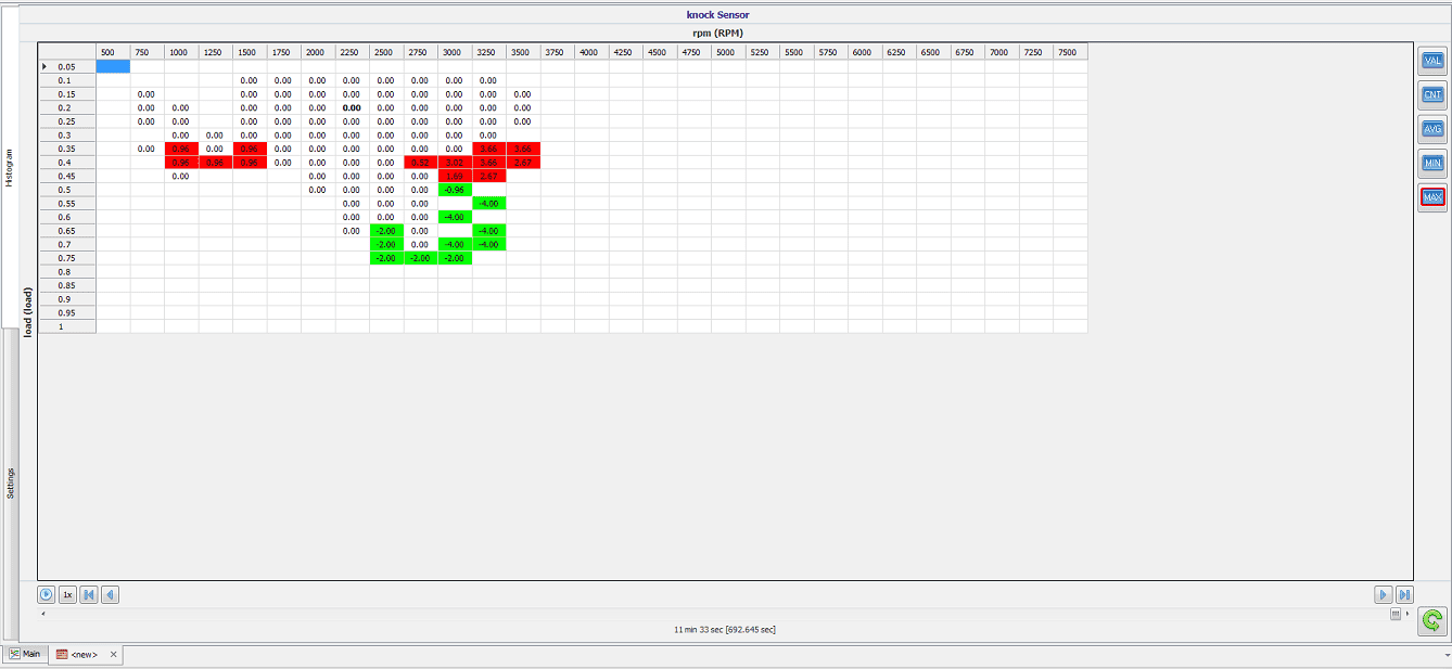

Your knock is more localized and consistent in a little bit different area and higher values, but rich on tipin is the same. My guess on yours is exhaust cam angles are to advanced. I would have expected to see 40*+ not a max of 20-22*. You are probably unintentionally lugging the engine from the shortened power stroke at those loads. That or you are getting low octane gas. Do you have knock at WOT?
stevnoof1
Oct 11, 2017
108
mustang
I use shells 93 vpower 90% of the time Valero 93 every now and then. Never had knock doing a wot pull. But I do have a problem with hard shifts setting the sensors off more often than I feel comfortably with. Normally it doesn't get up to 3* at part throttle but I was trying to make a point of letting it go longer I usually shift earlier. But it really only happens in 1st and second gear and as you can see it happens often. That is like 5mb of a 30mb log I couldn't upload, there was several more events just not as high. The car was also not fully warmed up at this point in the log. It's Definitely a pita.

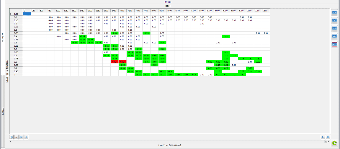

LTFT and STFT are fine. There was a very very small positive knock event (start of second pull). To look at transient fuel, You would need to log MAP and lambse. Lambse would tell you if those rich tip ins are commanded or not.
