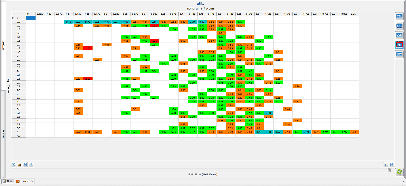

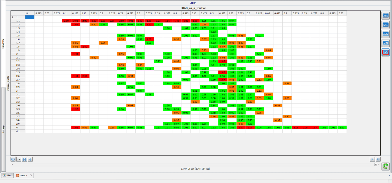

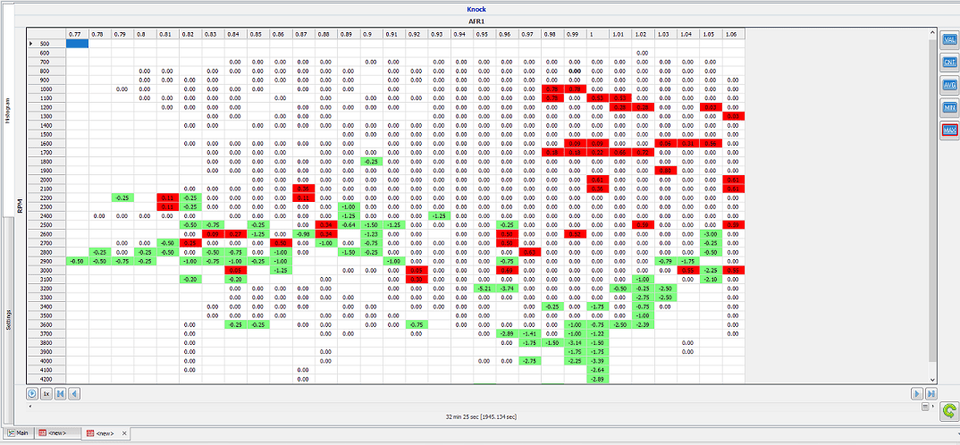

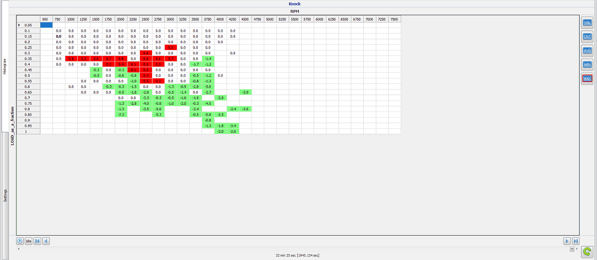

I had to download your .csv and put it in to SC livelink to make a couple histograms.
Doesn't seem to be related to AFR. just low RPM and load.

Nothing looks obviously out of whack. The amount of small events you have is strange, but they are very small.
The only correlation I can find is low rpm and low load and over 95% of the positive events are when the IMRC are closed or just about closed. I cant look at the slope value like in HPT, so I cant determine in which direction the IMRC are going when the events happen. My guess is when they open or close the knock sensors are picking the noise up as a very small knock event. Unfortunately HPT doesnt have much advanced functionality when looking at .CSV files not created by their scanner.

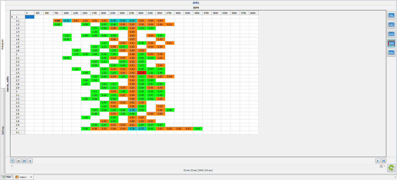

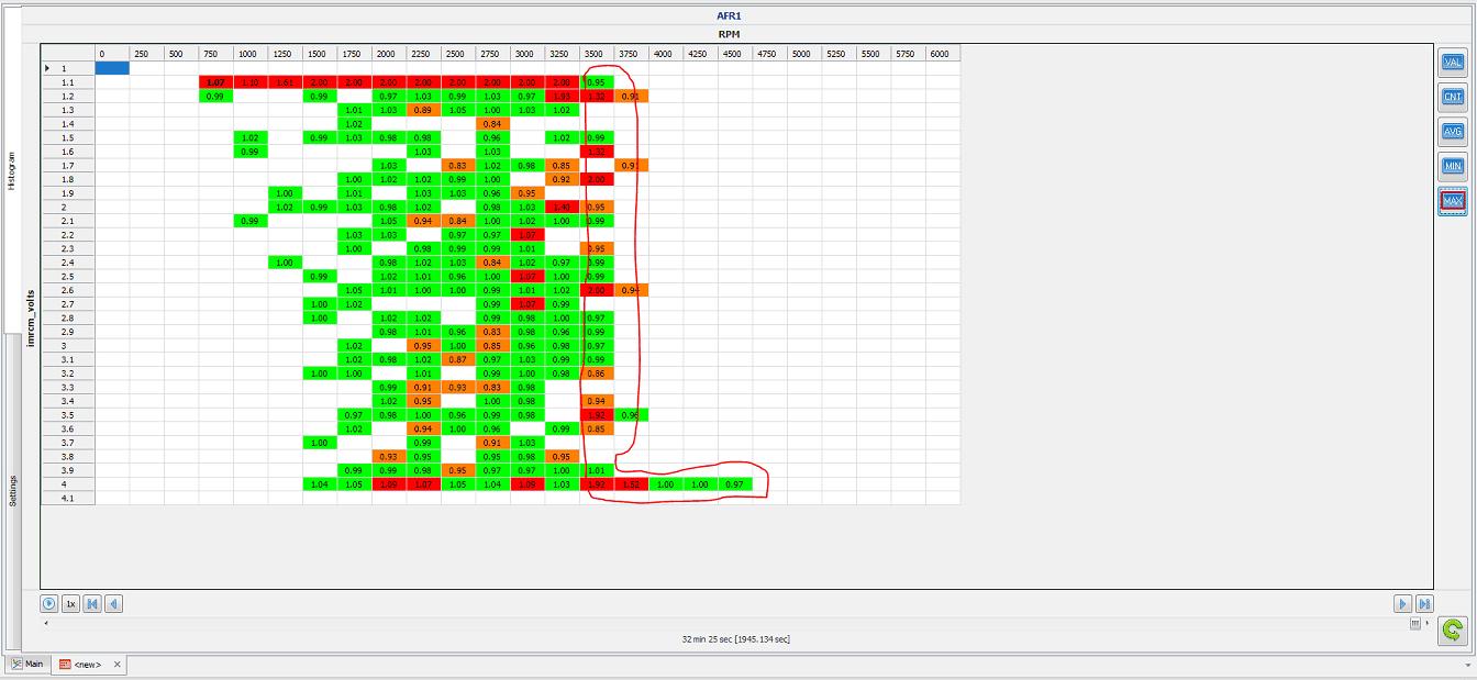

Yes any rapid change in airflow whether when opening or closing the throttle(transient) needs to be accounted for in an open loop. Waiting for the mixture to get to the sensors and give you closed loop feed back would take to long and fuel corrections wouldnt be applied quick enough. Now if your CMCV plates are reacting slowly cause they are sludged up or the solenoids are not operating as quick as they should, then yes this open loop transient could be adding too much fuel as the expected increase in airflow is not actually as high as it should be.
I tried comparing your AFR with IMRC voltage and load, also with RPM. We know its rich on tipin so when looking at min values its going to mostly show tipin. When looking at max values it will show 2 as thats what it goes to in DFCO. It doesnt seem to go to DFCO when they are open, and it should above 3000 RPMS on decel. Theres also an interesting rich line at 2750 but at no other RPMs.

Thanks for putting in the work to put this stuff into tables but this is getting way over my head very quickly. Is it not normal to go rich on tipin like I'm seeing? I don't think it's a tune issue as the stock tune reacts this way too.
