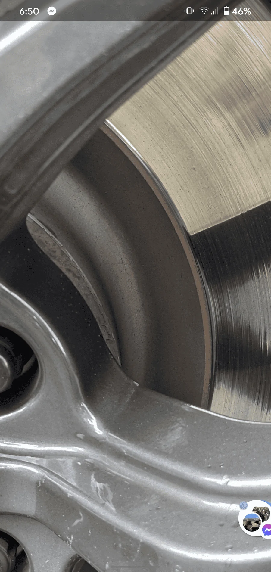

FWIW, Centric rotors come e-coated, and it seems to hold up quite well. Not just the hats, but the whole rotor. Obviously, it wears off of the braking surface, but it stays on the hats and vanes. The entire rotor stays better looking longer. If you did the same thing with a high temp paint you'd get a similar result. Just make sure that you don't build up a thick layer.

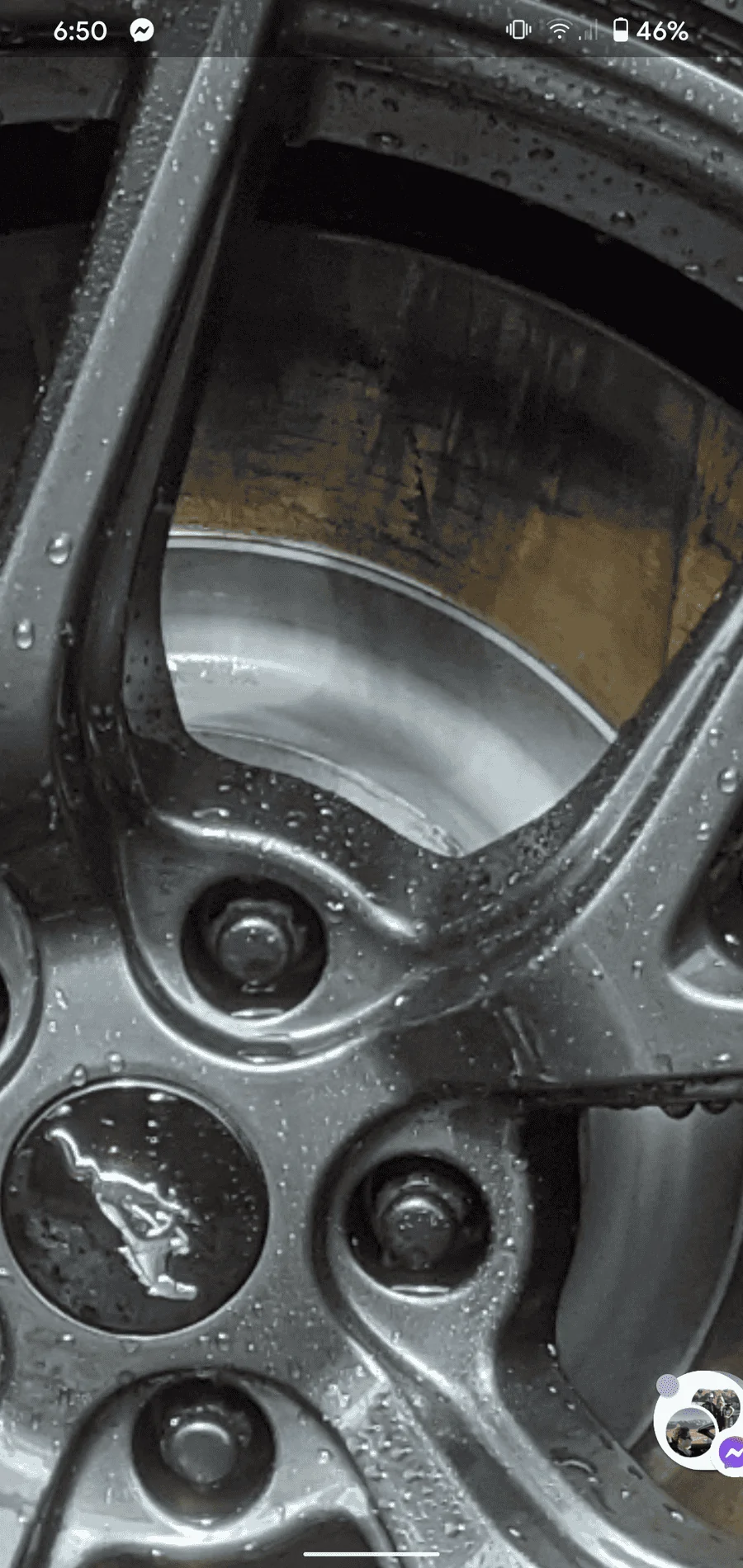

I used Adams wheel cleaner and was surprised at the difference it made. I used a small bores hair brush to agitate the cleaner on the rotor hat.
My rotors had 4 seasons of driving and multiple track days on them so they were pretty bad but factory wheels hid this well.
