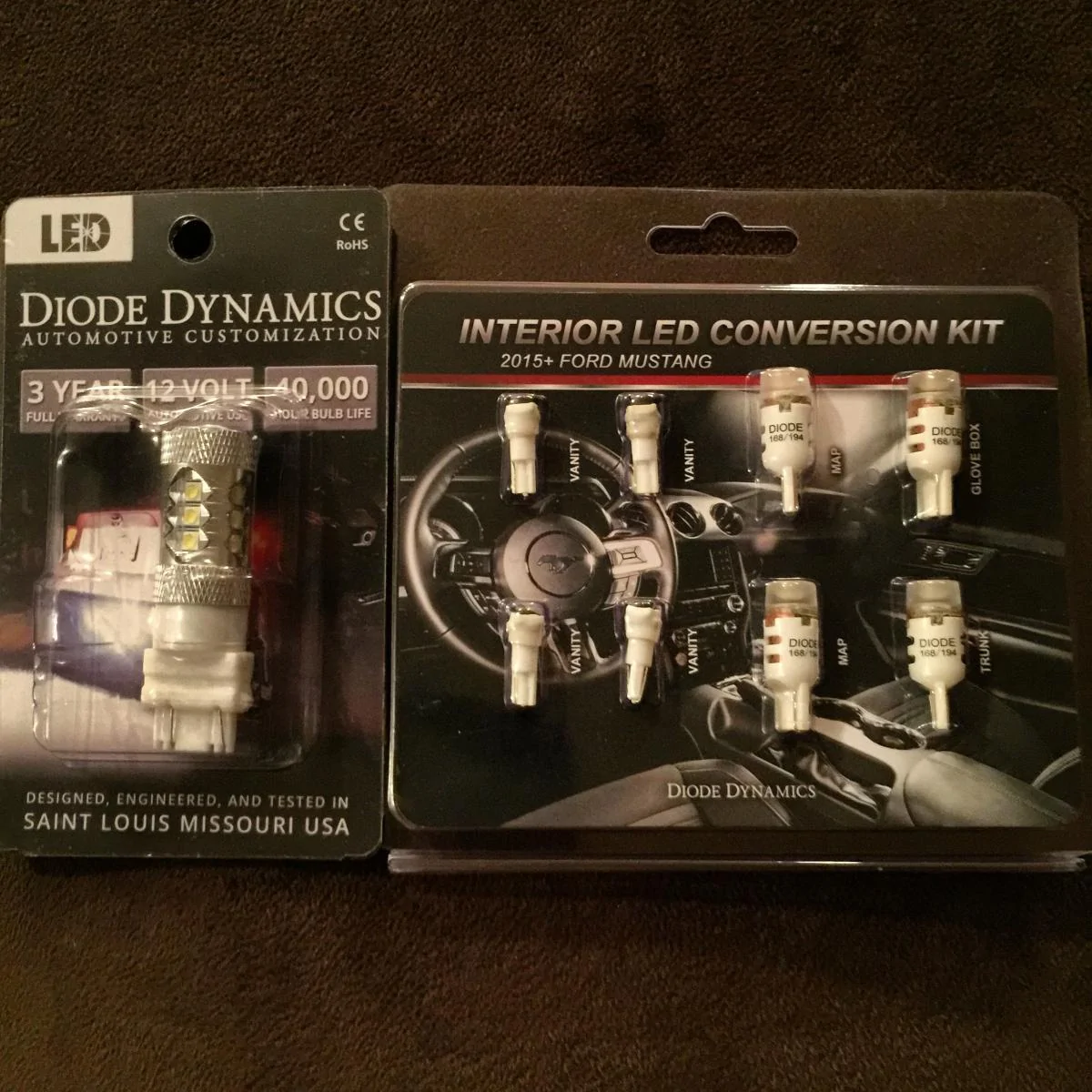

Installed my stage 2 interior kit today with no problems. The trickiest one was the glove box. Someone on the forum suggested disconnecting the entire bulb housing from the glove box to make it easier. That's what I did and it was much better than trying to pull the bulb out by itself. Also, someone else suggested using a plastic pen cap to pop out the bulb instead of a screwdriver to avoid blowing the fuse. I did that too and it worked like a charm. Actually, I used the pen cap for all of the bulbs. Didn't use the screwdriver at all.
