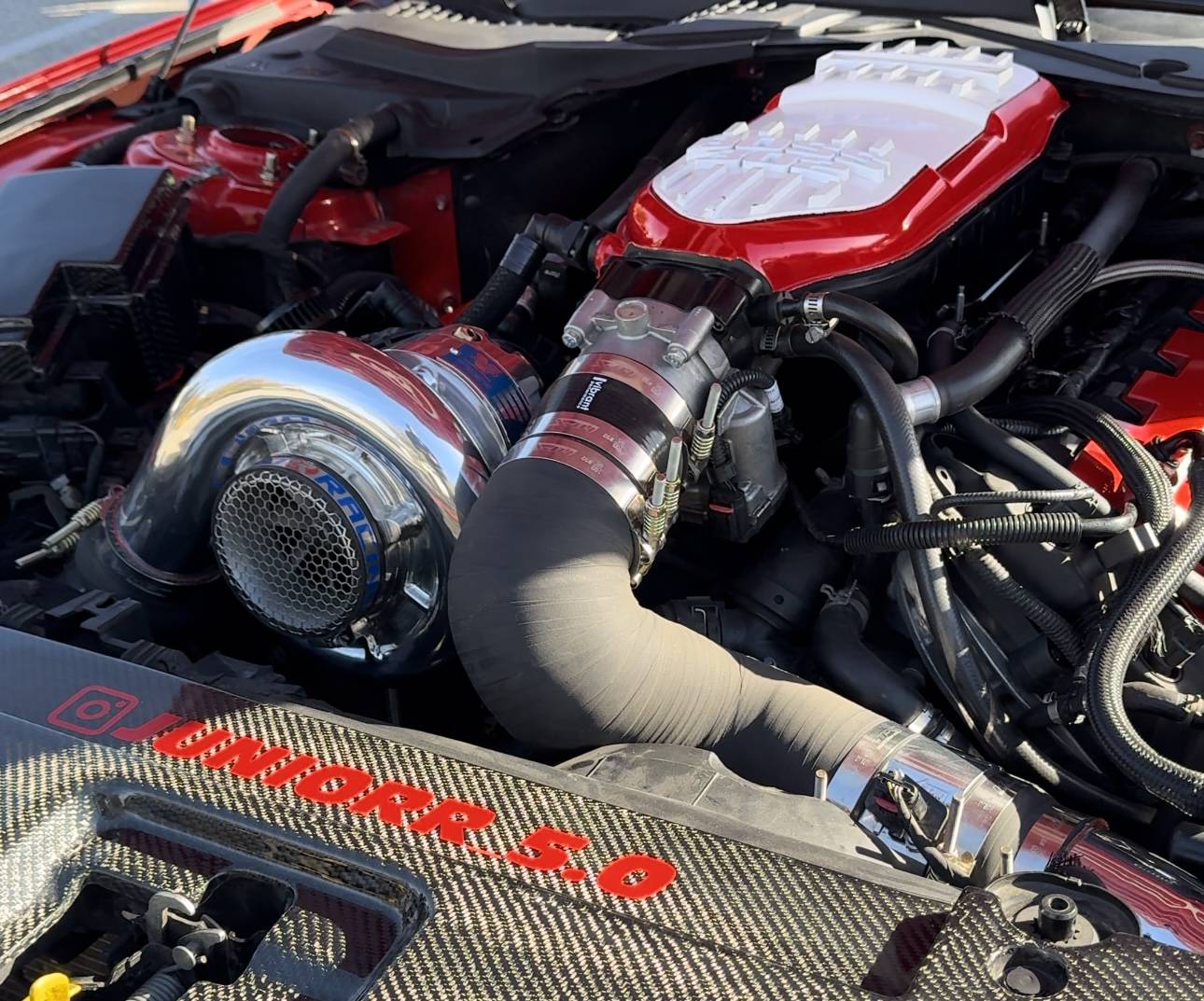

Hey this is Junior from N4SM, The hose clamps that come with the kit don't hold boost very well. I swapped mine out for some HPS spring loaded clamps. Haven't popped off a hose since.

thank you! I’ve read quite a few threads about this occurring. Is there a kit that supplies all of the necessary clamps or do I have to purchase all individually?
