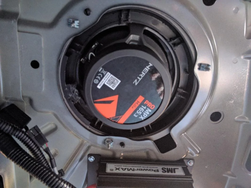

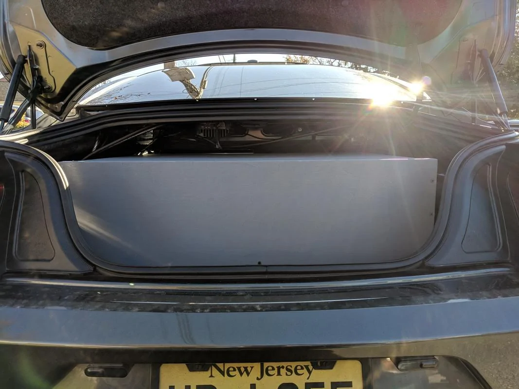

Not great pics but here is where I mounted mine. nice and out of the way on the bottom of the rear shelf in the trunk. And you can feed the wires through the trough with holes in it right behind it.
It's not something that needs to be adjusted often. Typically boost 100% to 18V at 50% throttle.
