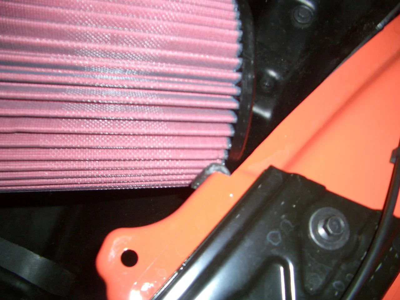

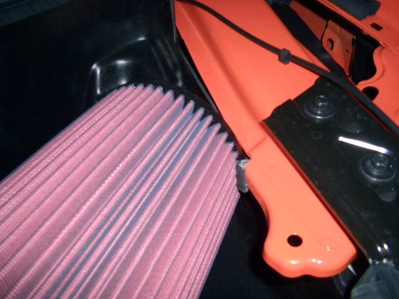

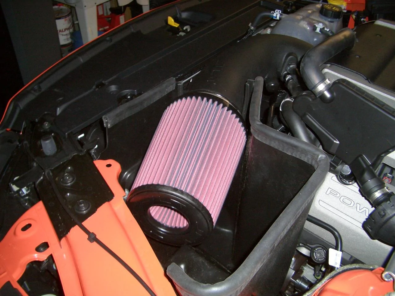

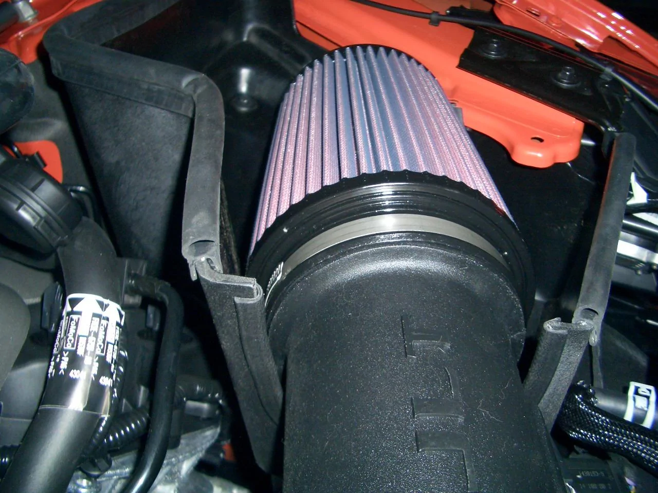

Anyone with this intake, did you run into the filter being shoved into the metal brace on the drivers side of the engine compartment?
Mine has the filter element wedged hard up against a sharp corner, and will be tearing through soon with engine movement. I cut a piece of rubber hose to shield it, but there is nothing to hold it in place.
Only way I can see to fix it is either beating down or sawing off the metal (hell no), or grinding the JLT intake box where the intake tube comes in, relieving it on the rear edge to let the tube and filter tilt slightly further in.
