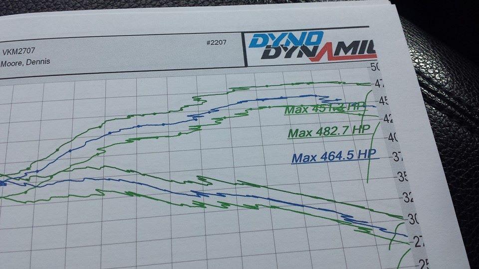

Vinny was the car protuned with the custom tune, BEFORE the dyno session???
First we made some baseline pulls on the car, completely stock no tune. That's the 451whp run which was the best of the baseline pulls.
Then we had Brent from DTP Tune the car on the stock airbox, best run on that was 464.5 with the tune.
Then we installed the intake system and tuned the vehicle from there. Best run was the 484 and was backed up with the 482.7 run pictured in the graph attached.
Tune only numbers we're right in line with what Lund racing posted in their car. There isn't a ton left in these car's from Ford, the stock tune is pretty aggressive already.
On Sunday we're going to try to get a cleaner RPM pickup so the graph is not as ugly, we'll also get some pictures of the inside of the stock tube to show some difference with what we've improved on.

Dyno dynamics typically read lower than Dynojet which seems to be almost a standard, seen some read up to 18% lower than a Dynojet
Incredible gains though from just I/T, sign me up for the package when you guys release it!

This dyno doesn't read much off of another dynojet in our area. A stock manual trans 15 GT typically makes low 380's on this dyno, which is right in line with most on 93 octane.
Results may vary as always with dyno's but gains are gains!

I know it would have taken twice as long (twice the $), but how do you know the CAI did anything as opposed to just trying a tune first?
We did,
Tune picked up 13 and the JLT another 18 :cheers:
