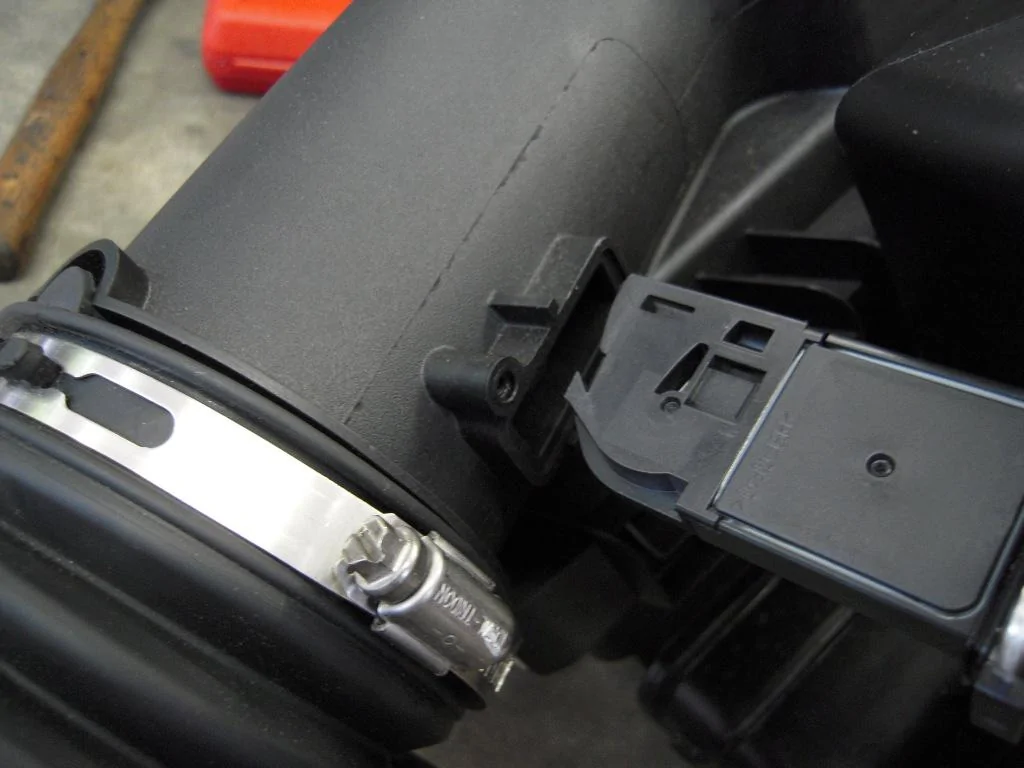

Interesting thread. When I did my JLT intake last week I noticed that the MAF had a small ridge around the base such that it didn't really seat totally flat against the mounting face of the intake tube.
See in the pic of the stock air tube that there's a ridge into which the MAF lip sits into? The JLT doesn't have this ridge, so the MAF doesn't sit nice and flat. I assumed it was meant to be this way, hence the rubber gasket.
My mustang idles and runs fine, but if it did start having issues, this is the first place I'd look.
