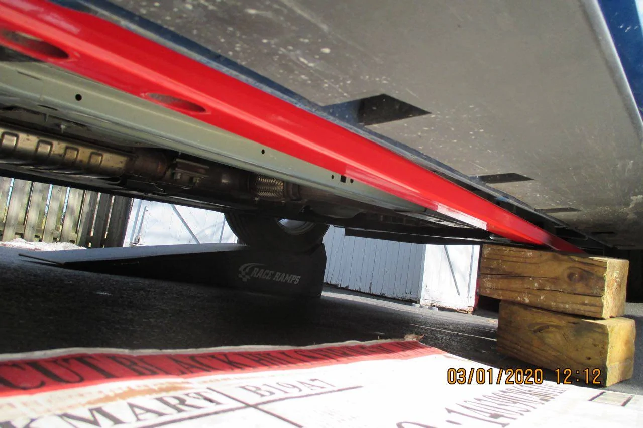

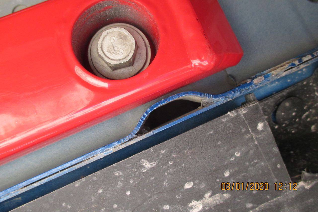

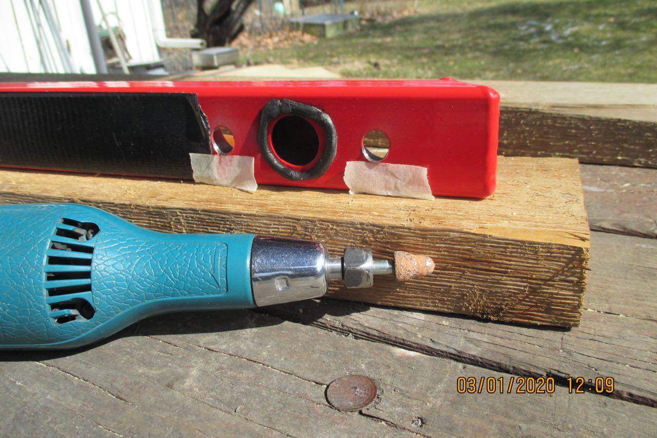

I'm not Houdini so I used ramps and blocks. Good thing because the protruding rear rocker drain caused a mis-aligned bolt hole, causing a cross threaded bolt, causing me to have to hog out the bolt holes. Also, I don't know what the large hole is in the rails except to fill up with dirt and water, so I sealed it off. Otherwise real happy with the quality of the BMR rails.
