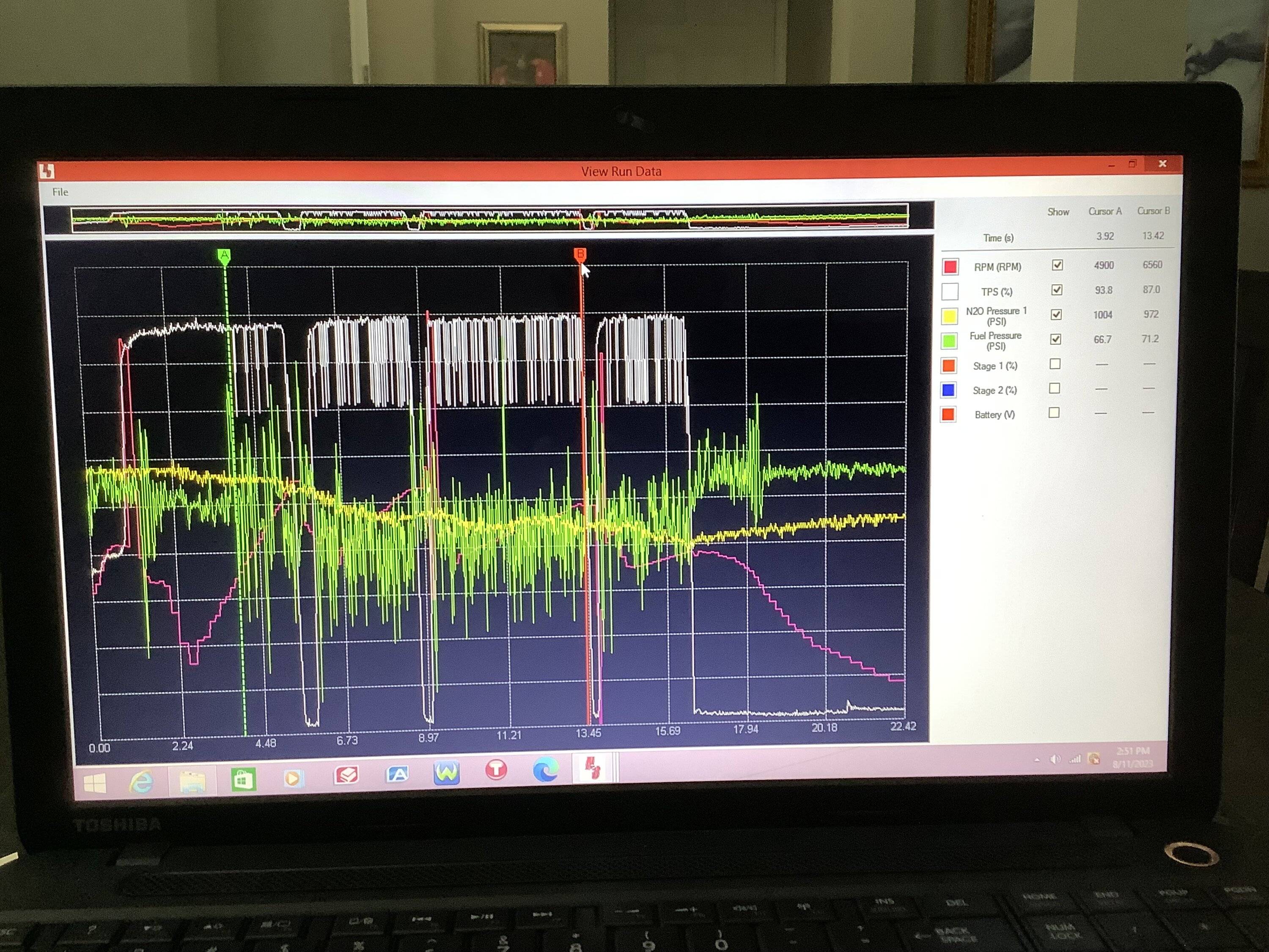

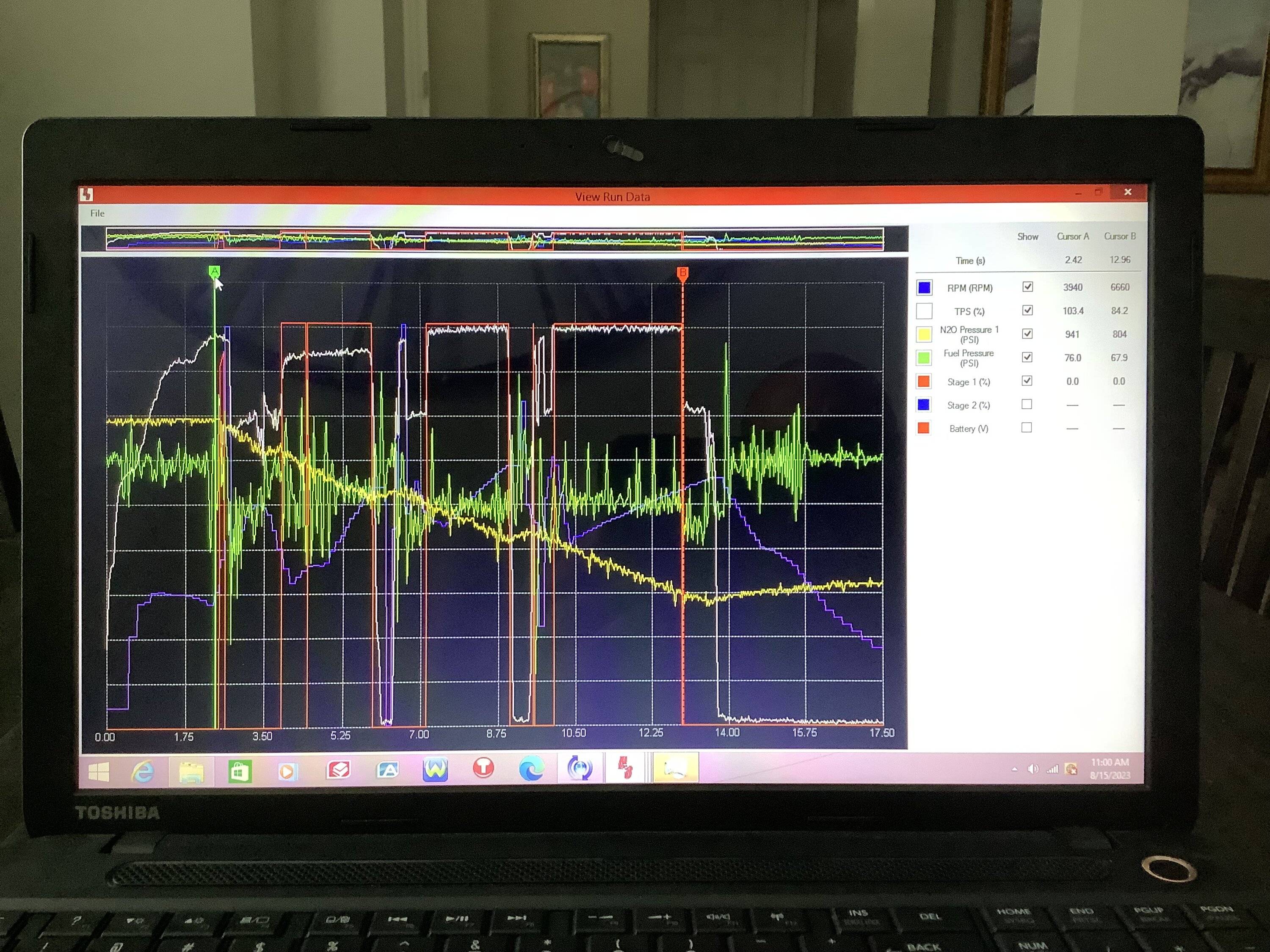

I’ve been to the track a few times this summer. While I had been focused on making NA passes only (have ran several 12.30 passes), I decided to spray the car just to make sure that my ProMax nitrous controller was programmed correctly and ready to go. Well, I made two passes last week and on the first pass, the ProMax did it’s job and didn’t allow the car to spray because of the high and low fuel pressure fuel parameters that I had programmed into it (77 psi low limit and 88 psi high limit). The fuel pressure fluctuated dropping below and climbing above those set parameters. In addition, the bottle pressure was above it’s set parameter of 950 psi, so that also prevented the solenoids from firing. I was trying to get it purged down as I approached the staging beams, but the pressure continued to climb because the heater was still on. Either way, it still wouldn’t have sprayed because all safety parameters weren’t being met.
The second pass was similar to the first one, although the nitrous did fire intermittently because, but very briefly because the programmed fuel and bottle pressure parameters still weren’t being met consistently.
I did manage to data log both runs and have been studying them ever since last week. Here are some screenshots of those logs. If you look at the numbers to the left of the graph, you’ll see why the nitrous didn’t spray.

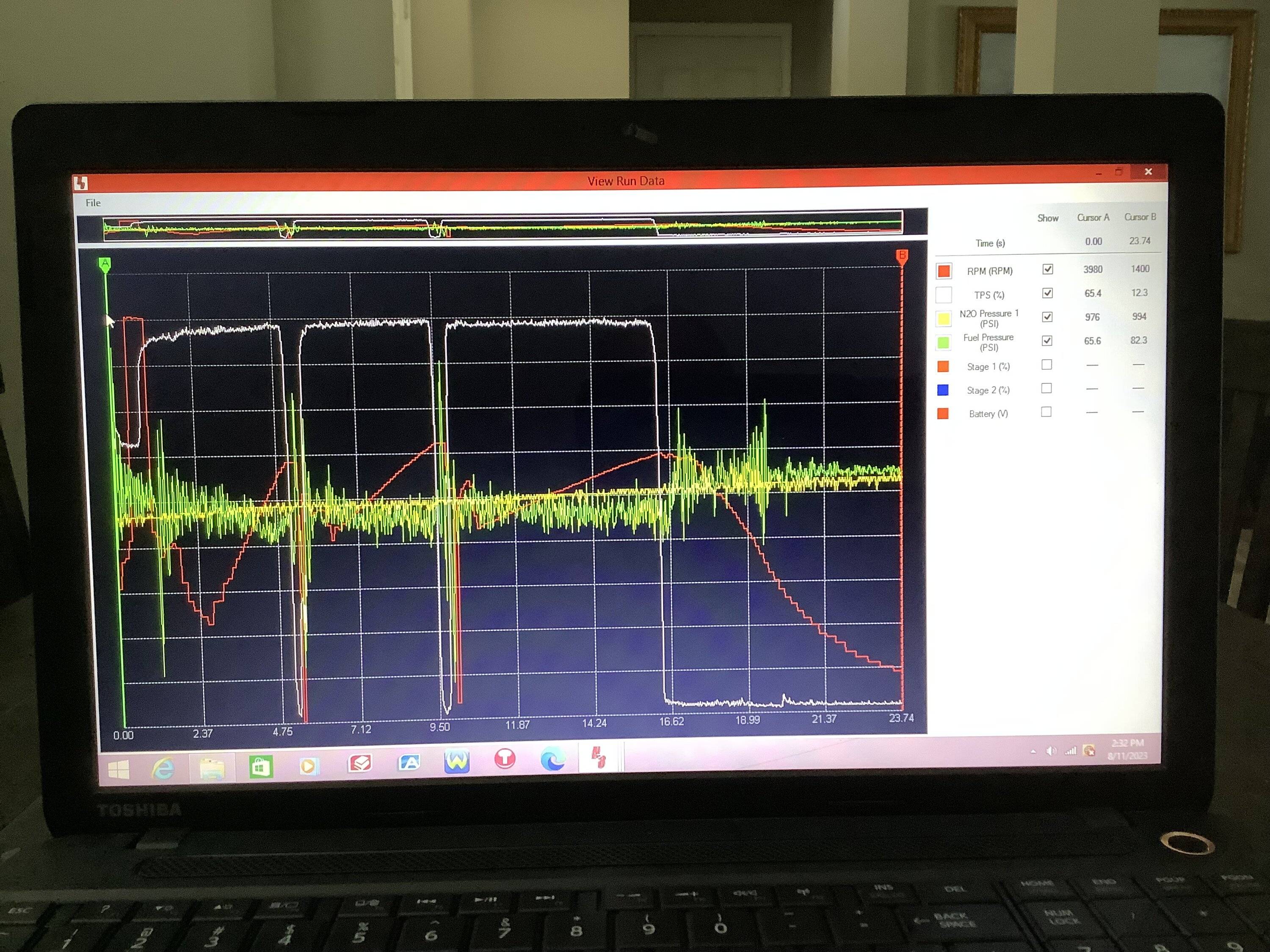

Yesterday I spent some time reconfiguring the ProMax (reset low/high limit fuel pressures) and took the car out for a quick test hit on an isolated road and it worked just as it should have. Here’s a screenshot of that data log. Notice the orange tracer (which is showing that nitrous was spraying in gears 1-3). I’m planning on going back to the track tomorrow and see if I can make a clean nitrous pass, so stay tuned.
