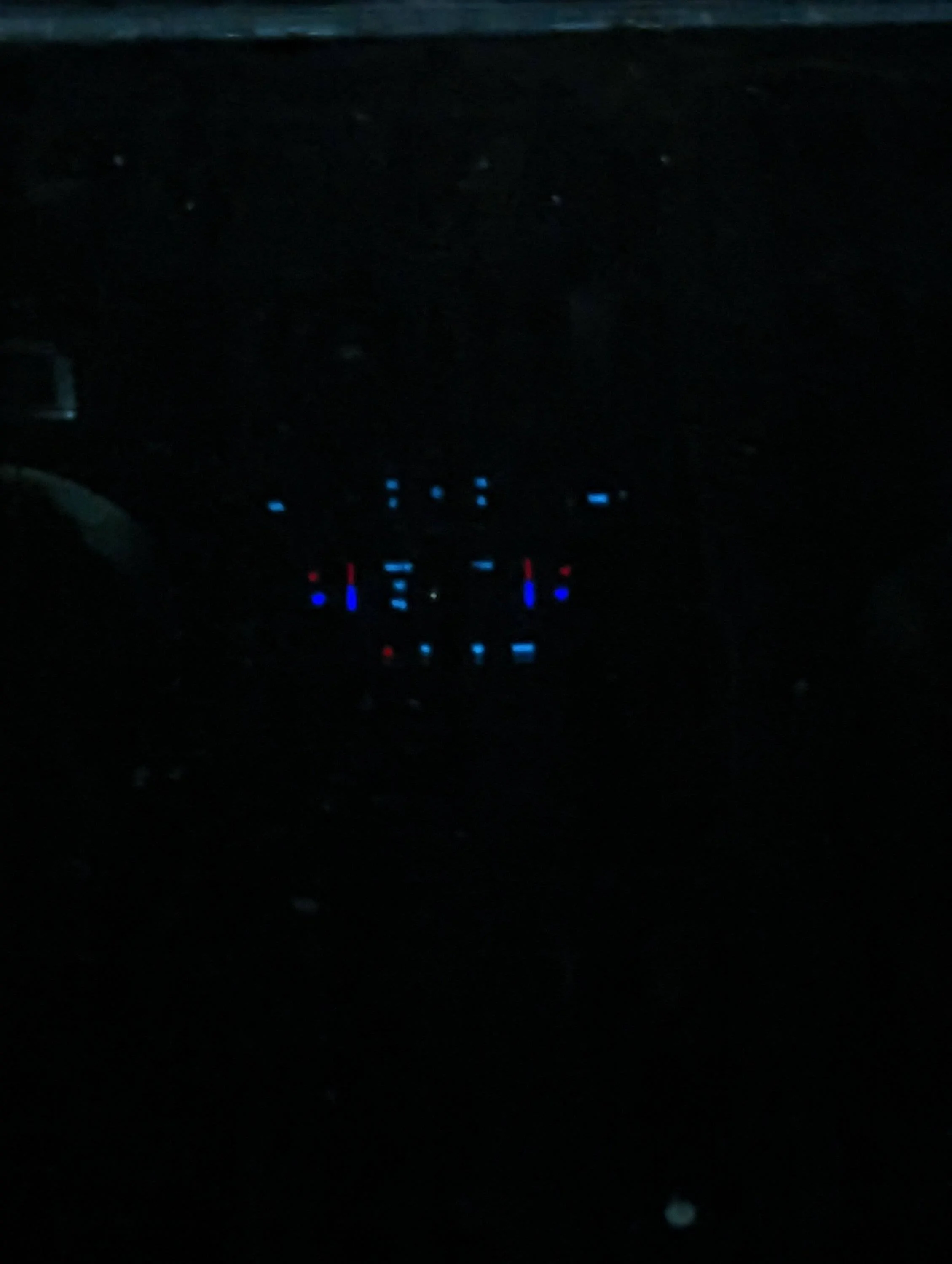

The lights that signify climate control settings, driving toggles, etc., remain ON after I turn off my car, get out, and close the door.
Image below taken through the rear window.
Along with this, I get "System Off to Save Battery" showing up on my SYNC display. Here is a video of me trying to turn it on and off again:
I have went ahead and pulled my dashcam wiring in case it played any role, but results are the same. Set the headlights to the "OFF" position. Nada. Nothing else is on at all. I have no other electronics plugged in. I have aftermarket tail lights (1+ year), and aftermarket switchback turn signals (3+ years), but they've never had issues before.
Daily drive 30 miles (15 from home, 15 from work)--dashcam usually remains powered the whole time.
Would love any help.

Managed to solve or mitigate the issue... Took the car out for a short drive around the block, then parked & it stopped. Will need to check in with a mechanic eventually to see what could have caused it.
Main reason for that low battery warning, was due to the lights staying on for quite a considerable amount of time. But that low voltage cutoff never happened for some reason, despite the countdown.
