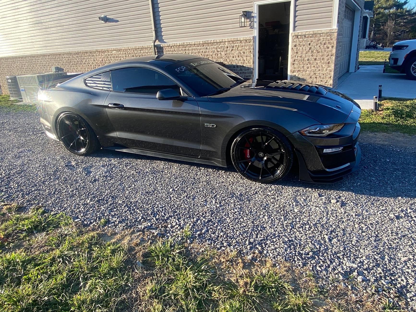

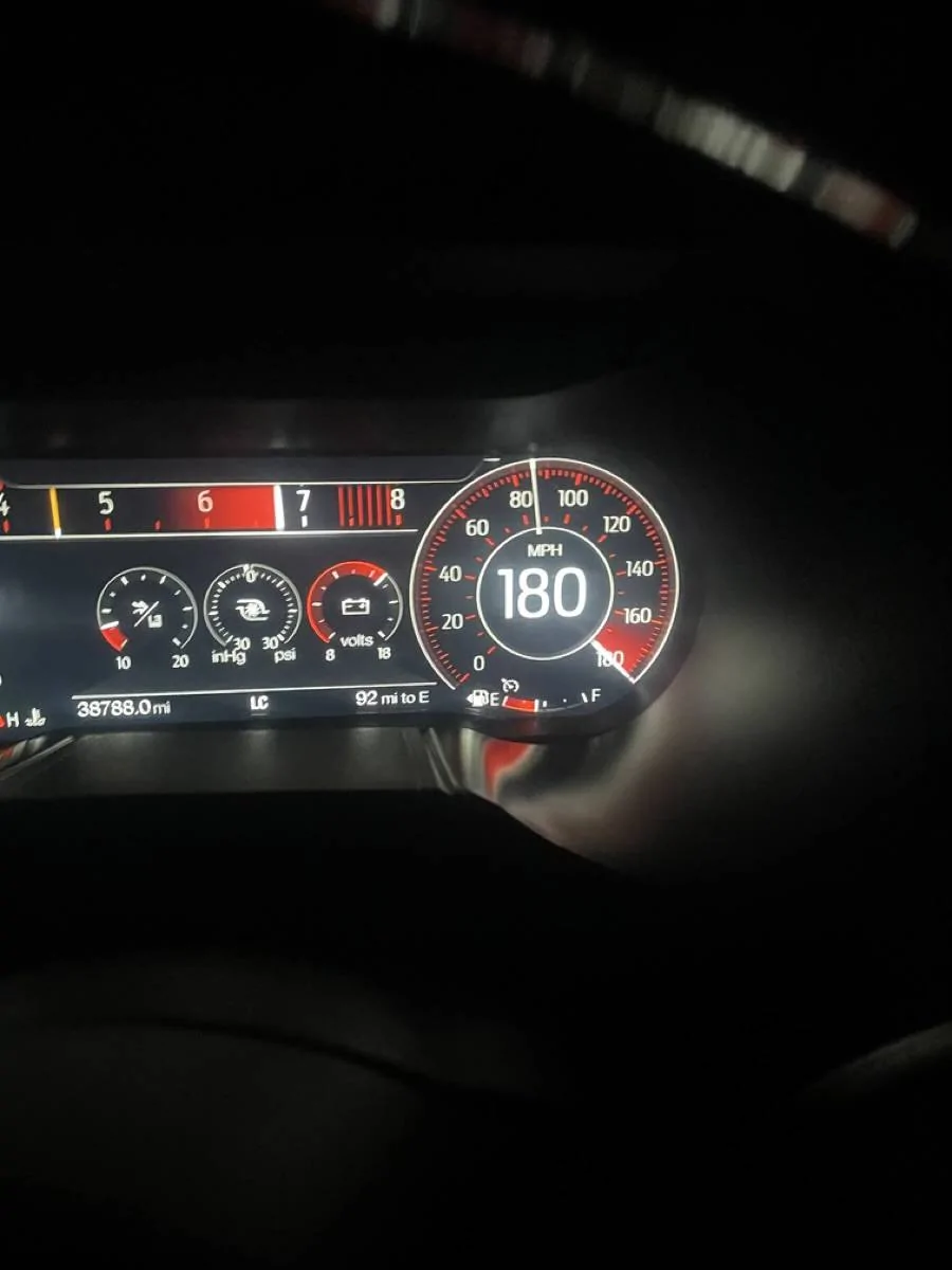

I’ve done many upgrades to my Mustang in the 4 years. I’ve had it. Its a base model. FBO,tuned and susp upgraded , Hellhorse Performance 8 inch touch sync3 conversion upgrade “ I had calculator screen “and the bullit edition digital cluster 180 mph speedo it has from S550 customs S650 RGB sequential rear taillights and Form sequential headlights,, inside I have a Sundown Salt4K amp pushing 1 12”Sundown ZV.6 up to this point zero issues,, now -> a little over a year ago I installed sequential front turn signals they work perfect as it should sequentials work in unison with my form headlights, my fog lights are built into the parking light so when I turn my fog lights on, I get heavy static in my FM radio only when I turn fog lights on via switch beside headlight switch, when I turn off fog lights crystal clear FM signal ,, honestly for the longest I just simply stopped running my fog lights to stop it because let’s be honest. they suck anyway, this past weekend I added a new D4S DSP in my car and now it is extremely bad to the point where it sounds like. I’m on a random AM radio station trying to jam out and just like with the fog lights when I turn the DSP off crystal clear, I really want to believe that I am not the first and only person to have this issue. I’m not getting rid of the DSP or the lights so that means that sacrifices will be made if I do not find and fix the issue , if any of you guys know something I can go buy that would be great,, for the record I am mechanically inclined im a Maintenance Tech @ Dana Spicer “driveline div” I have done every modification to my car myself except for Forescan,Dyno and tune of course, any helps appreciate and thanks in advance guys.

Nice setup
