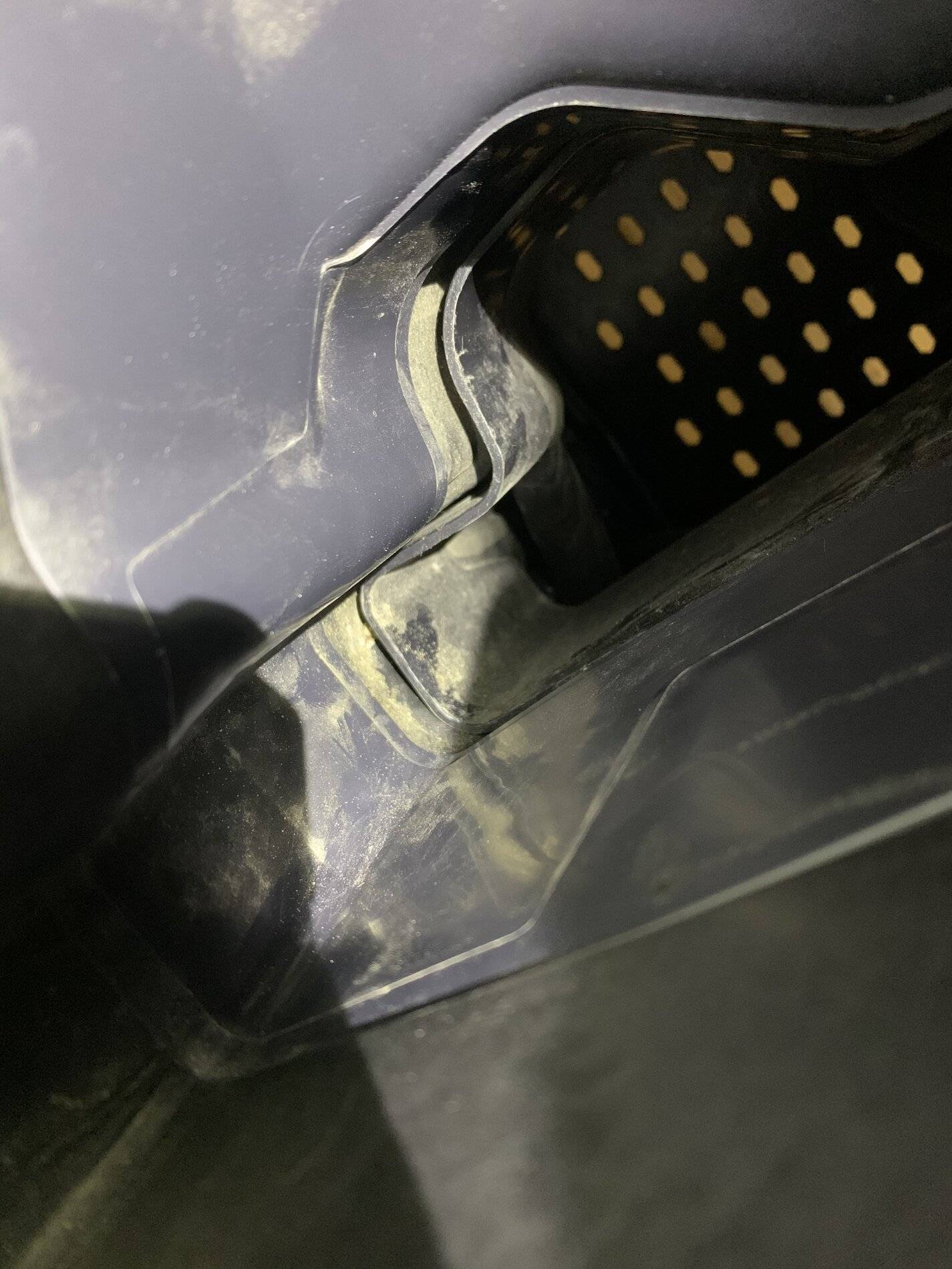

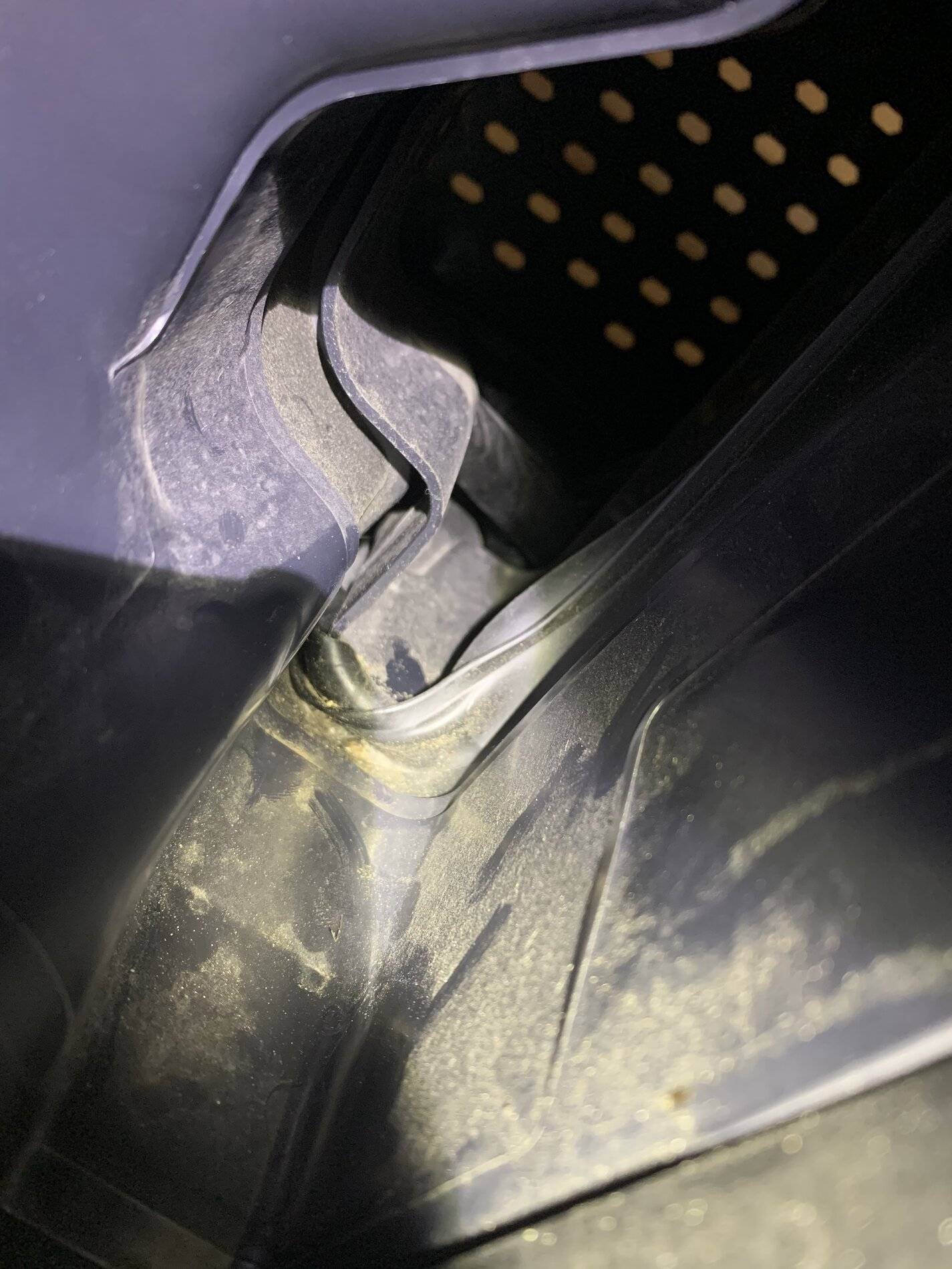

While replacing my air filter today I noticed that the intake ducting was not sealed correctly. I reinstalled the air box and made sure it fit correctly. It won’t make much of a difference in IAT or performance but at least it seals better.

Mine bullitt was exactly the same, build april 2019.
Tho i didnt note Any diff in intake temp.

It's before the air filter, so zero difference. And if you notice, even when assembled right, it's not sealed at all. It's okay on my car, but it's a matter of luck that the box didn't grab the gasket when pushed in. Assemblers obviously didn't check that it was inserted correctly.
