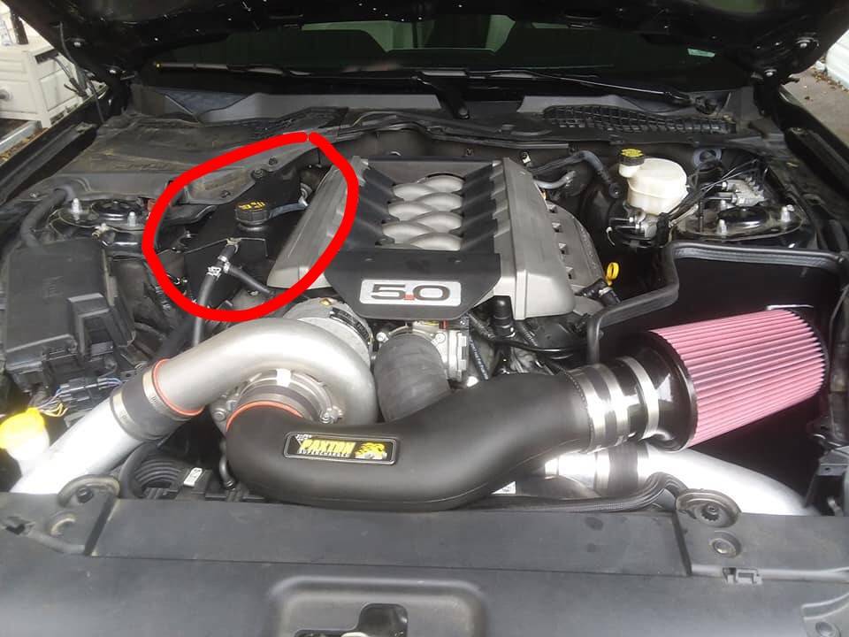

Id look into procharger. I went with Paxton and I hated where the over flow tank got relocated. Right over the left bank of spark plugs. If you keep the car for any length of time. you’ll want to change the spark plugs more frequently On boost. You don’t need that stupid tank in your way. The post right above me by Mustang lou is funny. :giggle:But it’s f#&king true.:angry:
