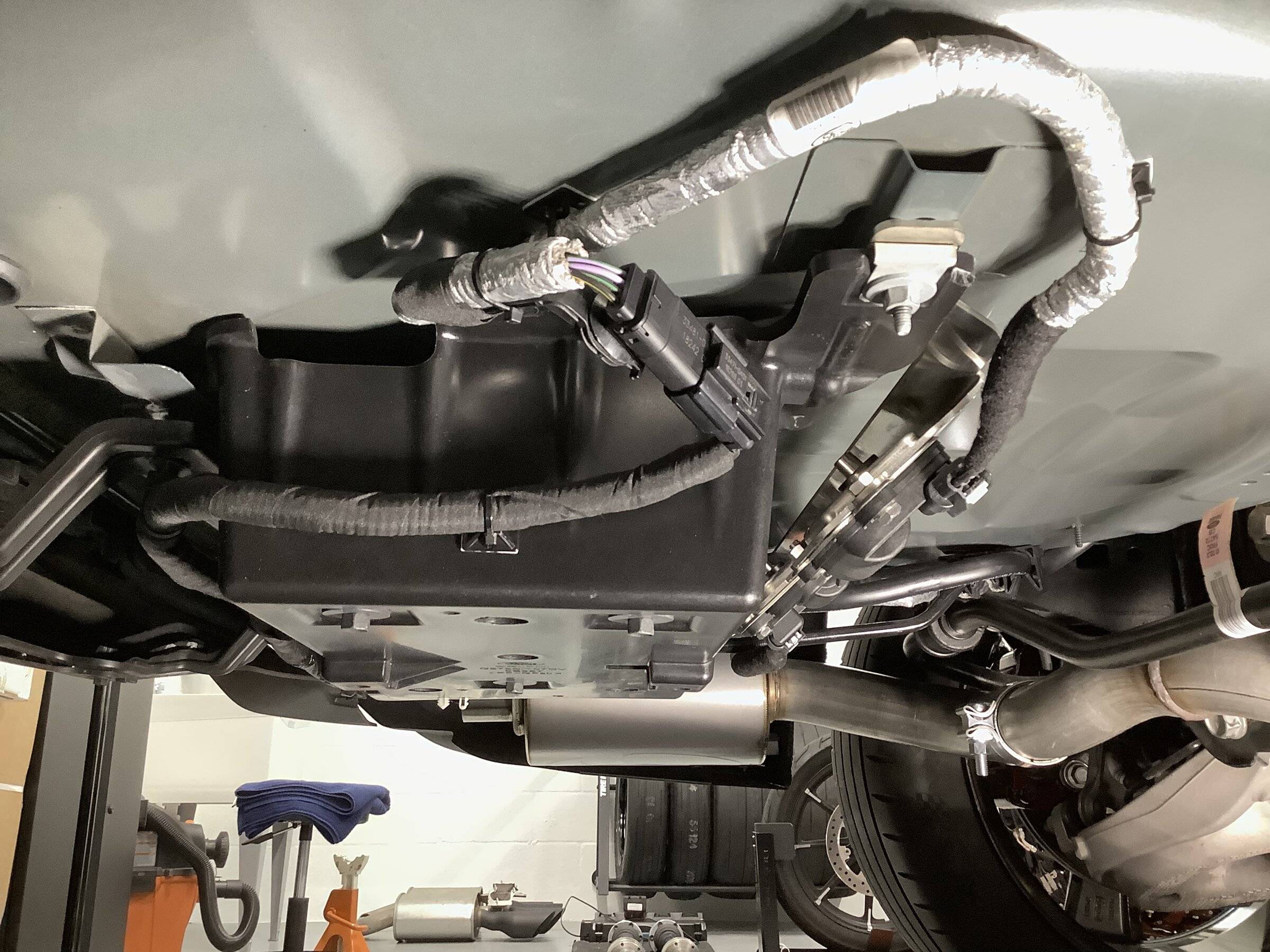

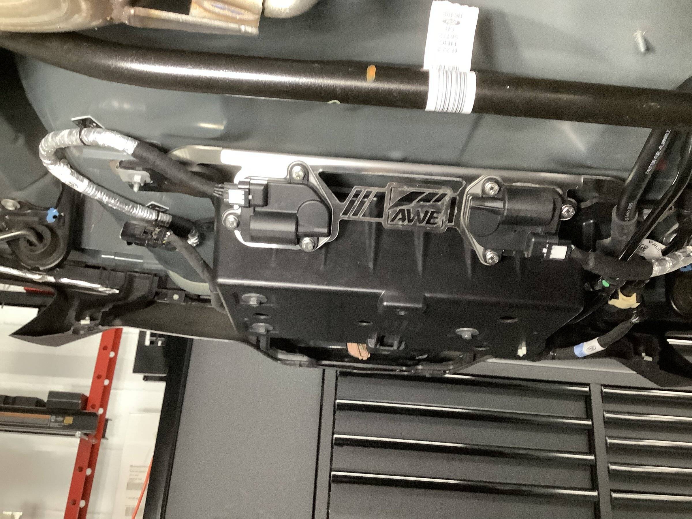

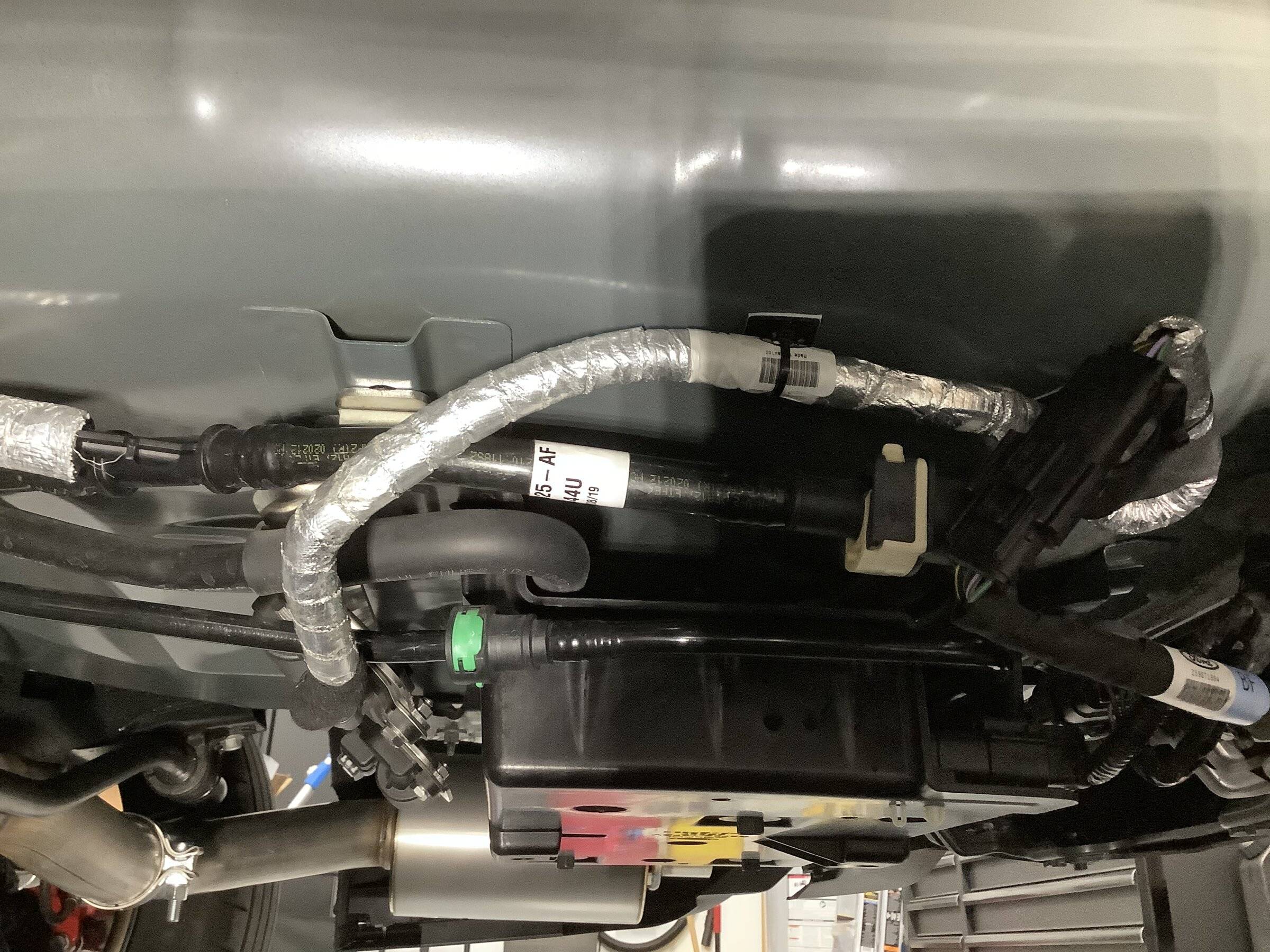

I just did this to my 2019 Bullitt a few days ago. I used an AWE bracket to mount the factory AE actuators underneath the car and keep them plugged into the factory AE wiring harness to prevent getting the Exhaust Mode Malfunction light on the dash.

Thanks. Yes, it was just the one bracket and I purchased it from CJ Pony Parts for $105. I now have a Steeda axle back exhaust on the car with straight through mufflers and the car is definitely louder than before.
