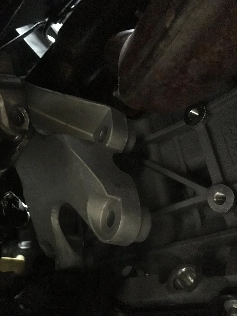

Then, from the engine bay with appropriate length of extensions, I unbolted the two 13mm (mount bracket) bolts almost until they are out. These are a royal PITA to get out since they are loctited on every single thread - at least mine were. I used an impact swivel socket and my Makita impact gun (the big kind that'll do lug nuts) and backed them out and even it was complaining. You can finish removing these bolts with a swivel head ratchet from the underside of the car or the top if you have the engine supported, but I chose to leave them until I removed the engine mount bracket (see photo below for what I'm talking about).

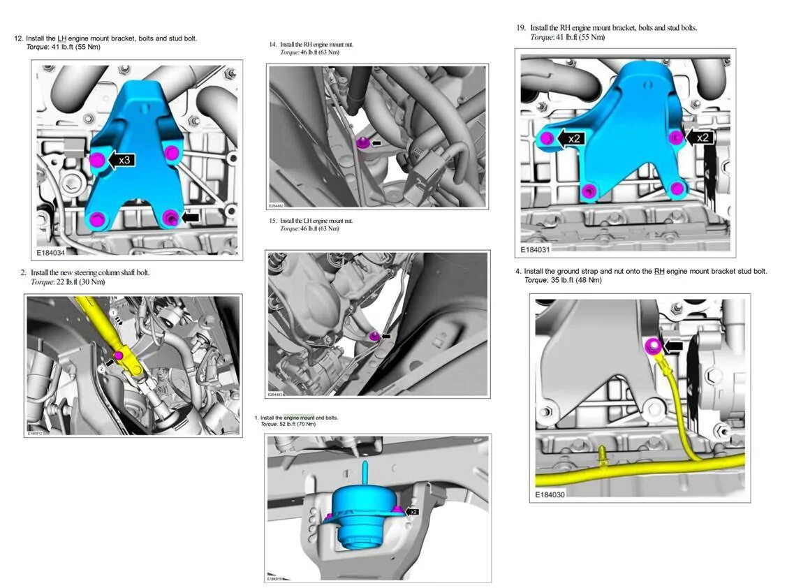

Torque the engine bracket bolts down (I did 41 ft. lbs). This especially is where swivel sockets and swivel head torque wrenches make life easy. Some of the angles you need to get are weird and you need this articulation to make the job easy. Fortunately I was able to borrow both. But, I was able to get the job done with a swivel ratchet and a standard 3/8" torque wrench, it was just going too slow so I borrowed tools and made life easier.
Once that engine bracket is torqued down and you've verified you didn't screw something up, you'll then lower the engine onto the new mount, head up top, and torque the two bracket bolts down (I did 41 ft lbs) and the isolator bolt down (I did 37 or 38 ft. lbs, can't remember exactly).

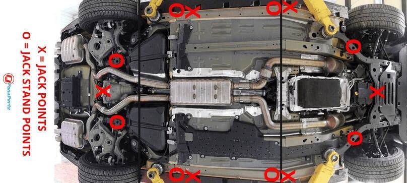

Lifting the car:
I used a QuickJack 7000tlx (24" lift) so I fit under the front tires. Removing front tires is a good call for anything lower.

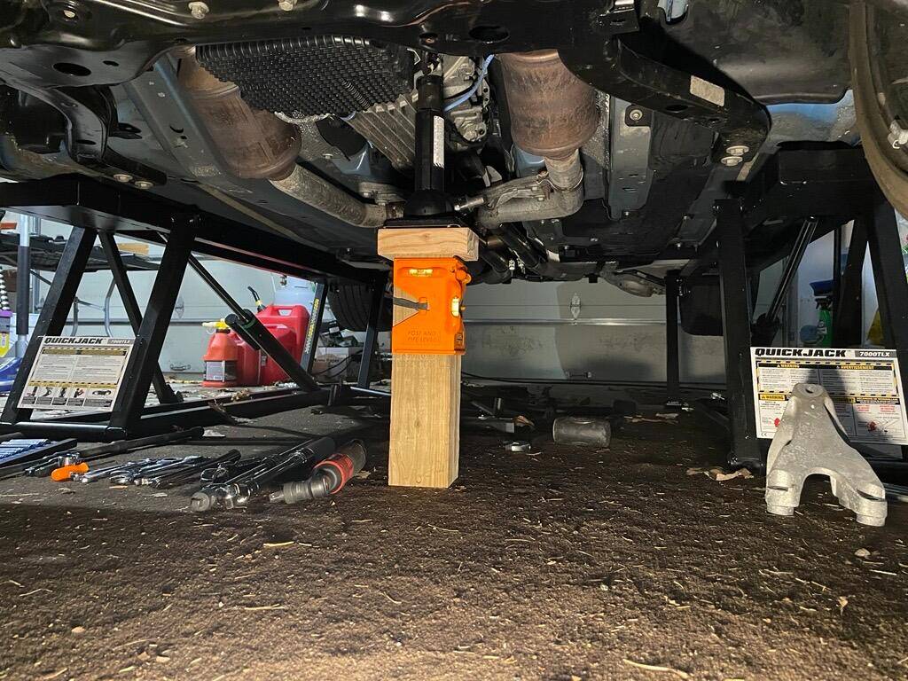

Lifting the engine:
As stated by OP, not much lift is needed. I used the bottle jack from my Tacoma. It's screwed to the wood blocks.

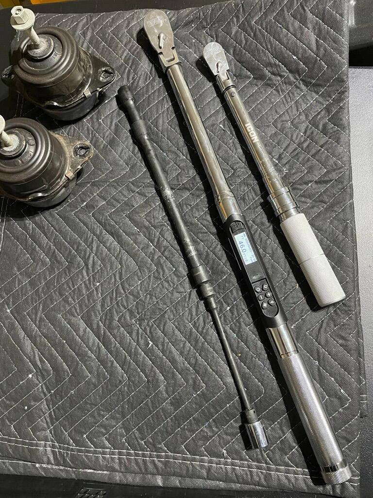

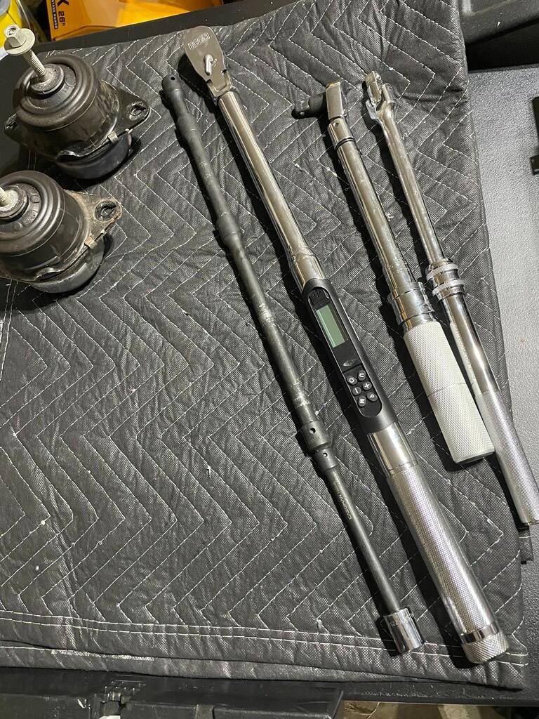

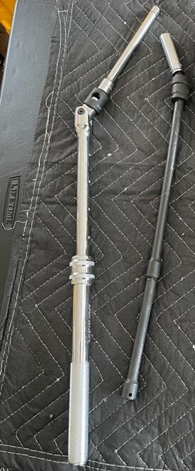

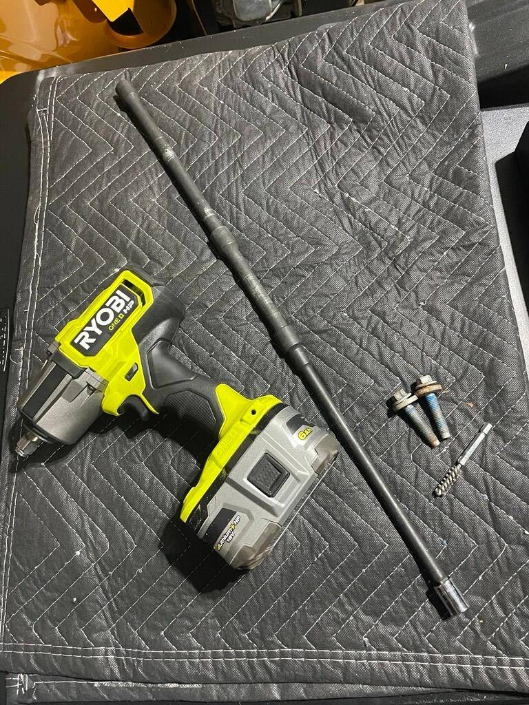

As OP states, the tools on hand dictate the difficultly of this install:
The rest were nice to have.

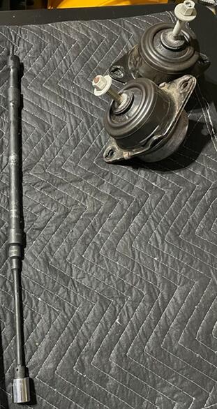

Removing the OEM motor mount hardware:
The 3 OEM mount points were broken loose from the top using stacked 1/2" socket extensions on a breaker bar. Yes.. there was a stupid amount of Loctite that fights to the very last thread.
The motor mount center nut needed a deep socket and universal joint. A high torque impact wrench was used to remove the nut and bolts. The last socket extension had to be reduced to 3/8" on the DS and 1/4" on the PS which unfortunately restricts the torque the impact can apply.

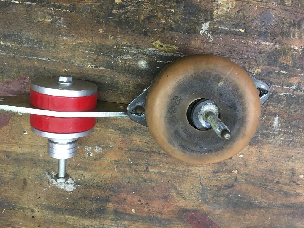

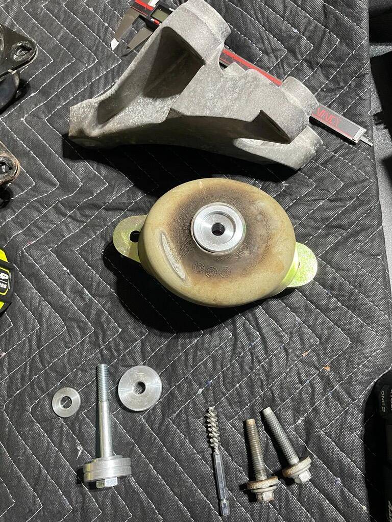

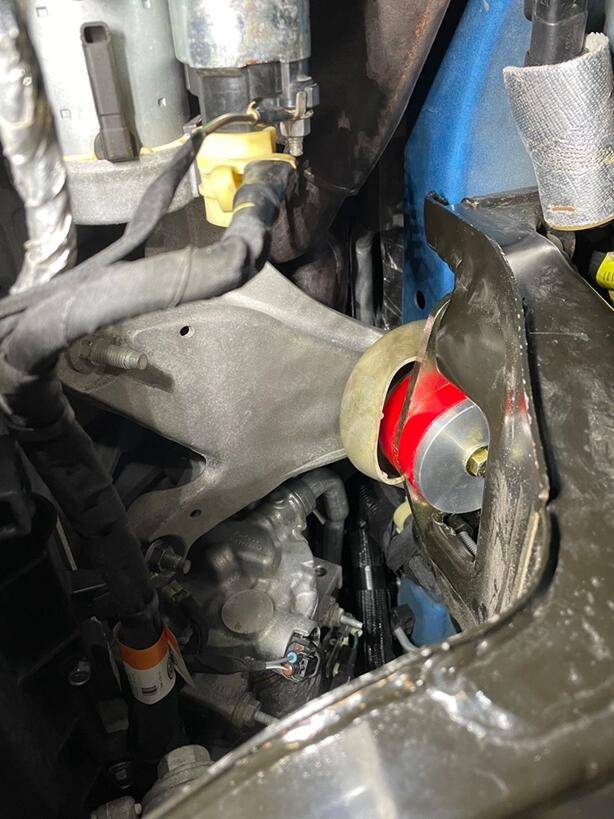

Steeda motor mount assembly:
I also lowered mine 1/2". 3/4" will make the oil pan contact a Steeda G-Trak brace. 1/2" lowered my blower more than 1/2".
I did reuse the factory heat shield cup which was slightly annoying to install. The shield can be stretched onto the Steeda mount. The shield should spin freely once the motor is lowered onto the new mount. No spin.. It's pinched.

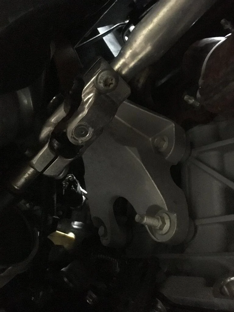

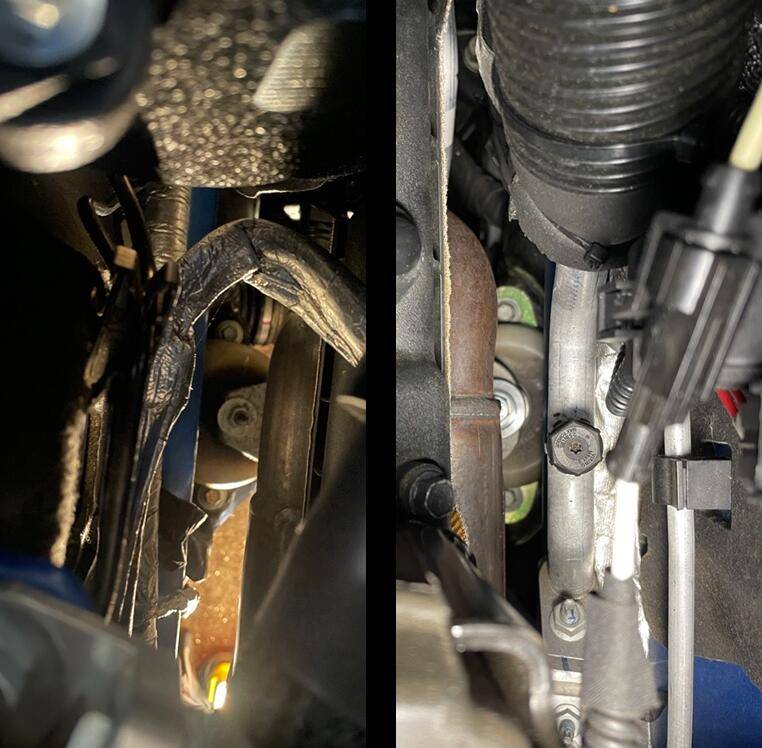

Driver side tips:

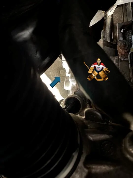

  • I did not need to disconnect the steering shaft due to the flex-head tools.
  • I was able to sneak my left hand passed the alternator to gain access to the back DS bracket bolt and steady/align the flex-head wrench during removal and torquing.
  • The Steeda DS motor mount needed to be set in place before the engine block bracket was reinstalled due to the steering shaft.

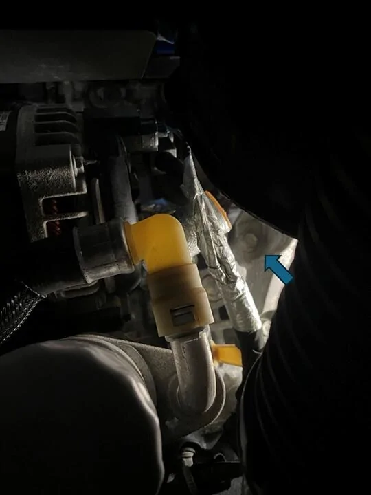

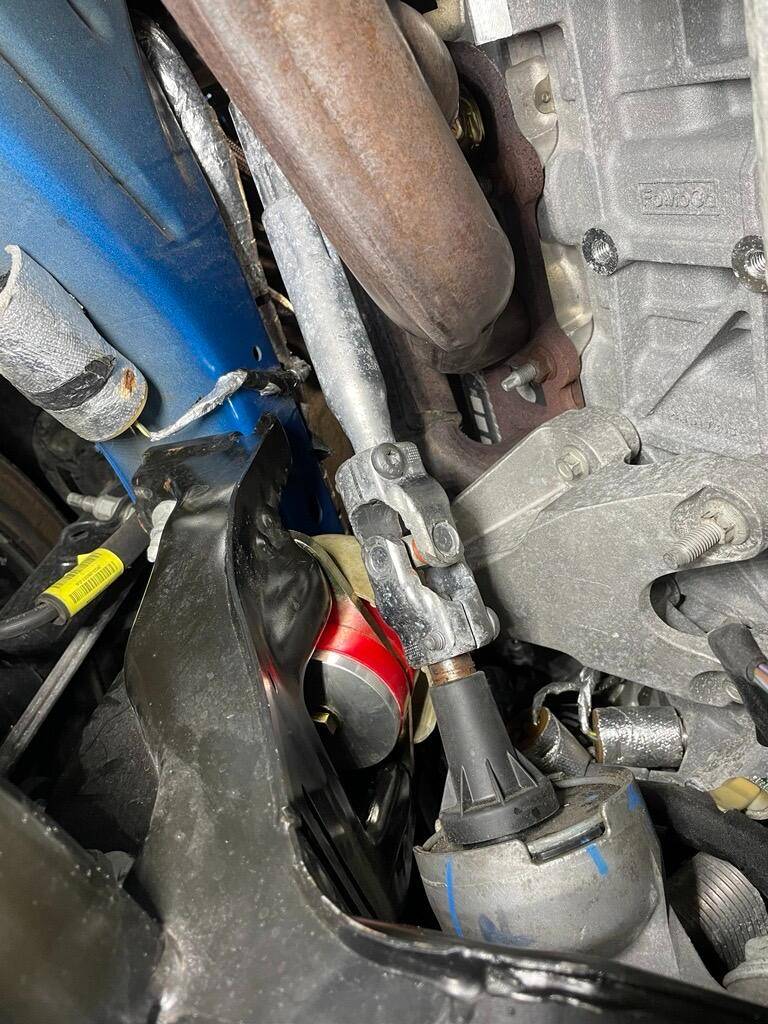

Passenger side tips:
  • I was barely able to sneak my right hand passed the A/C compressor to gain access to the back PS bracket bolt to steady/align the flex-head wrench during removal and torquing. There's a rigid harness blocking the way.
I passed all reused mount and bracket bolts through an oiled thread dye. Removed oil before reinstalling. I also cleaned the subframe threads with a wire brush bit (not the Al block). Being able seat all bolts finger tight makes for an easy install. All bracket bolts were torqued from under the car. All motor mount bolts were torqued from up top.
