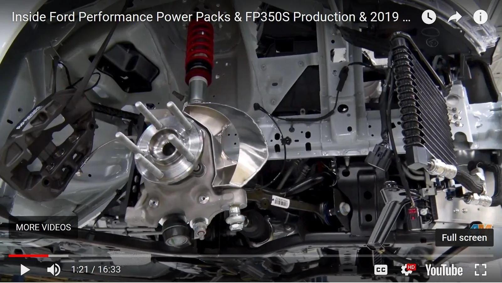

As much as this car is using a "smaller" brake package to allow fitment of an 18" wheel I think the ducts that were fabricated for use here may also work with the larger GT350 caliper and factory wheel. I have a sense that there would indeed be a cooling benefit for use on heavily tracked cars.

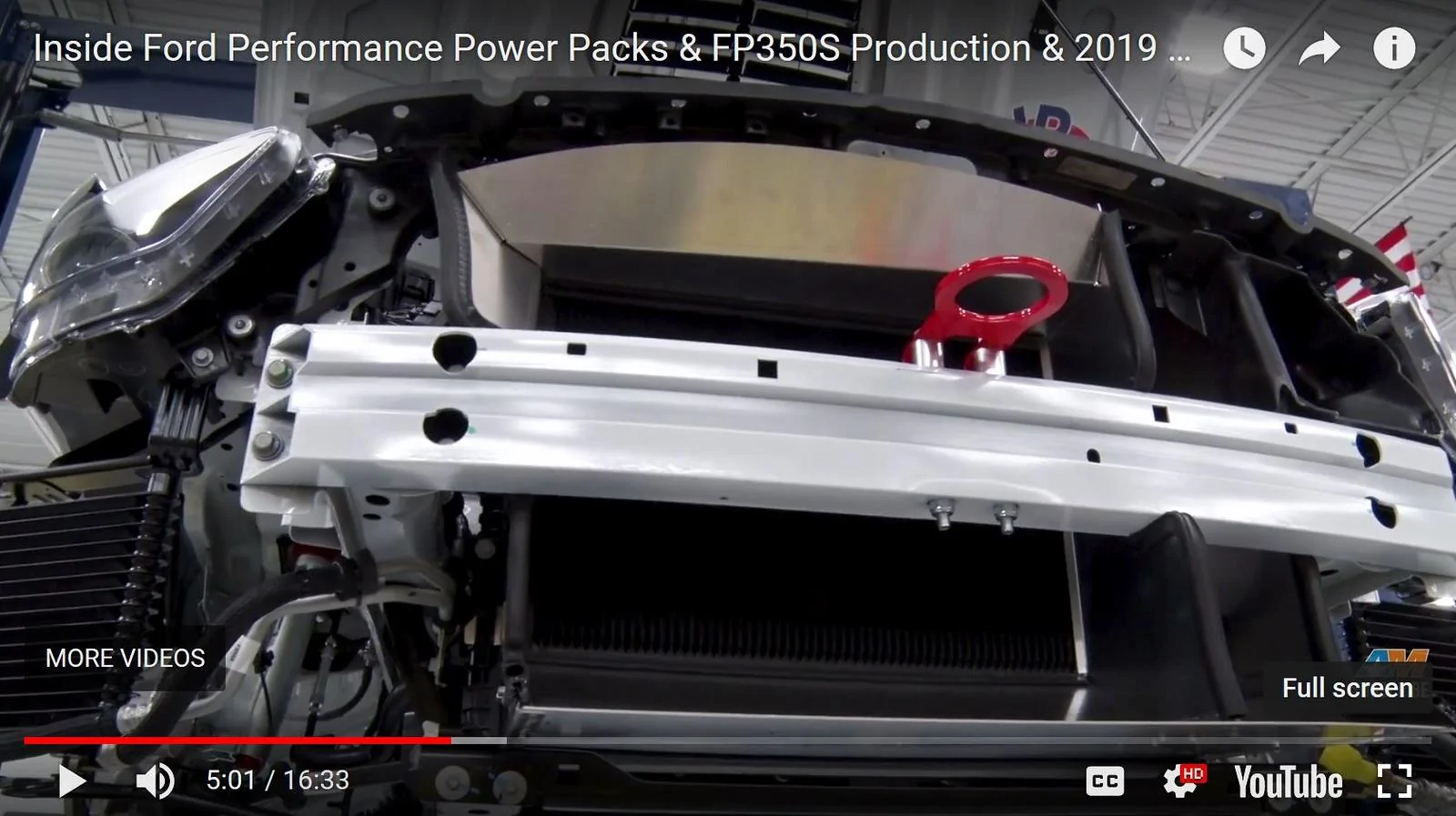

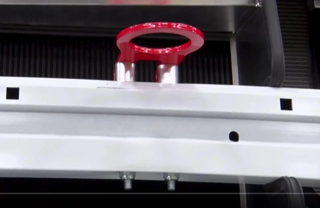

I don't like what I see with respect to the FR front tow hook. The front bumper is a bit fragile (and extremely light - it's aluminum) and if you look closely you can see that the fasteners are crushing the bumper. Ford engineers - you can do better. This kit should have been designed to use an insert(s). The torque figure necessary to impart the necessary stretch on the bolts is greater than the tubing can support.

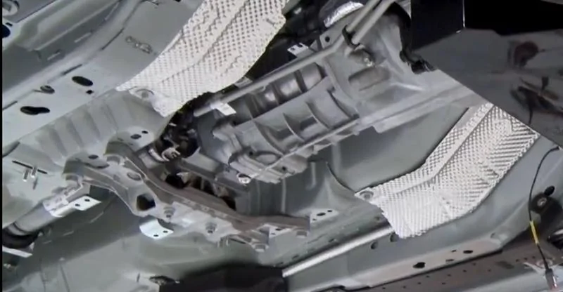

No weights at the rear of this TR3160 thanks to the use of the CPC crank. Also note that the cars are using a two-piece steel driveshaft. The last Boss 302S used the '13/'14 GT500's carbon fiber driveshaft (as well as it's TR6060 transmission).

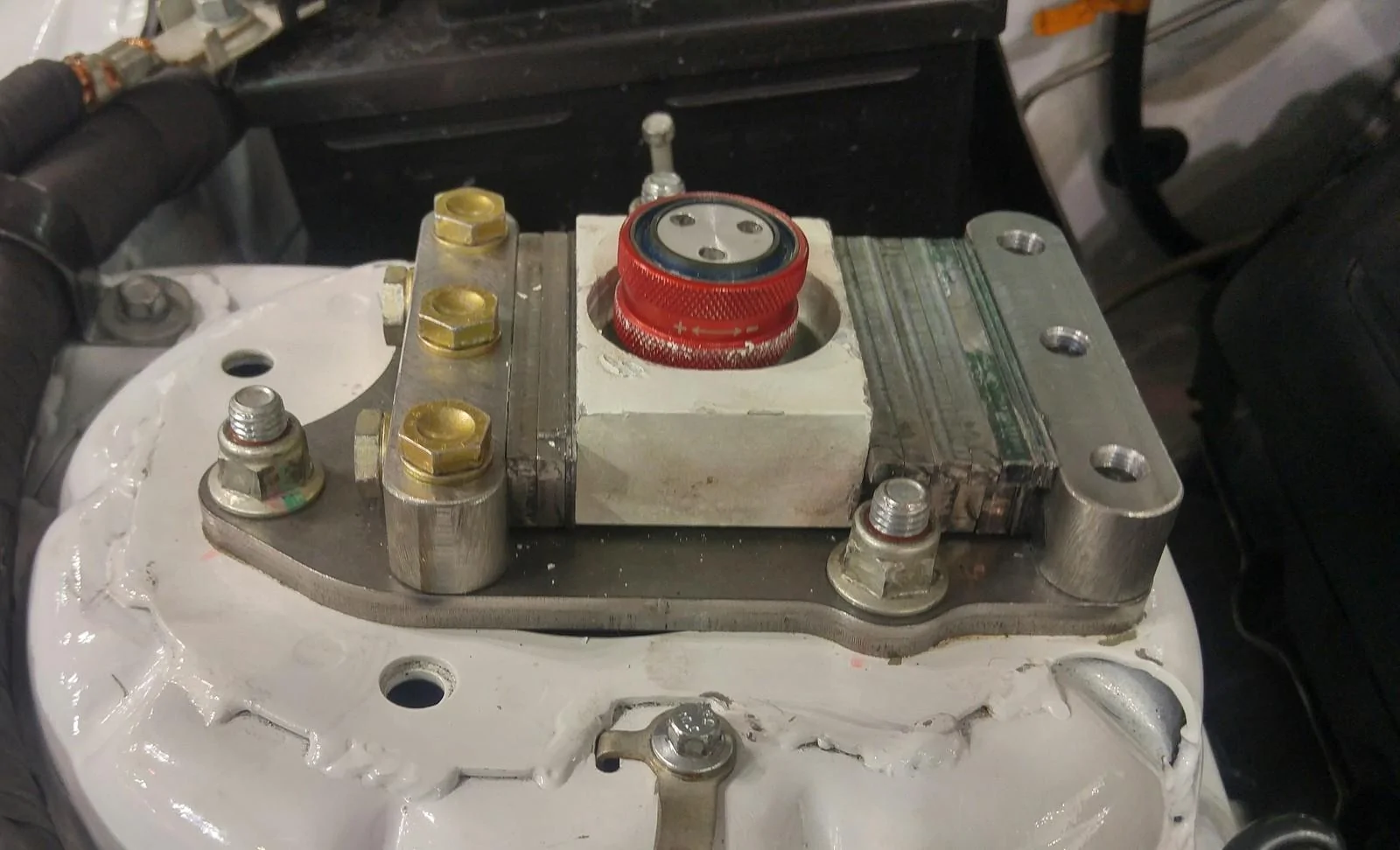

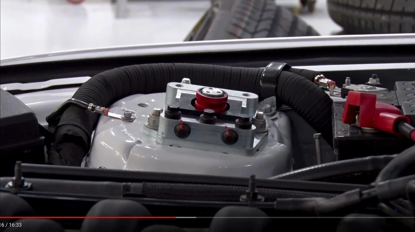

At least Dave was honest in mentioning that the design for the camber plates didn't originate with FR. Cough, Multimatic, cough. The finished pieces look sharp.
The plates on the PRI prototype FP350S I saw...

Those camber plates are nice. But I would think that changing and measuring camber is much easier than measuring and adjusting the toe after a camber change.

I think camber plate design was more for ensuring that the camber settings would remain fixed during a race, and that changes are ensured to be correct. This way if they want to put in a bit more camber, there is no guessing on the change as the shim ensures the correct placement of the strut top. Then its locked in so that only mechanical damage changes it.

I only made the comment about setting toe because he commented at 7:25 about how using the camber system meant they didn’t have to get on the alignment rack or under the car. Still have to use the rack (or strings) and get under the car to reset the toe.
I agree, its a neat system to quickly set camber, and sets it in a very fixed way. They might have also calculated/tested how much to crank the toe for each of those spacers. That would make the toe reset less hassle as well.
