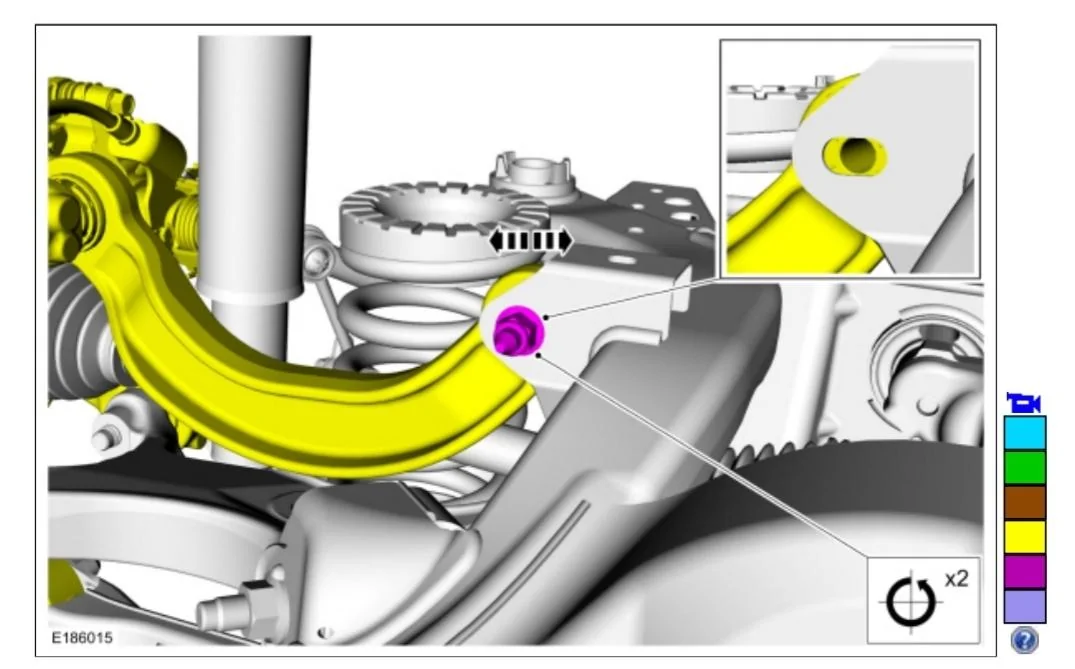

The bolt for the rear camber adjustment is this one if I am not mistaken?
It needs to be loosened and the control arm kan be moved? How much is it possible to adjust?
Thats the correct bolt yeah. You can get quite a bit of adjustment there. I dont know the minimum, but the max at my ride height is well over 2 degrees
