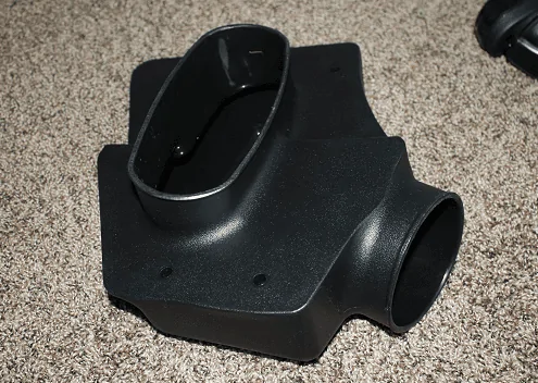

I agree I like the intake tube, but I dislike the way the filter gets attached and creates an unessary 90 degree turn.
Here is a good picture of what you are talking about:

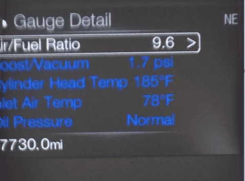

Interesting observation today with this intake. To do a proper datalog, you can't use E85 on the flex fuel tune. You need to run 91/93 octane gas. I have a full tank of E85 that I need to run out. So I'm driving around today in 4th gear +4k rpms AND jabbed the throttle and something caught my eye on the factory, digital vac/boost gauge in the dash. With the closed air box of the INJEN, I'M MAKING BOOST :headbang::headbang::hail::hail::lol:. What's happening is that the box is getting stuffed with air but the throttle body blade is holding it back. As soon as you floor it, that stored air goes through! This was at 50-60mph. I'm seeing a max of 2.0lbs of boost for a second then the air box is depressurized by the engine. My Roush could never do this because there was no trapped space being an open box top. Still funny. Might help in a roll race:ninja::D

Higher intake pressure but with lower velocity. The pressure increase is probably from the bottleneck created by separating the filter chamber/inlet from the rest of the intake with a wall.
