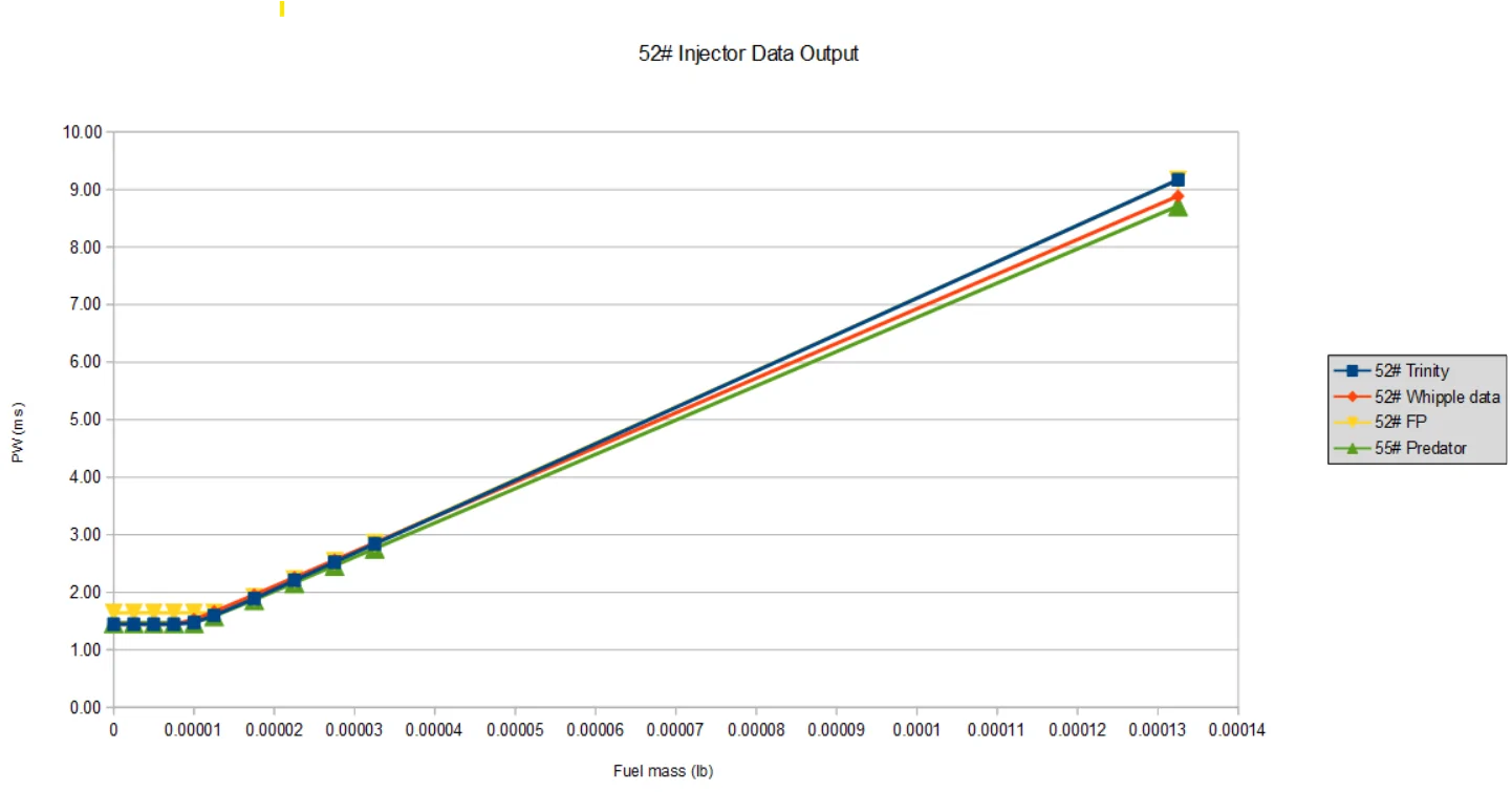

Here's an example. We have 3 sets of data for the FP 52# injectors: FP, Trinity, and Whipple. Also, the FP 55# injectors are OEM in the Predator and quite popular in the centrif setups, but are very close to the 52s in flow, and data is only available in the OEM Predator tune AFAIK. Here are all 4 compared:
So you can see here that the FP data yields a very similar result to OEM Trinity data, with the exception of the very low PW range. Whipple data is similar to OEM Trinity data at low PW, but off at high PWs. The Predator 55s are capable of both lower and higher flows, albeit a small difference on either end.

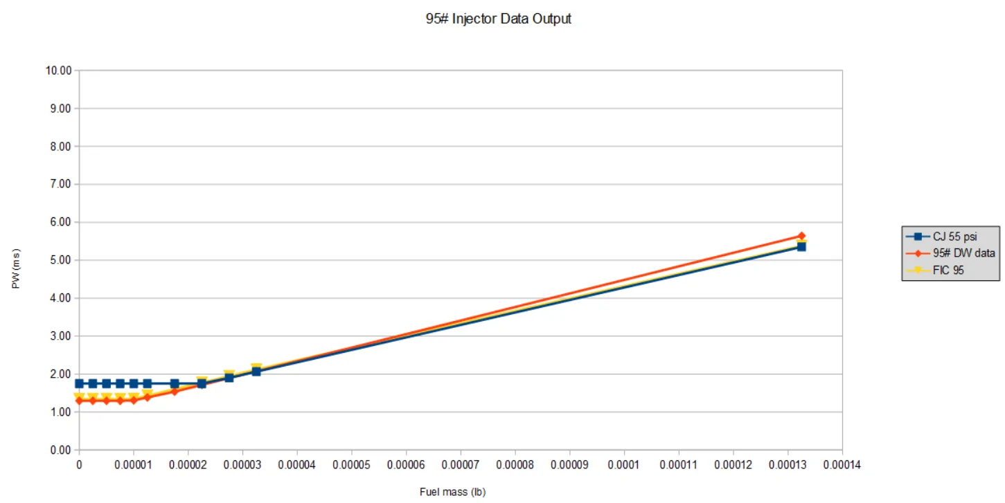

On the Cobrajet they force the min pw high enough that it's always using the hi slope with the dw95's.
Interesting observation. Though on the CJ data the low and high slopes are so close it only really needed one slope to begin with.
Gen2 this needs a bit of tweaking if using stock pump control/basket. Gen3 probably not as much. Dw data is horrible imho, at least for these injectors. Would like to see the fic data if you have it to share.
I have FIC95 data and here's how it compares to CJ and DW:
That said, I can't say for sure the FIC 95's are physically the same as the ones in the CJ which I know are DW.
