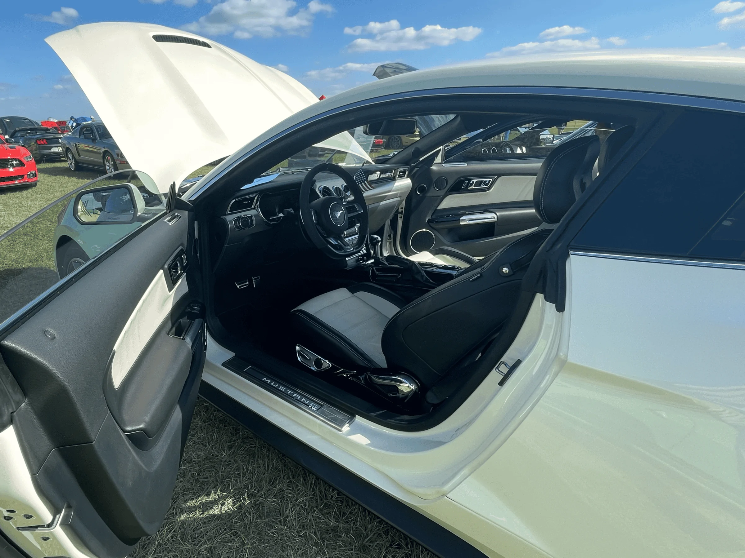

Hi Marcy!
I just plugged them (The Regular Illuminated Plates, not the LE Serialized Plates) in to the Harness Connector that's supplied with the Car. I had the Tech at the Dealer Enable them with Software. Some Dealers don't want to do this, but I talked to the Service Manager at my Dealer and they worked out a Deal for the Tech's Time for about $100 for Programming the Plates and the Old GT350 Instrument Cluster. Have since Swapped Out Clusters for the Newer Digital Display. Let me know how it goes, here or on the 50th Site

That chrome trim on the sides of your seats is nice looking, care to share where you picked up those parts and cost?

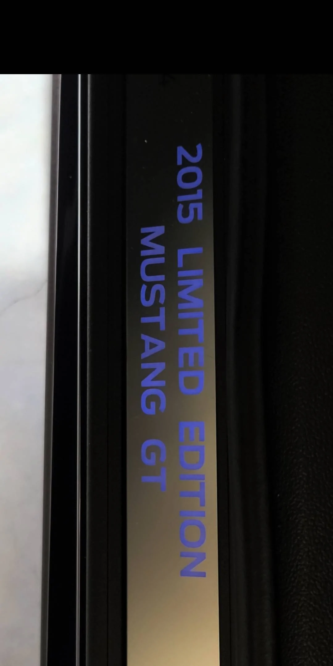

Installed, programmed, and couldn't be happier! All done in less that 40 minutes (should've been a lot less but I read, and re-read the programming instructions at least 3 times, then backed up my original configuration because I was nervous about messing up lol).
A BIG thanks again to the pioneers who figured this out for the rest of us to enjoy! 👏
