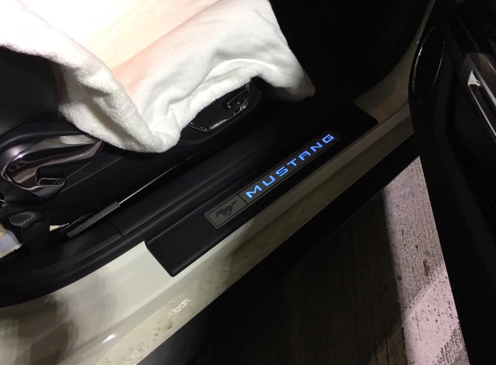

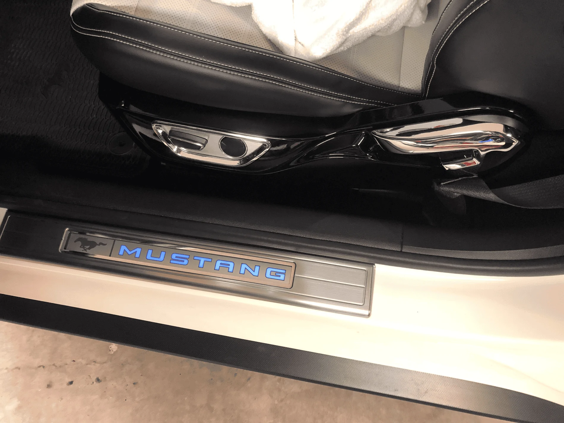

We just installed the illuminated door sills on my brother's 2015 convertible. He bought the door sills three years ago and tried to get them to work but we didn't know about ForScan. We changed the BCMB code from 0140 0000 01 to 0142 0000 02. The program automatically set it to 0142 0000 03 so we went with it, everything seems to work including the door sills! :)
Thanks to 911Nemesis and others who paved the way!
