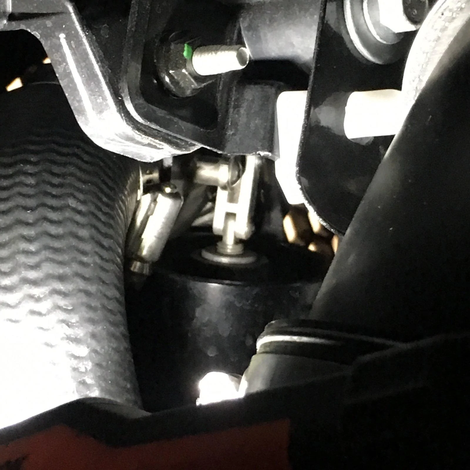

I had a friend complain that he was making low boost, and I was like
"Hey man, there's no way... we have the same blower, same tune, same pulley, the same city"
I told him to check the basics like a loose clamp, etc.
Of course, he was like "dude I checked everything"
So I put it on the lift, and checked the valve first thing.
And here is what I found....
The bypass valve was stuffed into the frame and couldn't function correctly.
All it took was rotating it the other direction, and all is well.
Sometimes its the little things..

I can't really tell from the photo. Is the linkage that opens and closes the valve just hitting the front bumper or what?
Ya it was slammed up against it tight. So it couldn't fully close. (id say it closed about halfway)
