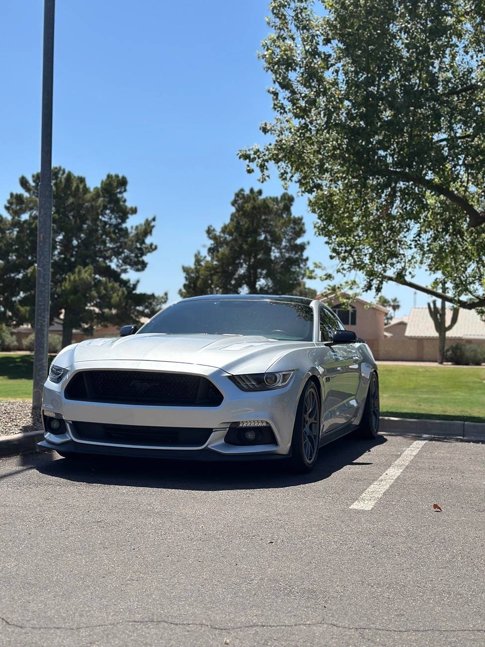

I got 19x11 in the rear with a 52 offset.
The fronts are 19x10 with a 40 offset. They look like they’ll fit perfectly flush with the wheel wells if the camber was set correctly.
