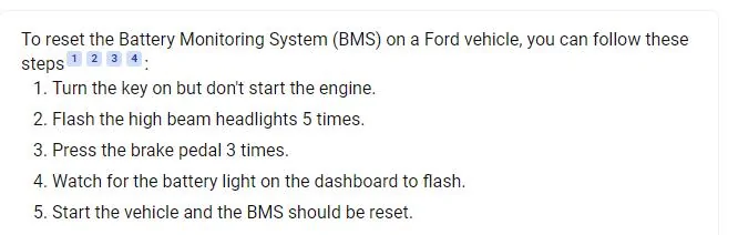

It started months ago. What's odd is that it will not do this low idle behavior for months and then all of a sudden it started up again. I didn't mention earlier, but I just replaced my battery last week. Not sure how that would cause low idle though.

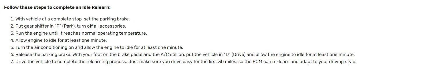

Did you perform the BMS reset when you changed the battery?
There is an idle relearn procedure, never tried it but you might give it a shot
I didn't perform the BMS reset procedure. Seems like the idle relearn is for an automatic?
