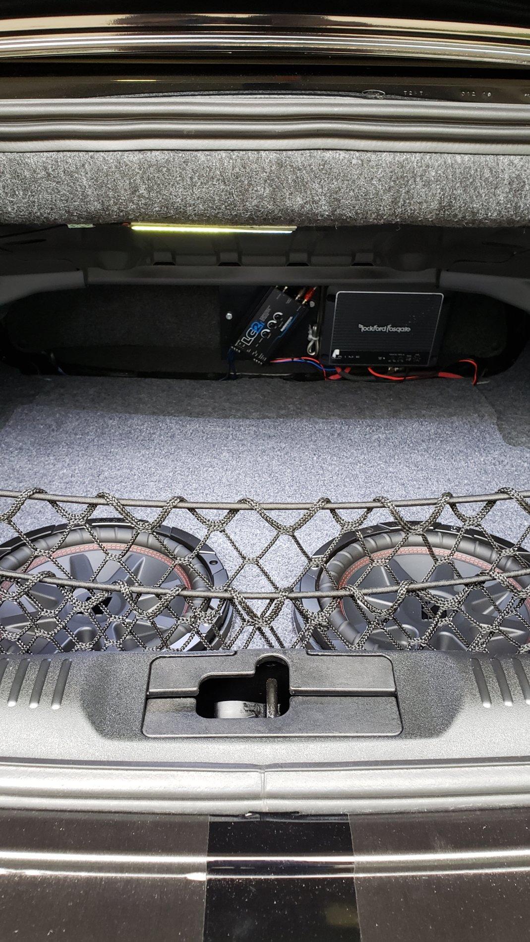

I needed more bass for my vert

Stock sub didn't have enough kick especially with the top down. So after much research I fabbed up a fiberglass enclosure for the spare tire well. Slams harder than I expected! Plenty of tweaks to do and wires to hide in the trunk but that's for another weekend or two. All the stock stuff is still there and I'm sure I'll get bored sooner or later and replace them with higher end stuff. Unfortunately I don't have any pictures of the process but if any one has questions I'll try to answer.

Well done. I've got the stock sub with a Polk in it. Damn thing takes up so much room!
The LC2i runs off speaker level inputs correct?

Nice work! Those look like 12's; enough airspace in there for two 12's? Probably around 2CF or so after displacement, I'd imagine?
Yes speaker levels from the front
They are 10's. Had enough room for 12's but I had the 10's laying around for a while and decided to just divide the box. Little bit over 2.7 CF total.

Wow, that's a lot more space than I figured was in there. Plenty of space for two 10's! Very nice.
