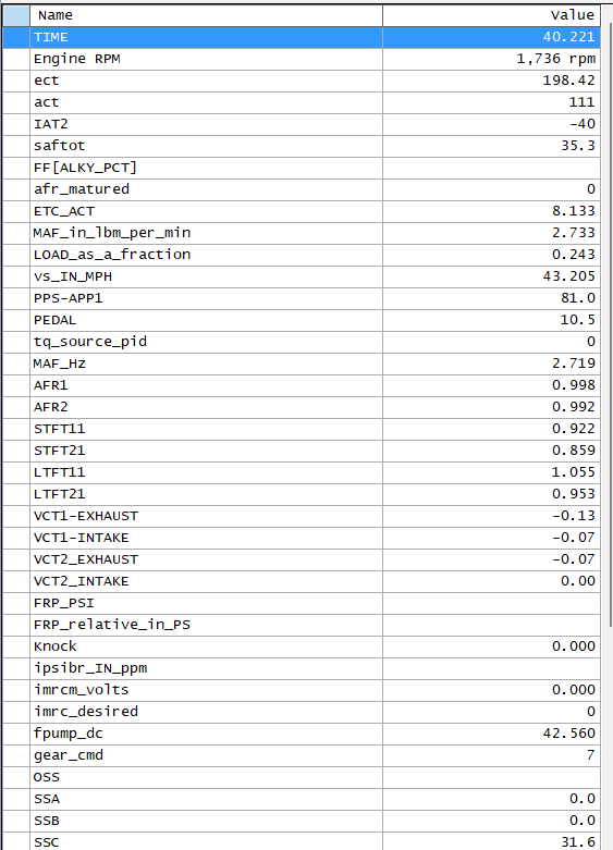

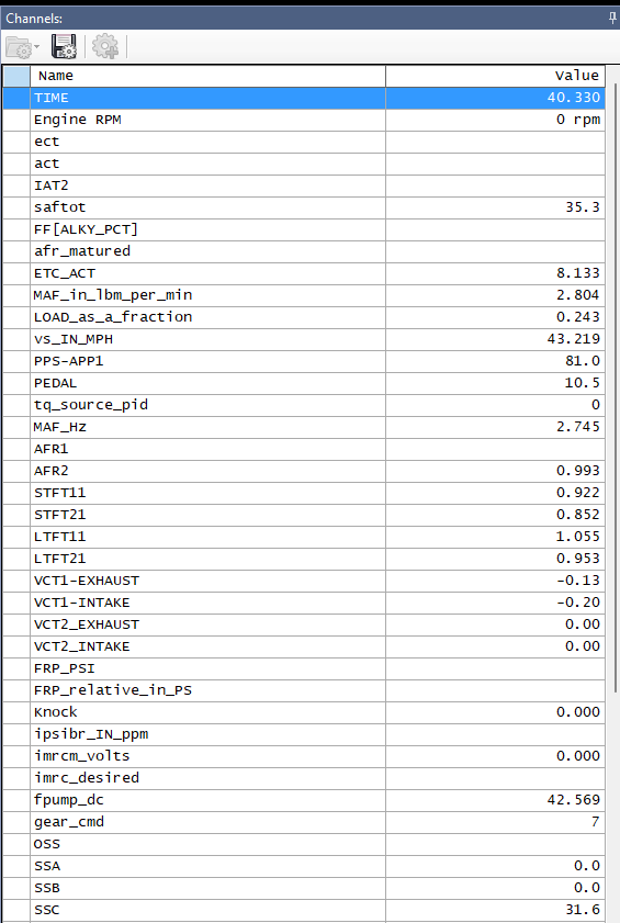

I am going to just take a stab in the dark since we don't have a lot to work with. We need to know what time stamps in the logs are exhibiting the issue.
In log0024, there is one spot that is obviously odd. The RPM drops out, which is why I saw it, and a few other things drop out with it.
We can see ECT, ACT, IAT2, afr_matured, AFR1, and IMRC_desired drop out. At the same time both VCT2 channels drop to zero.
Here is a screenshot of the RPM dropping out in my scanner layout, and then screenshots of the channels list before and during the drop.
RPM drop:
Before drop:
During drop:
No idea what's going on, but it seems like all those channels dropping out at the same time could be a clue.
Personally, I would start with some troubleshooting basics since we don't know much else that's going on. I would check the battery, charging system, and all fuses to make sure that is all working properly. Once that is verified, I would re-flash the tune file on the car, if possible do "write entire file" or similar, and then see what happens.
