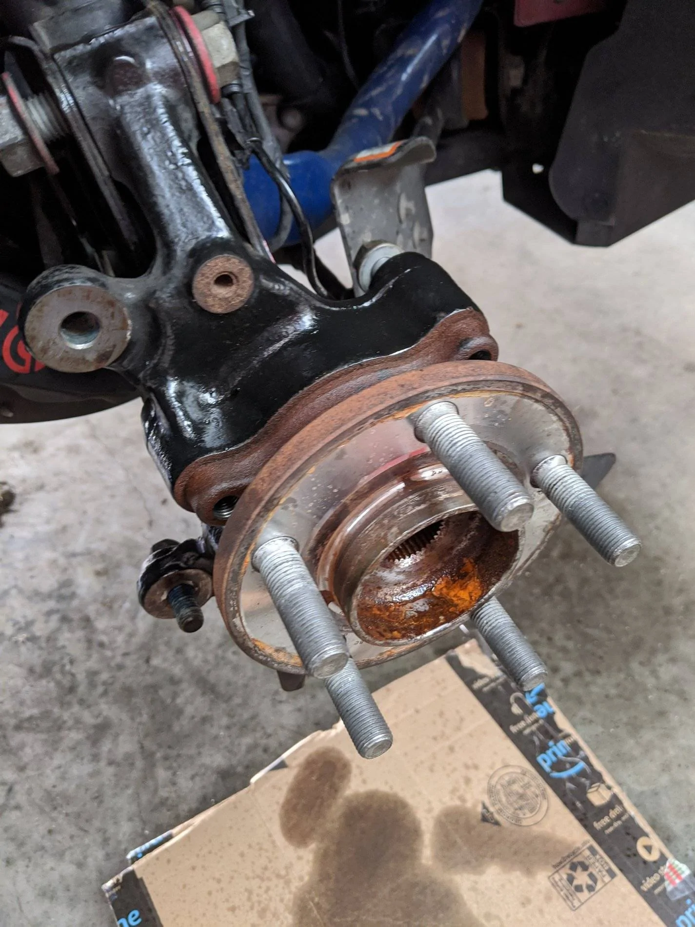

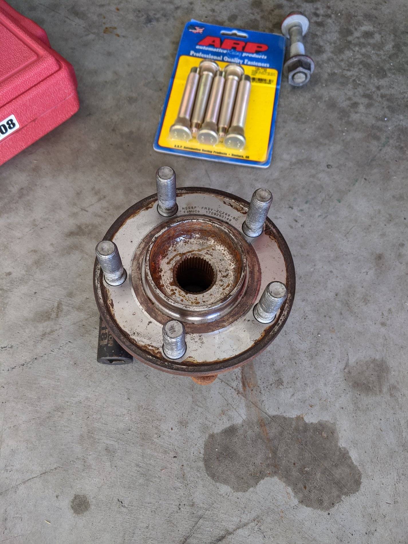

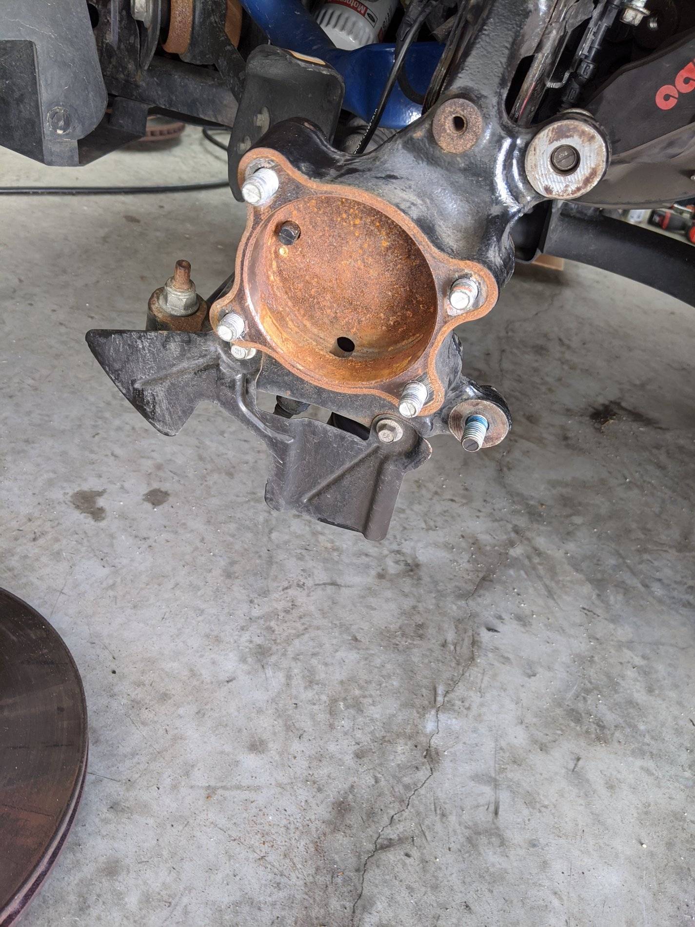

I am trying to remove hubs to replace the studs with the long ARP ones - hubs (since car has Magneride) are 4 bolts style (like GT350), not the ones held with large 36 mm nut. After undoing these 4 bolts it should technically come off - left one did (see pics), right one is stuck - most likely due to corrosion.
I sprayed with penetrant, bolted the wheel on it and tried to pull - nothing. Also tried to bang on it with a rubber mallet.
Anyone has any other ideas ?
Pics in sequence show right hub (not bolts are removed - so no, I did not forget about one and am trying to pull like an idiot), left hub in removed state, left knuckle with hub removed.
