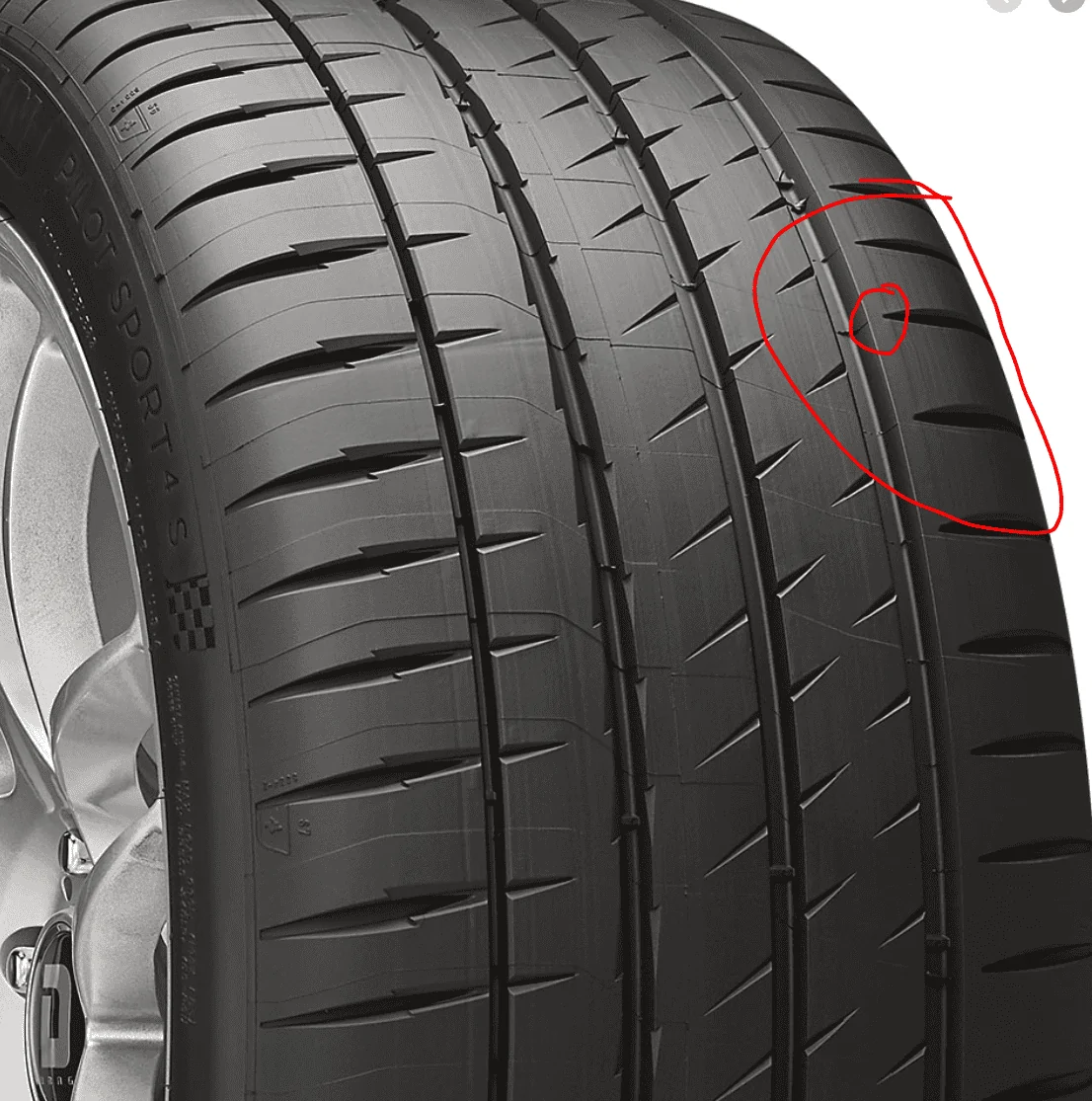

    Questions:
    Are you guys experience some slight vibration with this noise as well?
    Are you running the Michelin Pilot Sport 4S?
    Are over 15k Miles?
    If the answer is yes, the issue could be coming from the inside of the tires on the front wheels. They start tearing up and do not hold up well anymore from the inside. I've checked with a tired shop that is familiar with the michelins and was told that as they come close to their mileage, or if you drive them hard, they will tear up on the inside and cause that vibration/howl noise. At least that is my case.

    you mean internal delamination? That's a MAJOR fail of design/manufacture if so. Sounds like need a few more PSI to help out the carcass.

    I'm not sure what the technical term for it is, but the inside thread part is lifting up in the circle red area. After its worn down enough it starts to tear apart.
