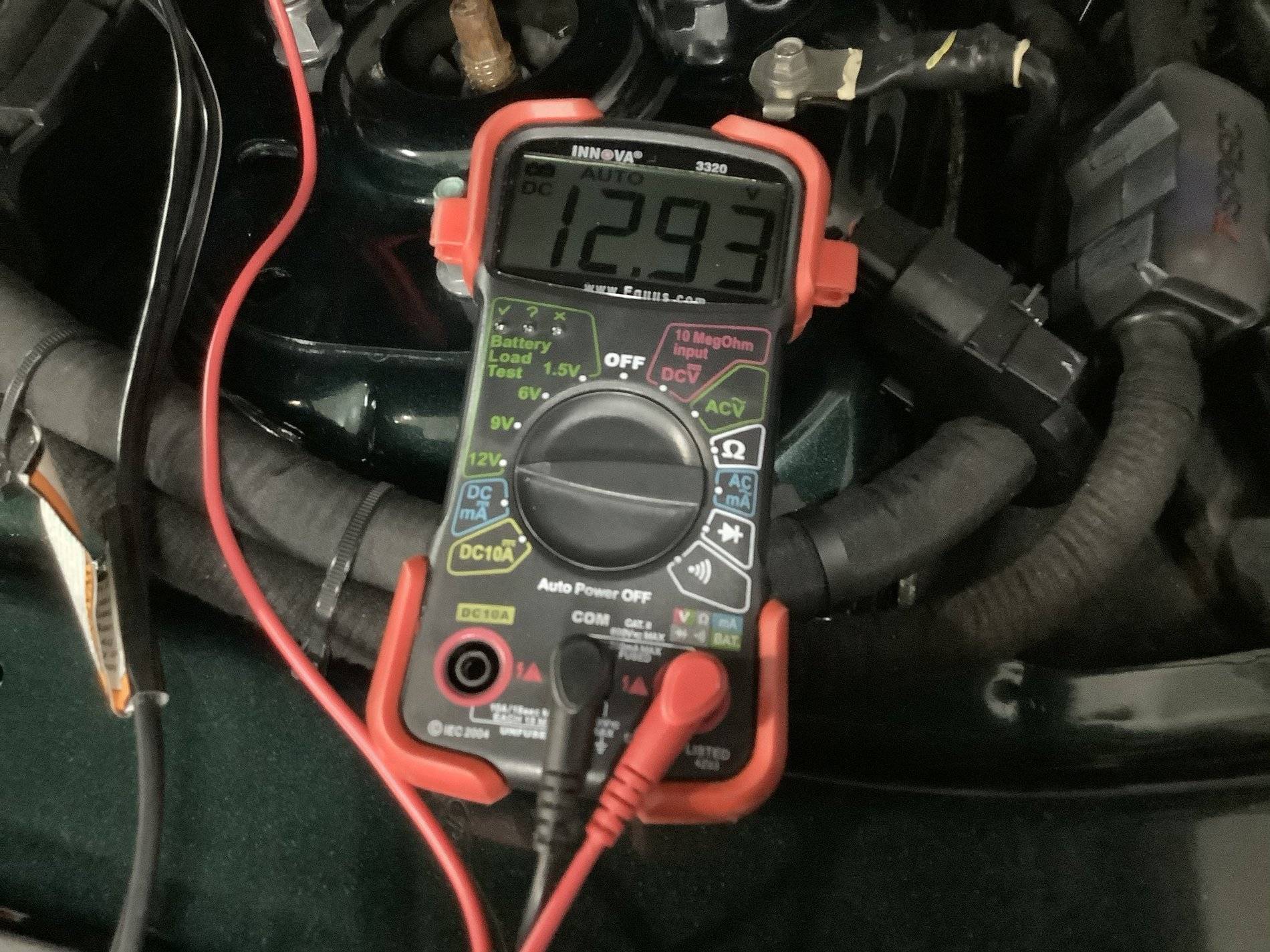

No. You should be fine. My car has been on a battery charger (fully charged and trickle charging) for several days. Here is what it is reading at this very moment.
That’s while the car is off correct?
