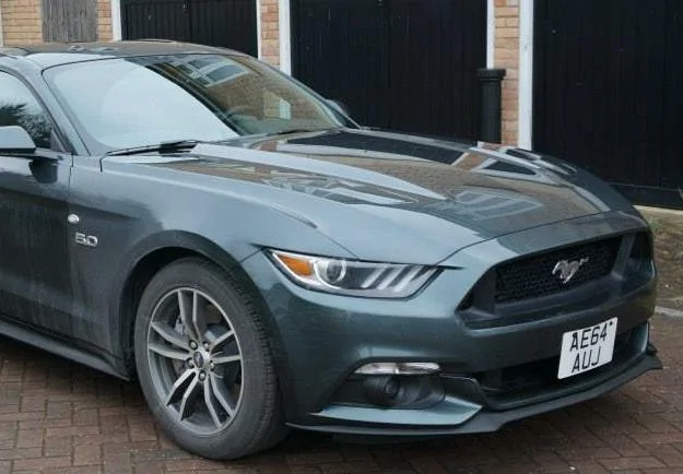

I'm going to end up putting the turn signals in the mirror too. Part of the importation process in England is the "Light Conversion". They put turn signals on the side just above the badges, put amber led strips under the taillights and wired the taillights for rear fog lights. They pretty much take a nice, new vehicle and ruin it. The side signals are wired directly to the front turn signals. It works fine but it's an eyesore. :doh:
