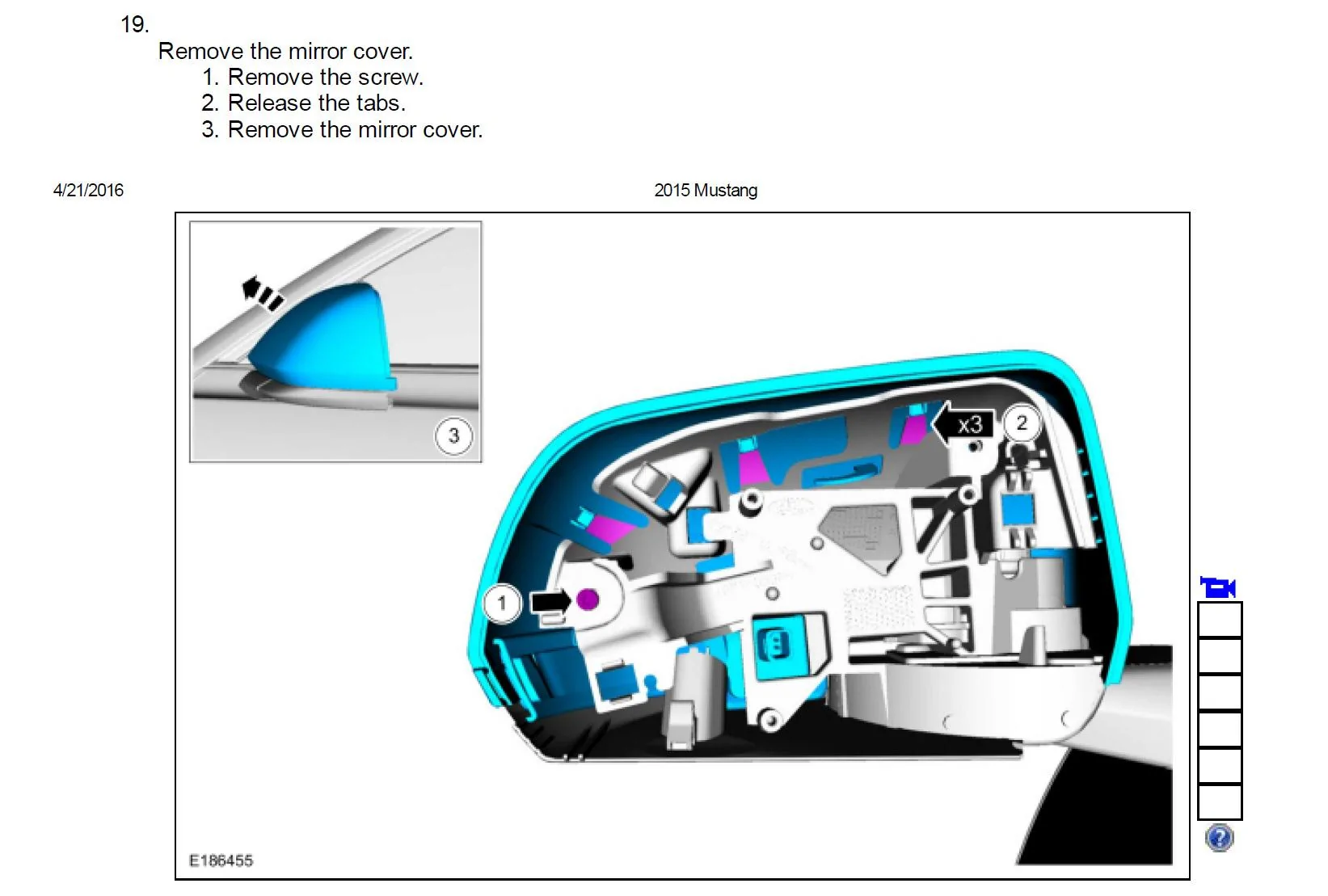

According to this, there's a screw and 3 tabs holding the cap in place. Have to remove the mirror glass and mirror adjusting motor to get to the screw.
https://www.mustang6g.com/forums/attachment.php?attachmentid=75848&d=1462679315

There is no screw holding the cap in place. You just pull them off with a little bit of force and they snap back on. I’ve had mine off a few times to have them wrapped.

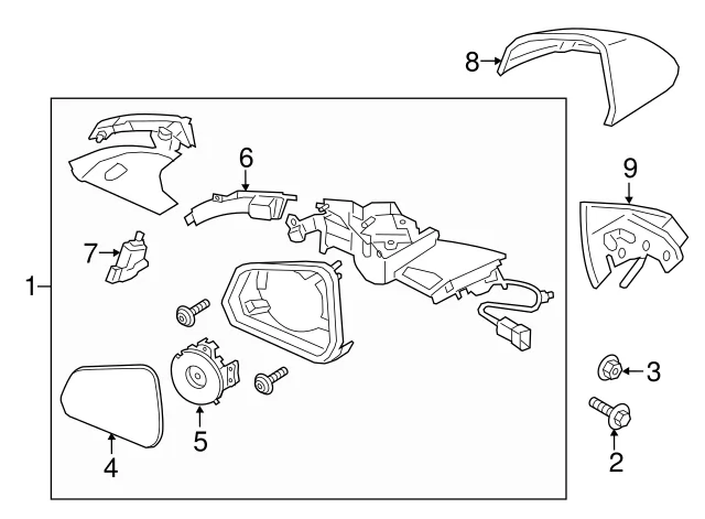

Does the factory mirror cap have clips or say “edging” that slips in or snaps into and behind the edge of the black area of the mirror assembly?
Any pics of a removed cap? The Ford Tech drawing affixed to this thread does not help with my question... thx!
