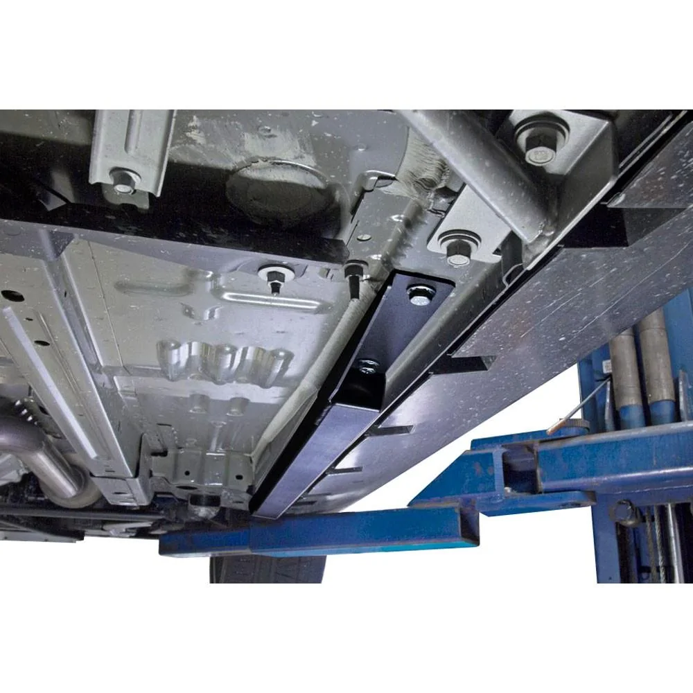

did mine in the driveway laying on the ground. anyone have pics with these installed along with the Steeda IRS brace?

They don't mount to the same place - they both go on no problem.
My build log has a picture of the IRS brace and the opposite side of the focal point of the picture you can pretty much see the brace and then the jacking rail in front of it.

thanks. about to pull the trigger on getting a set. prefer real world experience from others that have used the products before.:first:

The biggest Issue I had installing mine was scraping off all the sealer thing so the front two bolts would sit right.

Yeah, it is not an exact science with these cars on the sealant & how the jacking rails will install.

Yea, it just took a bit of time with a mirror and a screw driver to scrap it out. Was just really annoying lol.
