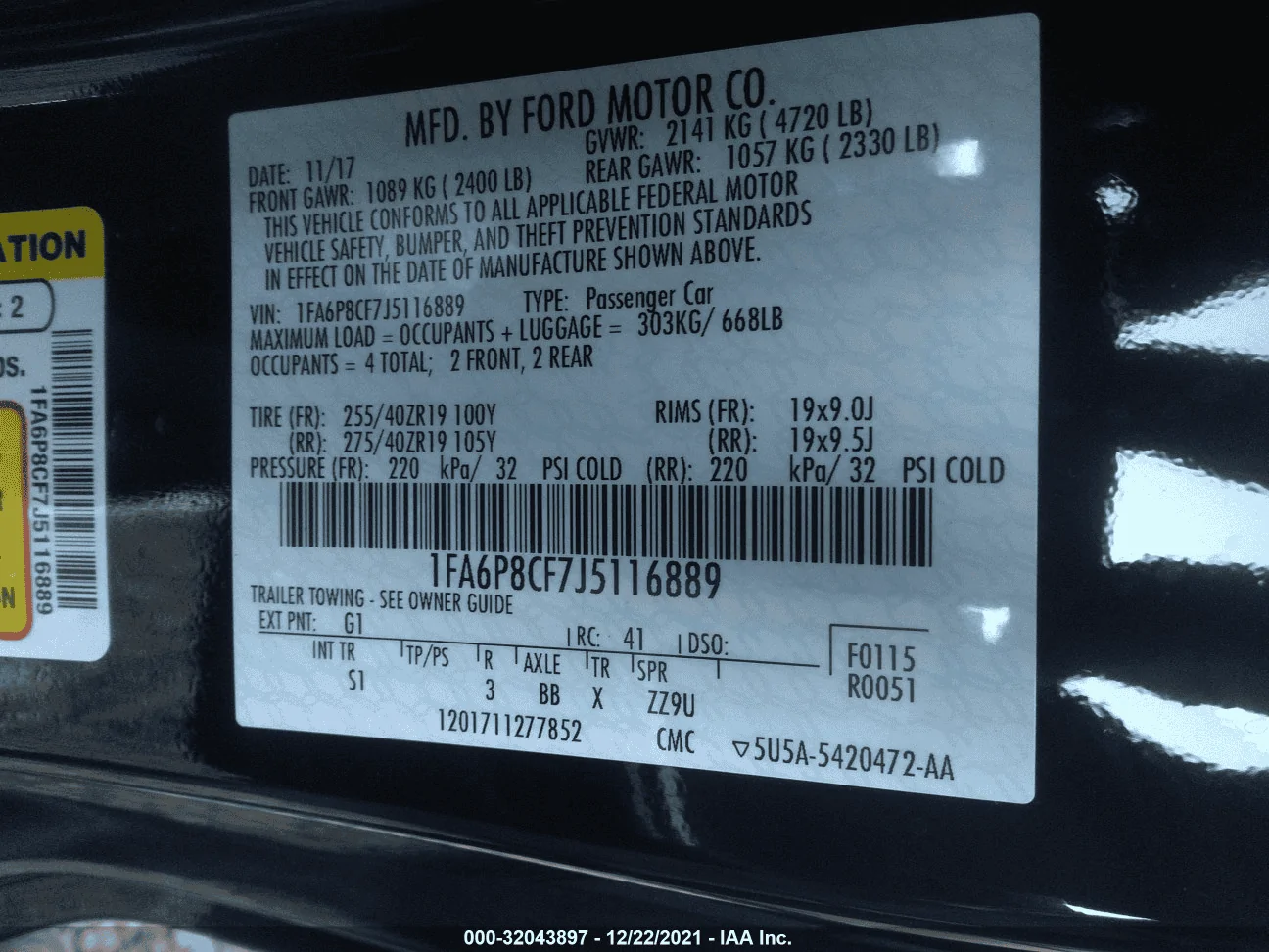

From the wreck pictures, it looks like a PP1. They also post the door jamb sticker which shows the installed tires (255 and 275) and wheels (9.0 and 9.5) which match PP1 specs not PP2.

Thanks, folks!! I didn’t see the tire decal on the wreck photos I found - safe to say that it would note the PP2-specific tires rather than the PP1 in every case?
