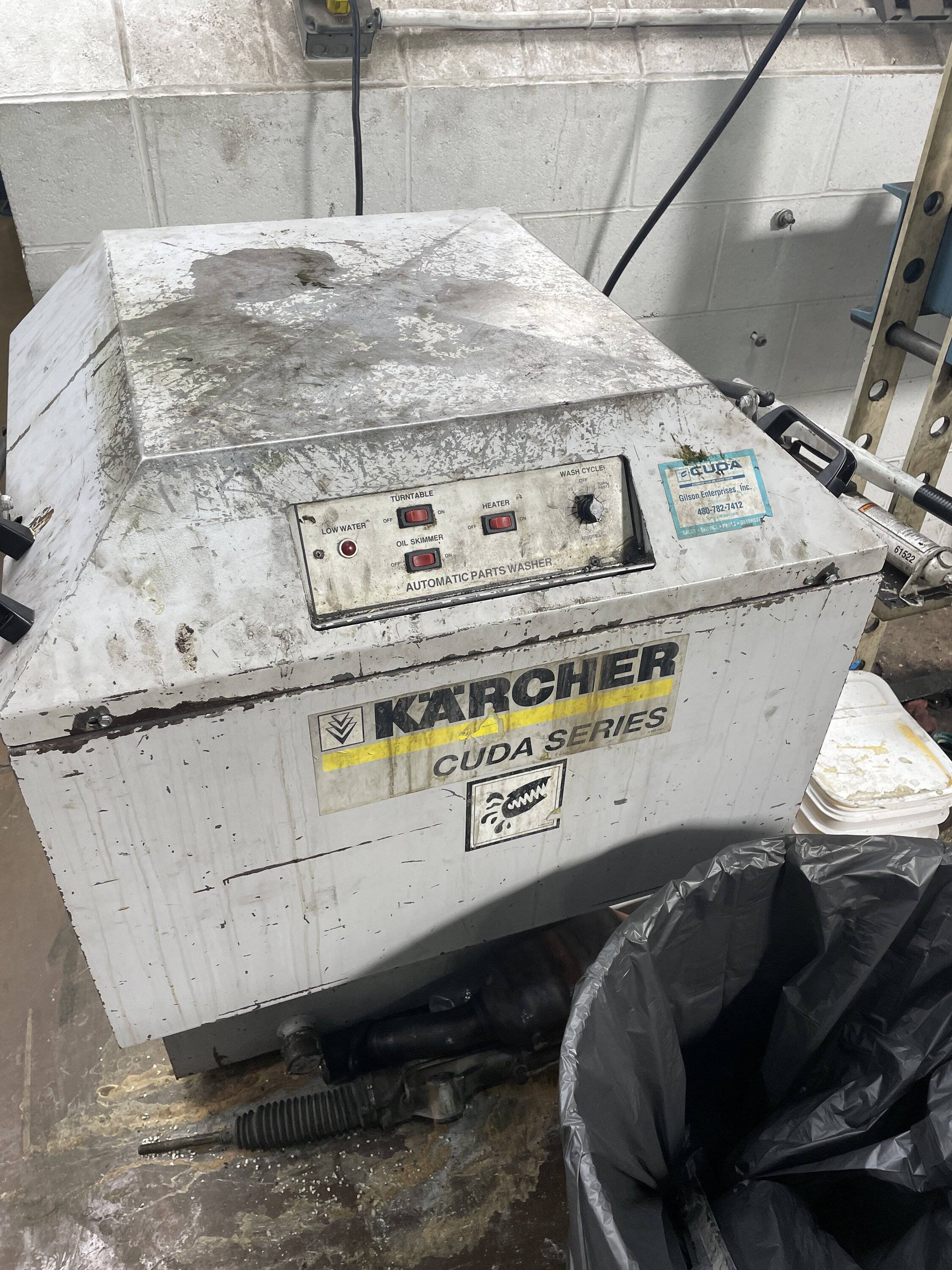

Would this work?

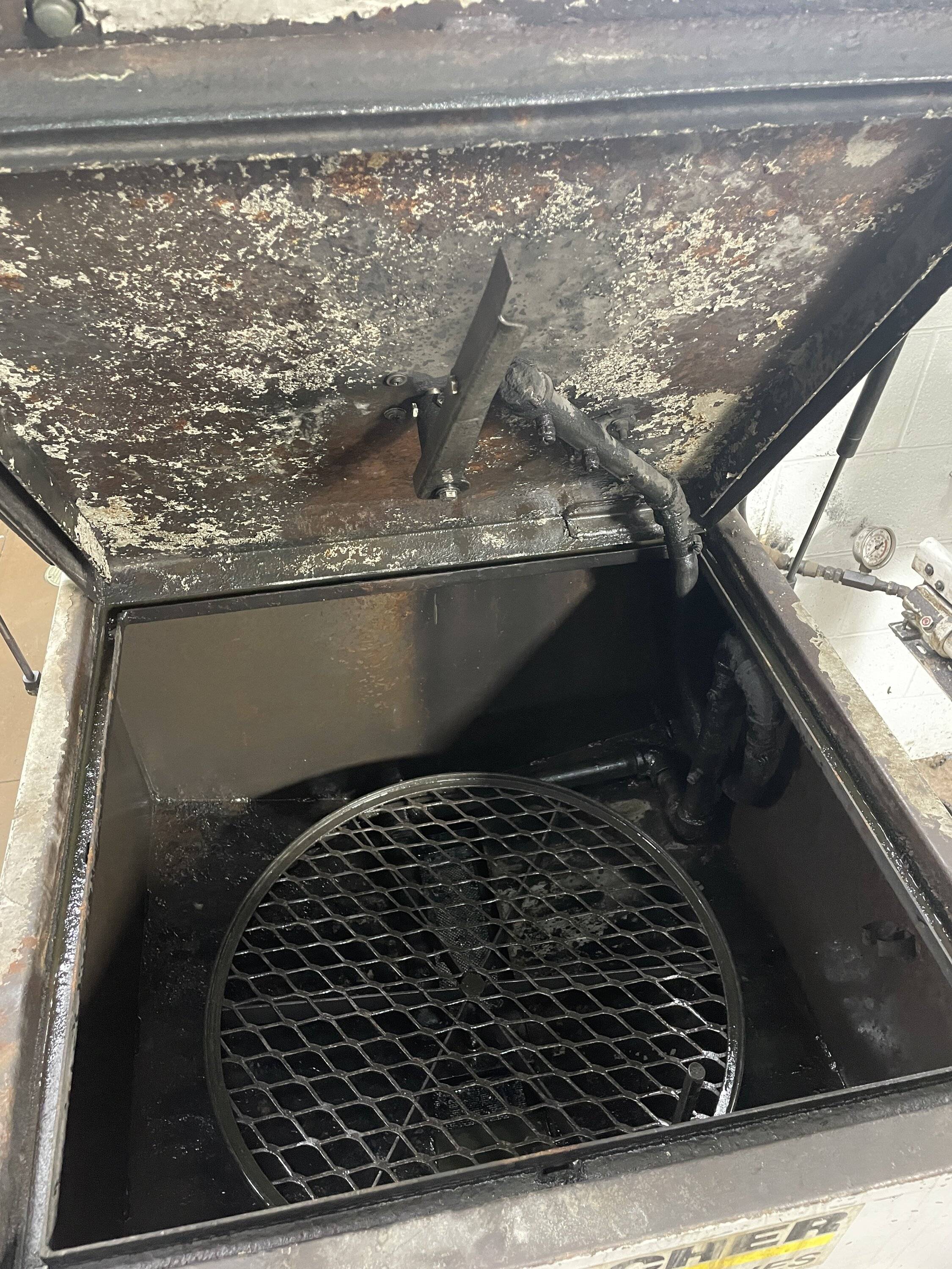

Not sure. What should I look out for?
That’s not a vapor degreaser.
It’s an Aqueous pressurized parts washer.
Get a larger disposable aluminum pan and find a portable compressor and clean them yourself with whatever solvent you choose.

You don’t think this would do an okay job?

Hard pass man !
IMO
What’s the difference between the pressure washer and the vaporizer? Is it just because of rust or are you thinking more contaminants?
