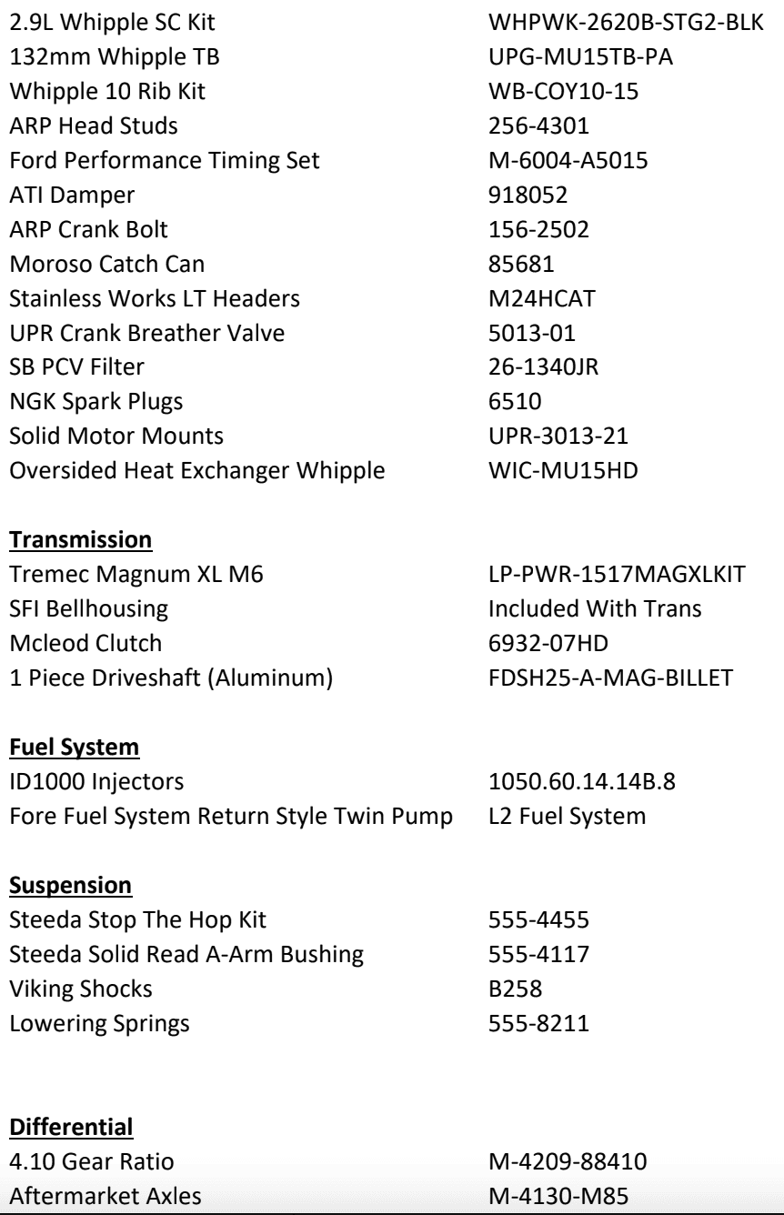

I think you are close to maxed out with stock axels, you didn't list any upgrades there, as well as other mods to the rear suspension that have been covered a lot here, just do a search.
Here is the full list of mods except instead of a dual I was told it has a triple pump (don't really know how to check tbh), and also has an aluminator.
It does have axles. Sorry should have put this whole list on the first post.
