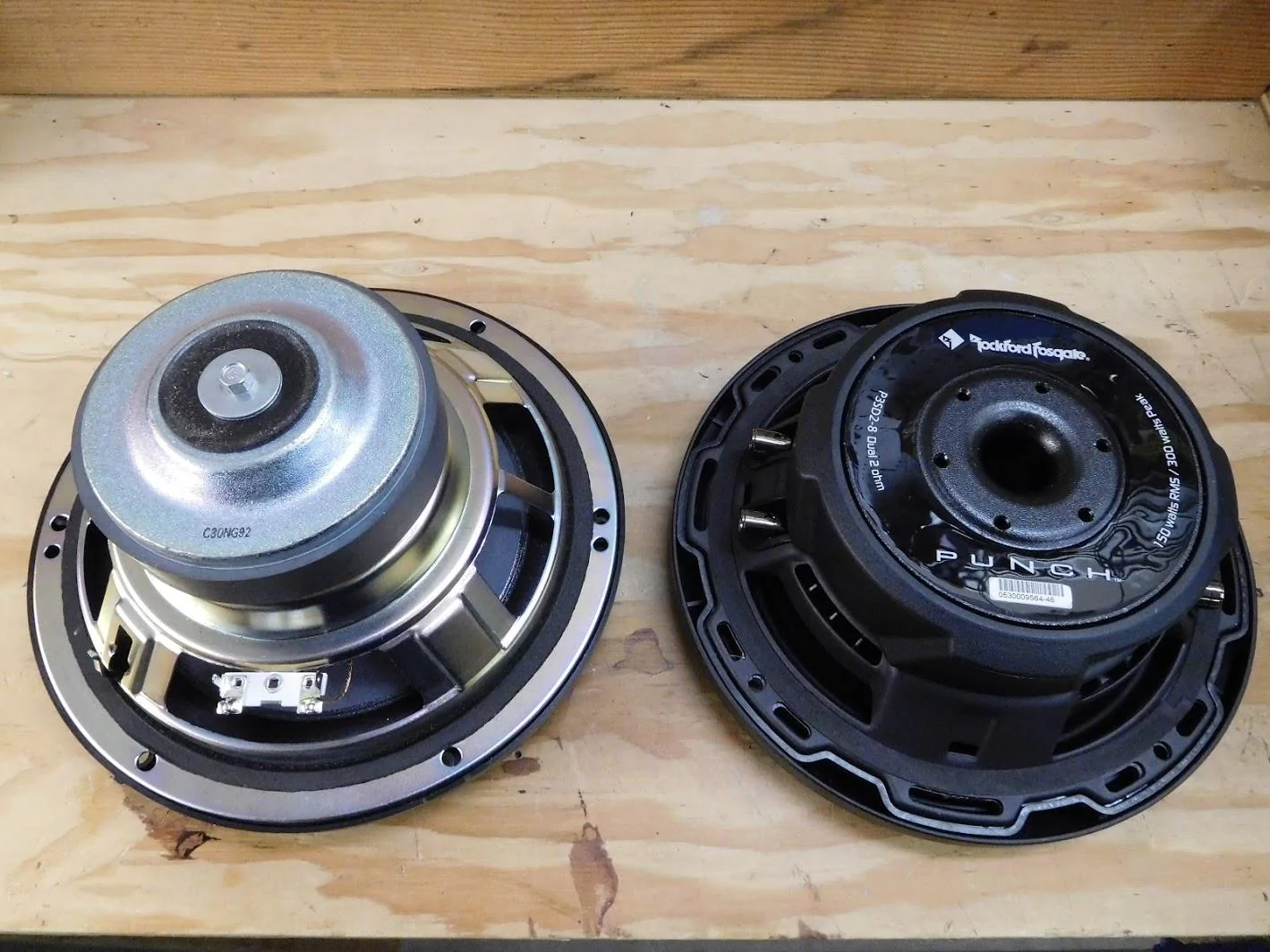

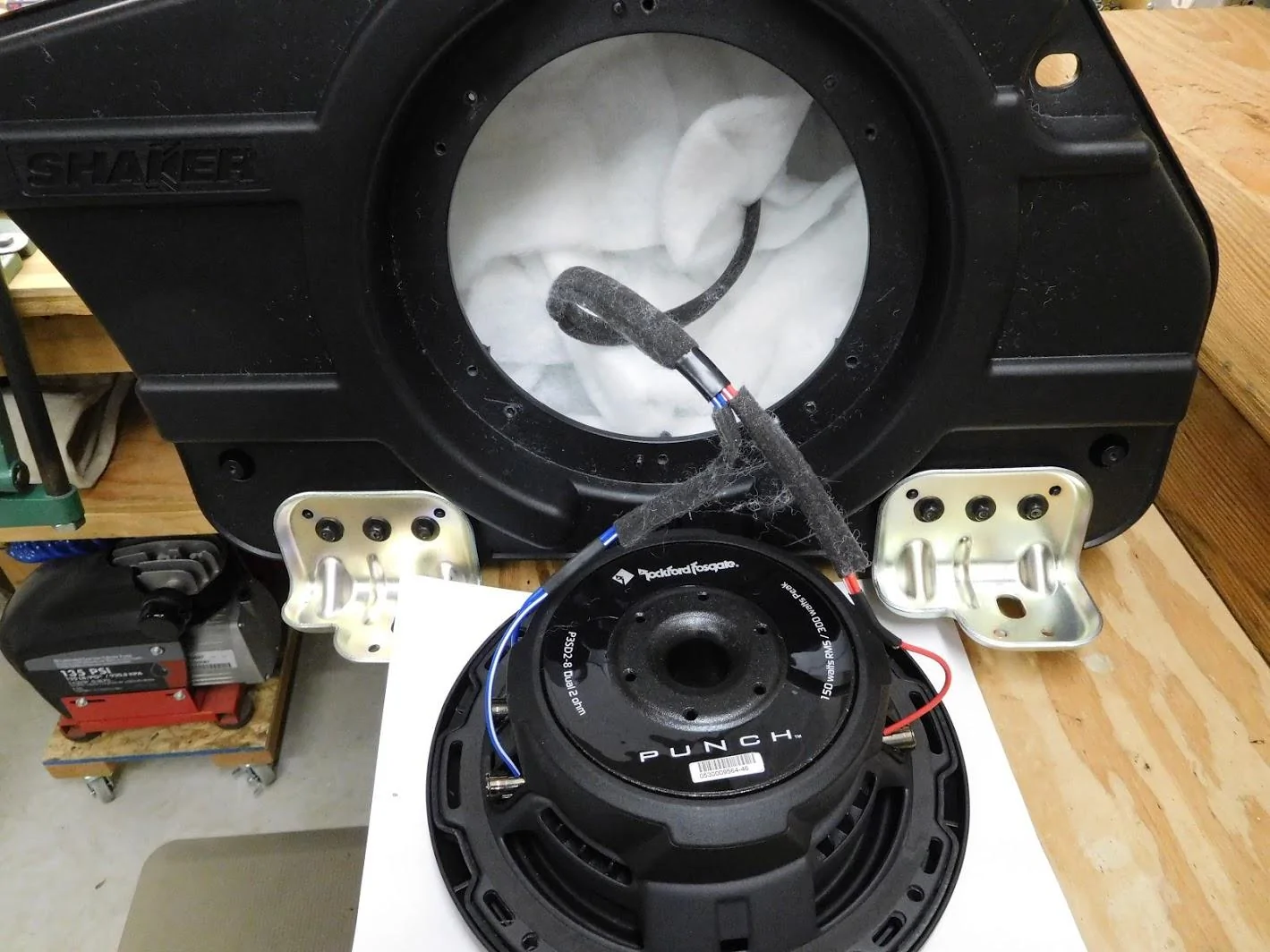

I added polyfill and upgraded to a Rockford Fosgate sub. Much better sound!

Questions! Was the Punch a direct replacement as far as bolting it back in, uses the same holes? How about the wiring? At one point in time I rewired an entire cadillac and added more speakers than it came with. Now I'm lazy about this so I'd consider a direct replacement but don't want to do any wiring if I can avoid it. Did the sound improve enough to make it worth the price of the Punch?

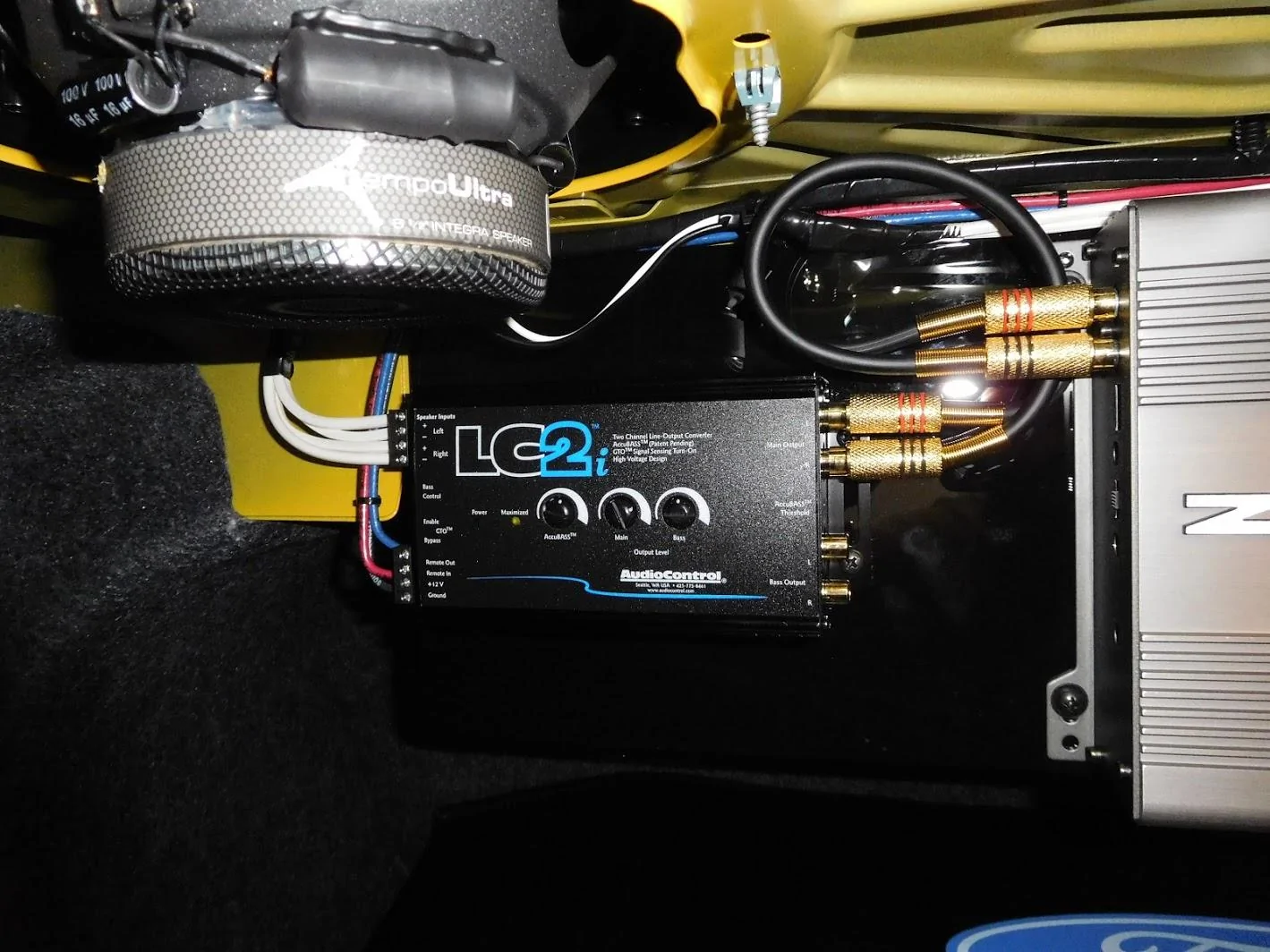

Holes don't line up so I drilled new holes and used #6 x 3/4" screws. You use the stock wiring in the binding posts on the speaker. "Worth" is relative, it was worth it to me and I'll be adding an amp for the sub that will be adjusted thru my LC2i. The OEM amp is a POS
