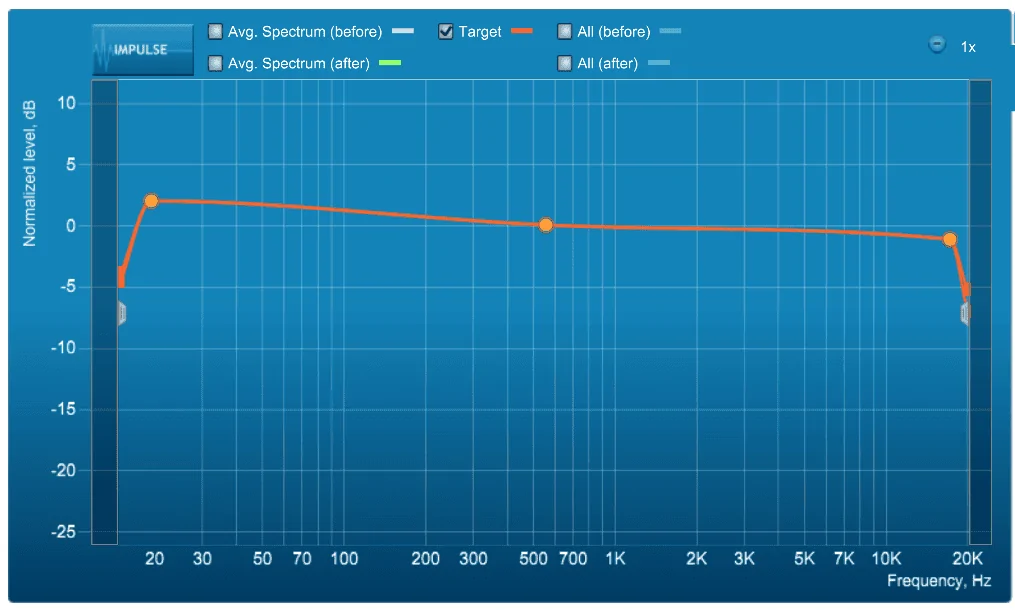

I auditioned the B&O system at a dealer before getting my car. I considered ordering and wanted to know if it was worth the extra $900. At first I concluded that it wasn’t. And my opinion was unchanged until now. The bass was way bloated and I couldn’t seem to turn it down enough. The sound quality was rough, and there was not a good stereo image.
It’s as if some Ford project manager swooped in just before sign-off and exclaimed, “Where’s the bass?! We gotta crank up the bass or no one will like it!” Well, I don’t like artificially bloated bass. Here is the custom target curve for my high-end home system. There is about 2dB gradual emphasis from high to low frequency.
2020-05-08 17_18_29-Dirac Live Calibration Tool (DiracPreset1(EllenTargetTo1300Hz)).png

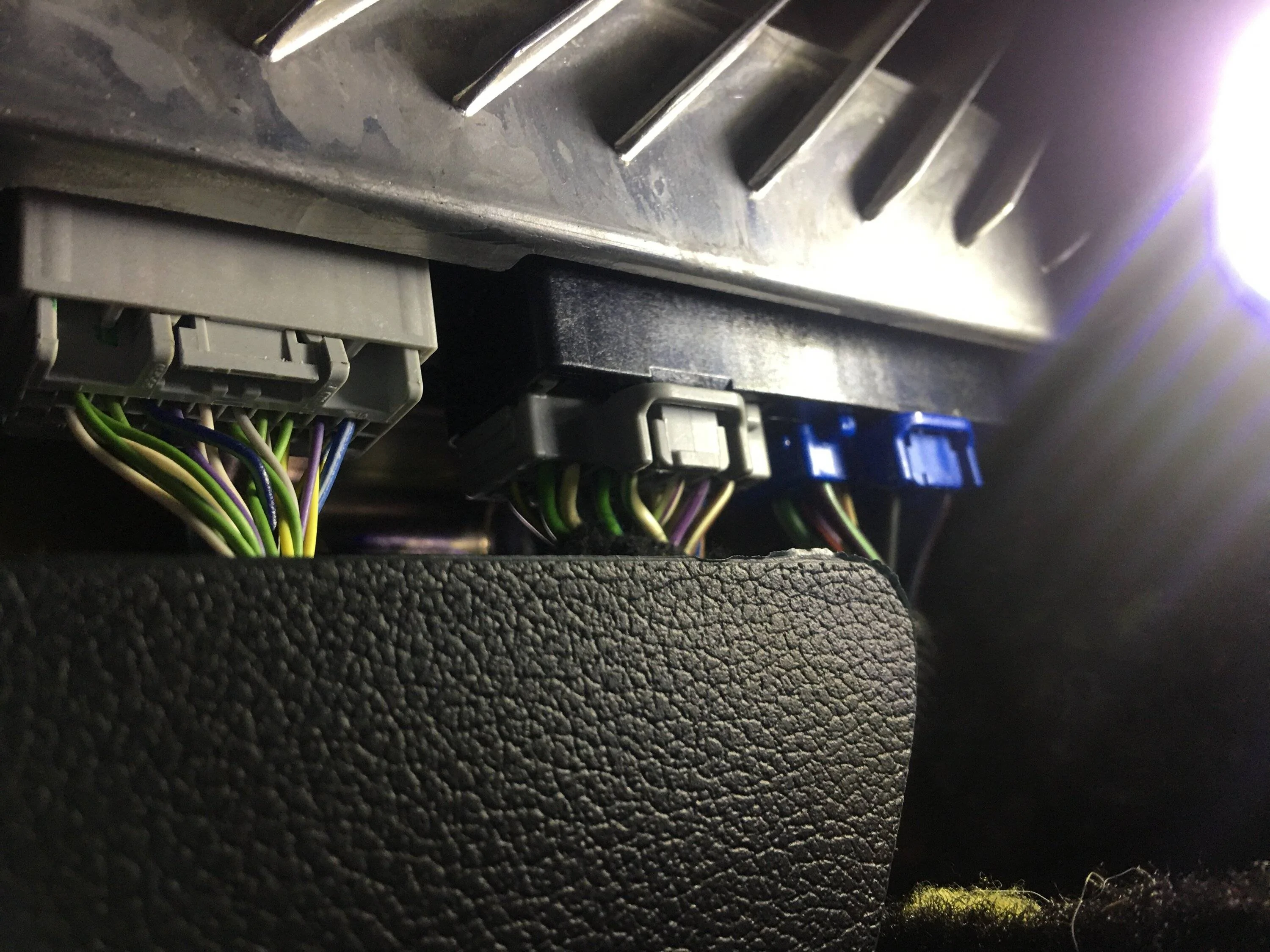

Regardless I found a nearly fully loaded car and it came with the B&O system. Oh well, I thought, at least it will have a CD player, and subwoofer wiring harness in case I want to replace it. I already knew about snipping the center speaker wire on my 2016 Mustang.
Some of you may have read my thread “Join me in fixing the center speaker issue”. The overall conclusion of that thread (and as confirmed by many others) is that the sound is simply better with NO center speaker playing. And so we have snipped the green wire (positive lead) going to the speaker, near the amp connector.
Which green wire do I snip? I have a 2019 with B&O system

Ten second mod to improve the sound. Much, much easier than removing speaker panel risking breakage and scratches.
I look at it this way. I know I won't ever want the center speaker playing again, and even a high-end driver put in there won't improve the front stage image.
Furthermore, if I sold the car, I'm actually doing the next owner a favor by not having the center play.

Just removed center speaker from my 2021 Mach1. Sounds much nicer. I slightly lifted the top center of the gauge bezel then removed the top speaker cover. I used a plastic pry tool. Then removed speaker and unplugged it and put it all back. 20 mins.
