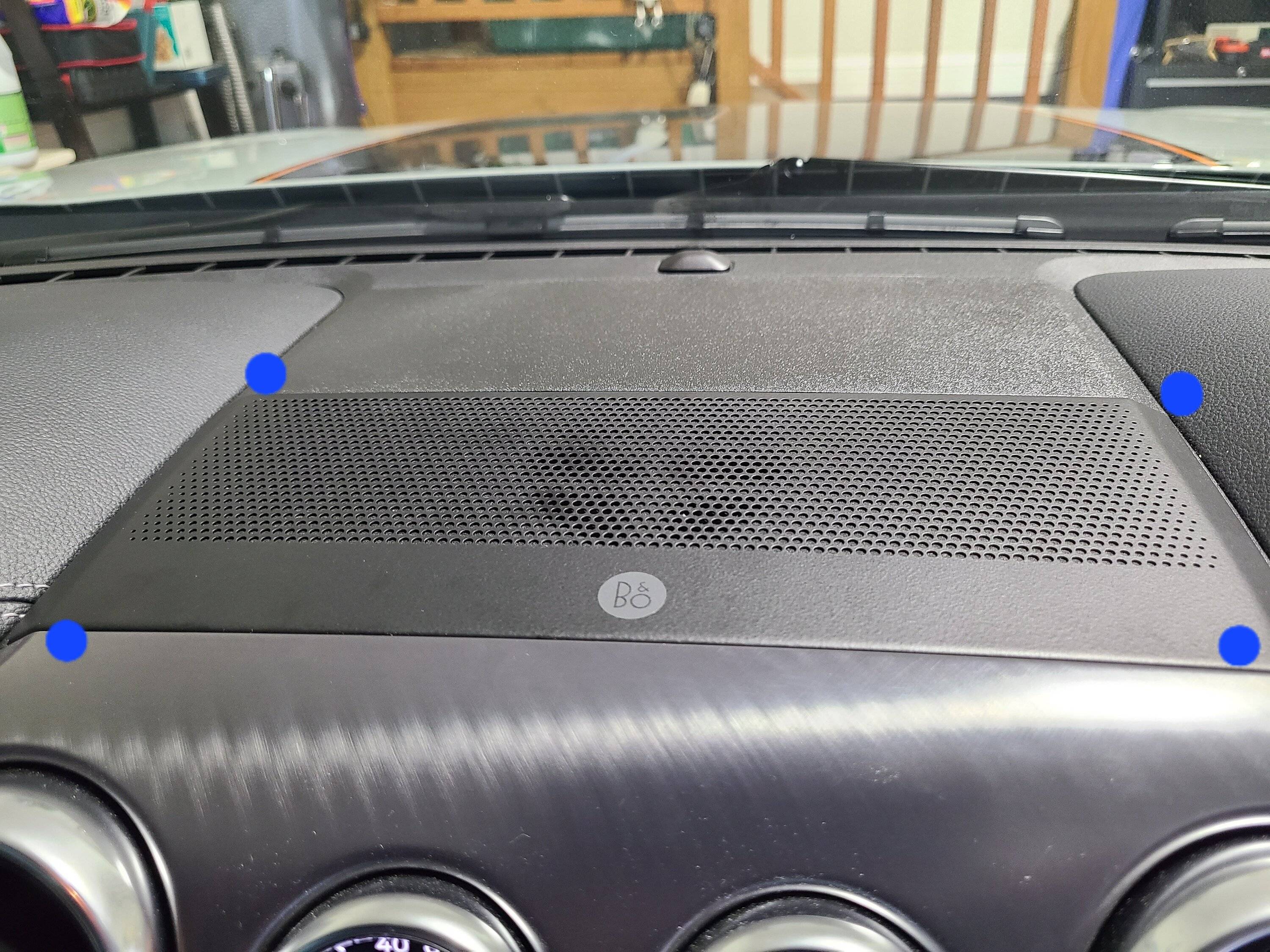

Hi Mark,
I wanted to know when you removed the grill cover was it just the small grill itself or is that piece just behind it part of it too? I placed blue dots on the corners to mark the grill. Is this all that pops up? Thanks!
I don t have the BO system and the other one looks a little different. I d assume when you pop the first two front corners after loosening that front bezel you ll see where it will separate.
If you look at my pictures you ll see my grill and the whole piece all the way to the windshield comes off with only the 2 front clips. The rest is just posts to line it all up.

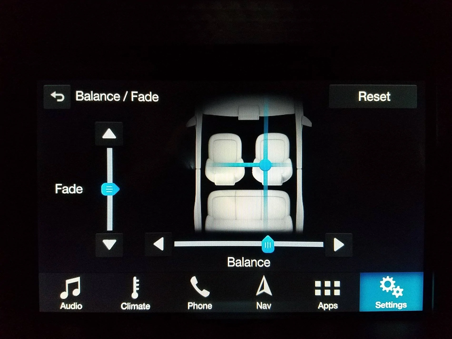

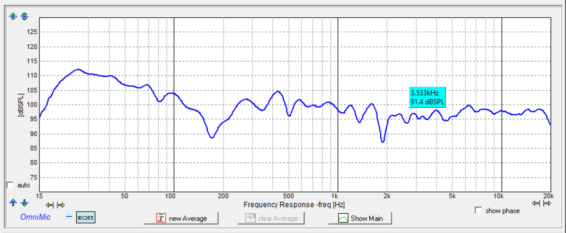

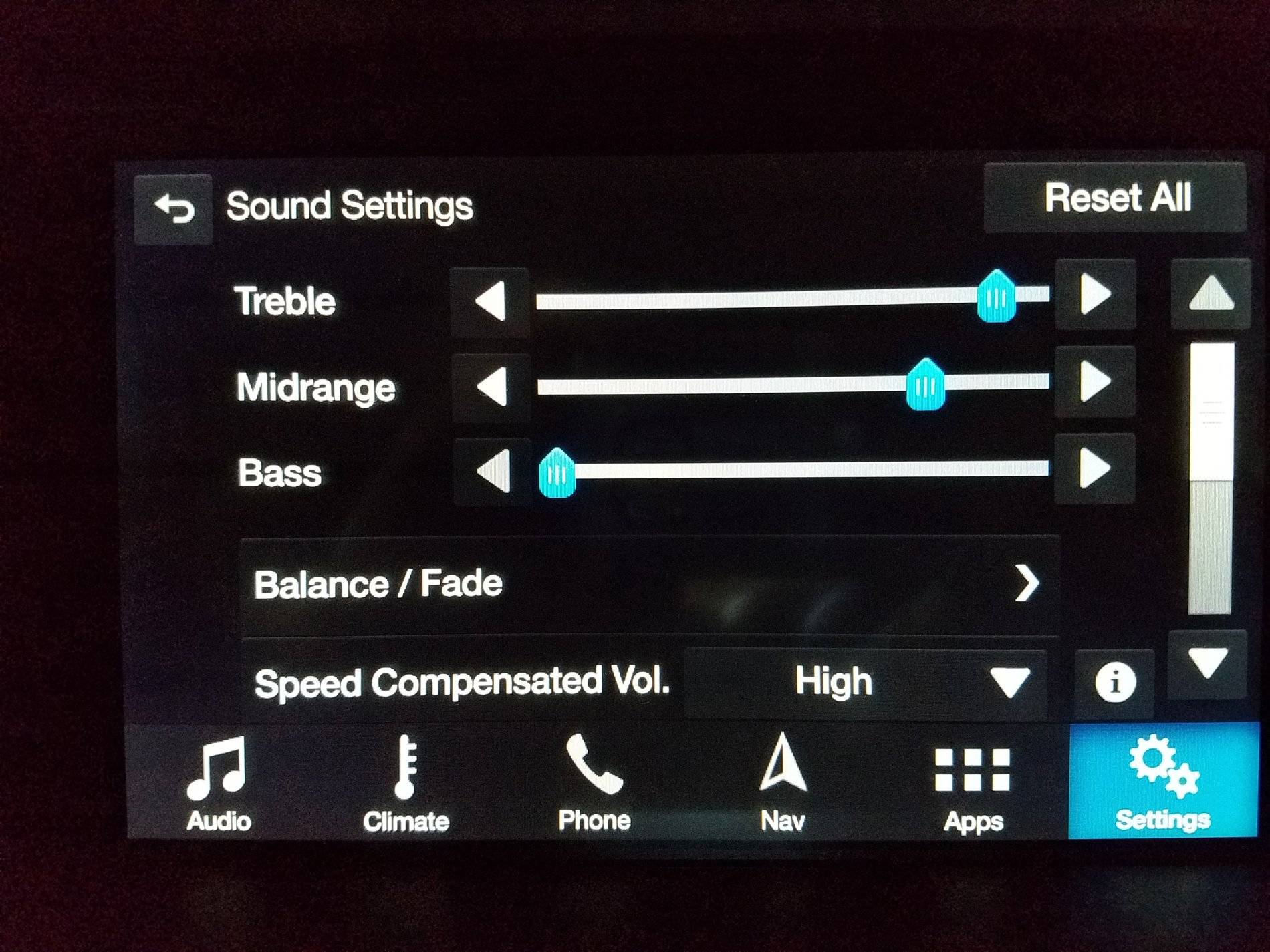

TLDR takeaways:
  1. The factory set the level of the B&O subwoofer way too high by at least 12dB.
  2. The tonal balance can be adjusted close to flat with somewhat extreme settings of the 3 tone controls.
  3. Imaging is better with the balance 1 click shy of centered on the passenger seat centerline. (For when there is no passenger, and assuming center channel speaker is OFF.)
After much testing and experimenting, I improved the sound of the B&O system just by adjusting the controls.
Here is the final result:
Even after setting the subwoofer tone control to minimum, and the midrange control up by 4 clicks and the treble up by +5 or +6, the subwoofer level is still too hot by around 6dB.
Here are the settings (the balance is set for driver with no passenger):

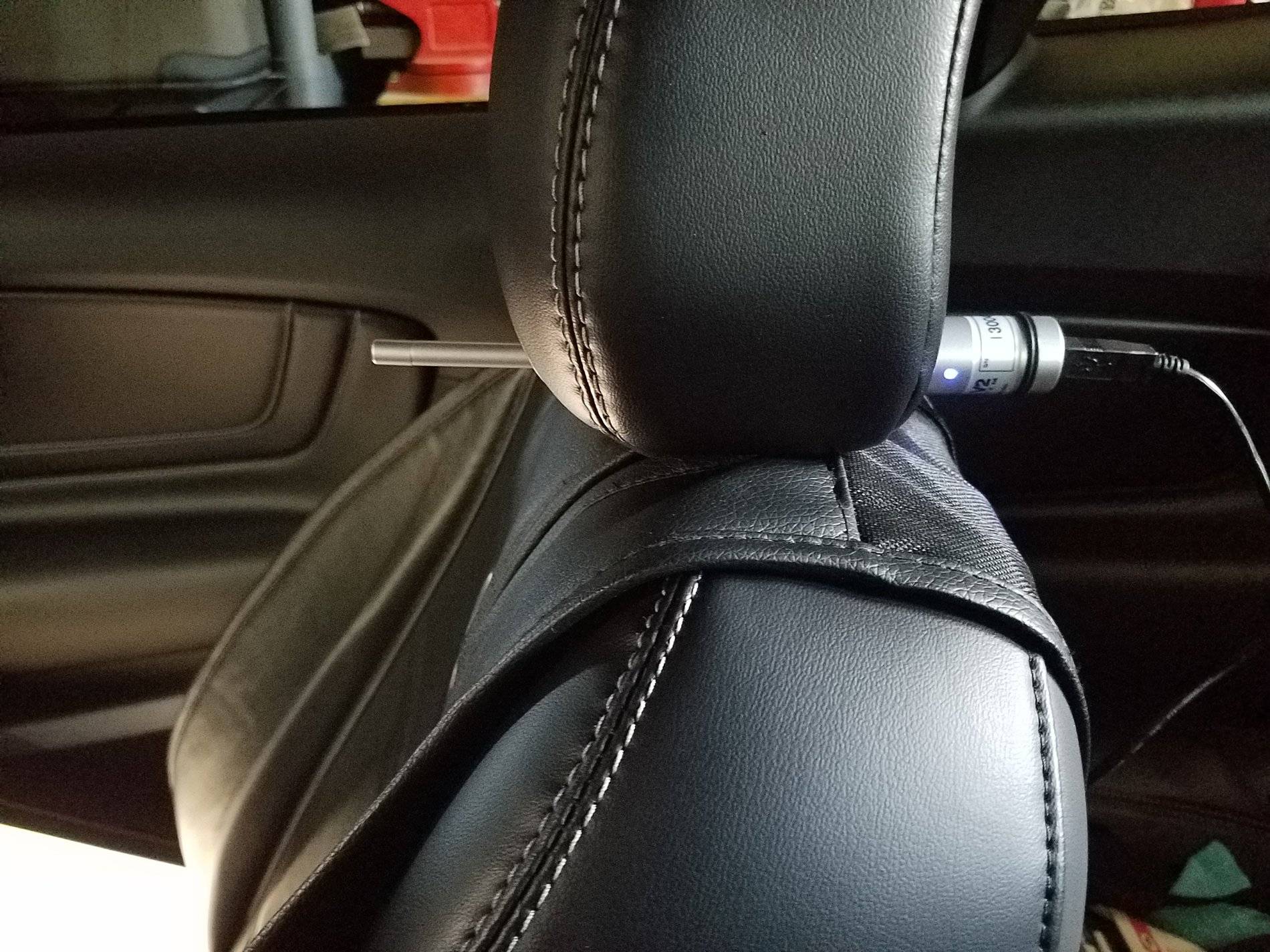

The OmniMic was placed into passenger headrest:
I will post supporting data that lead me to this alignment next.

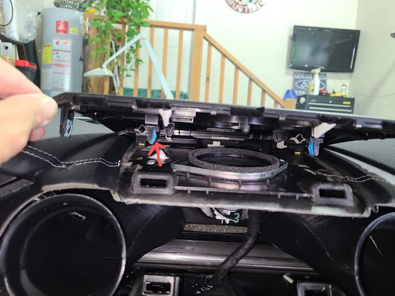

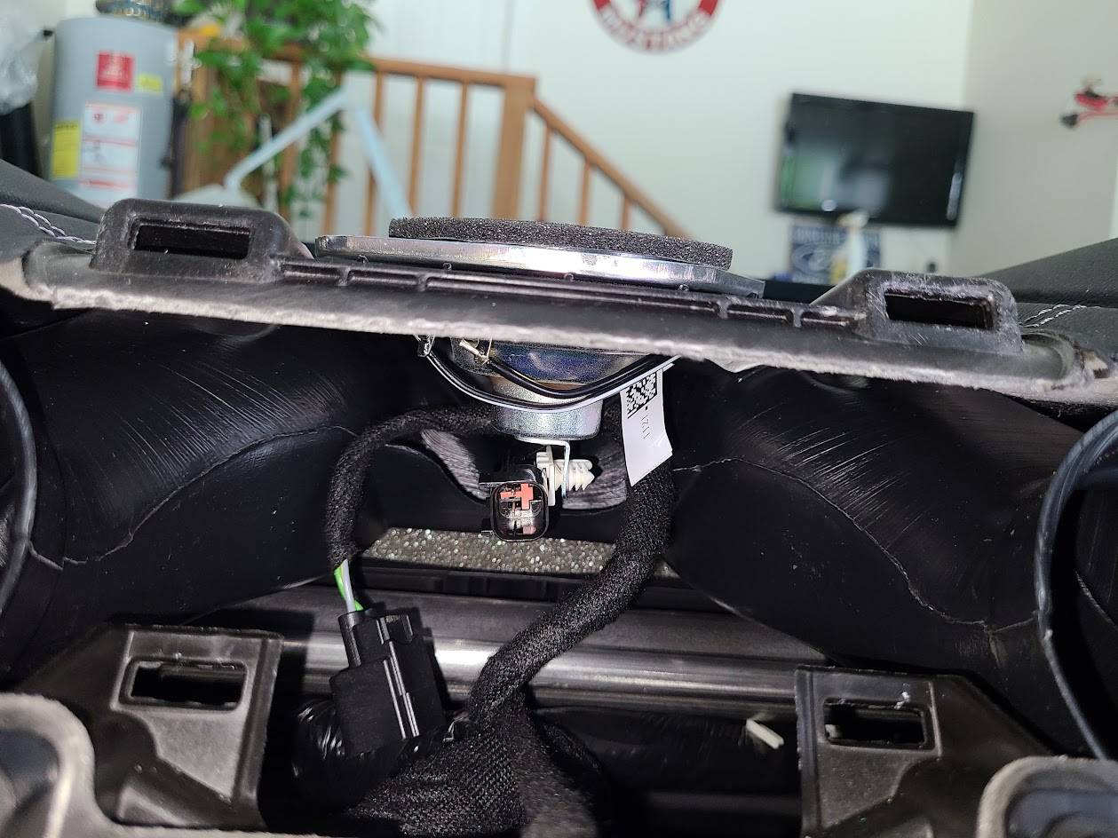

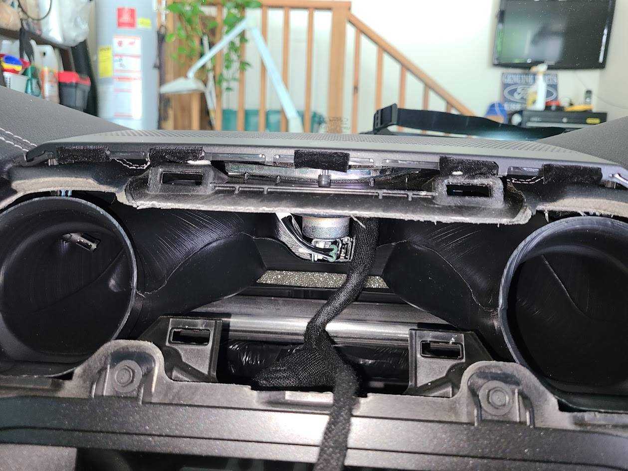

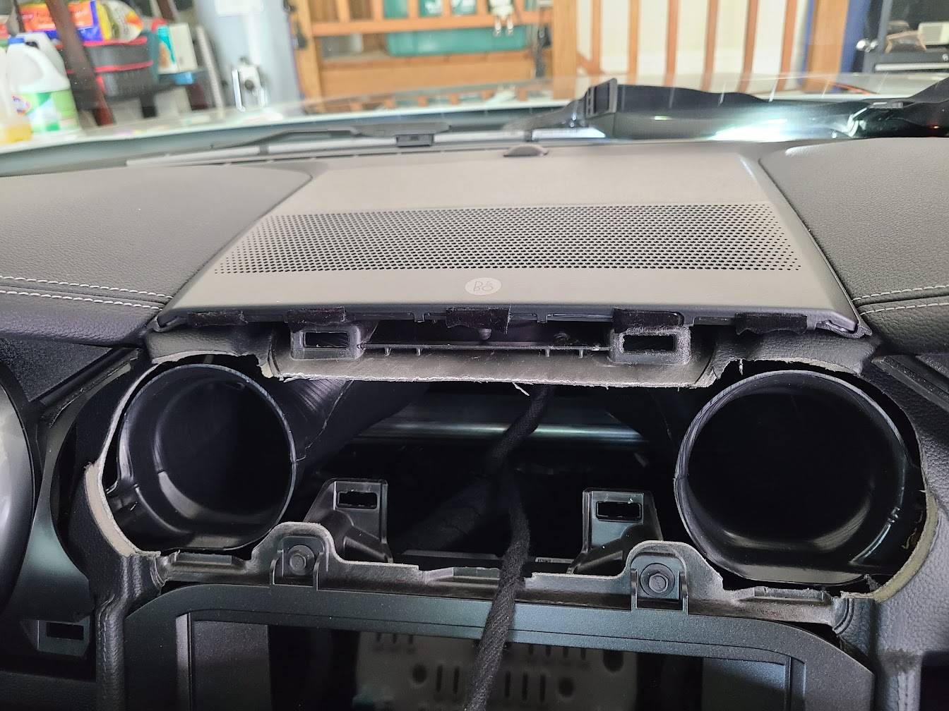

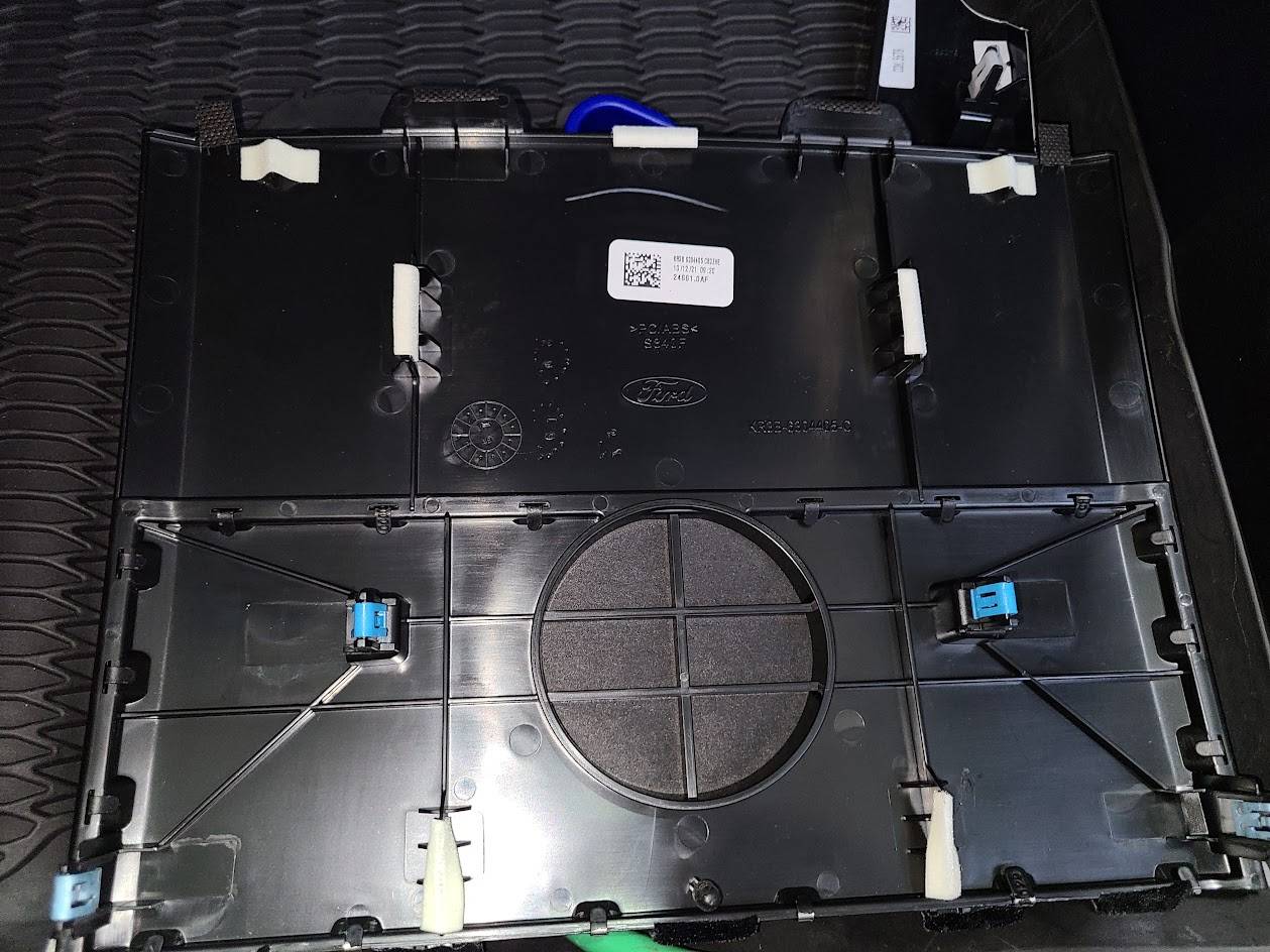

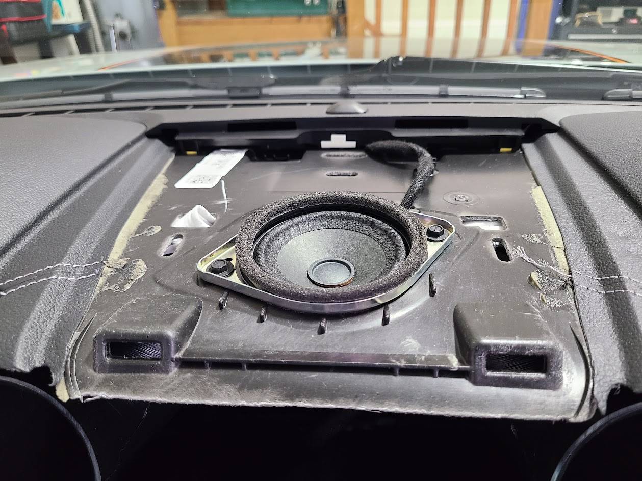

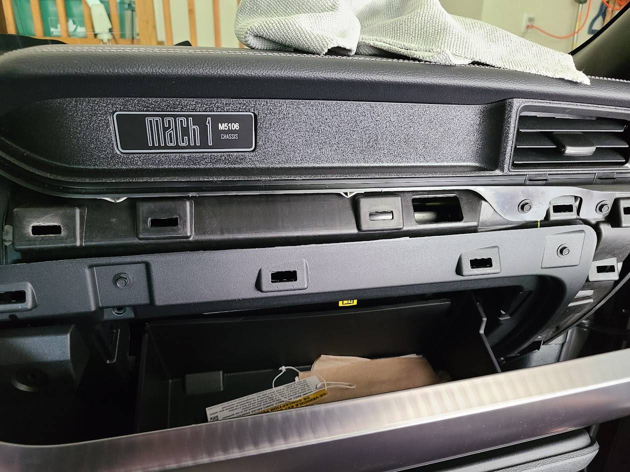

Update!
I decided to go forward without clipping the green wire but instead removing the center speaker grill/ bezel and disconnecting the plug. I found out the removal process is basically the same on the 12-speaker B&O system regardless of which grill you have even though Ford calls out the vented grill with my VIN #.
I will say the left side was a little harder to remove but I figured out a trick by squeezing below the tab I marked with a red and it pulled through very easily. After removing the connector from the speaker I decided since there was enough wire to flip the speaker 180 deg which gave me access to the front where I can plug the connector back in without removing the cover if I desire.
Thanks again to GTP for his audio expertise!

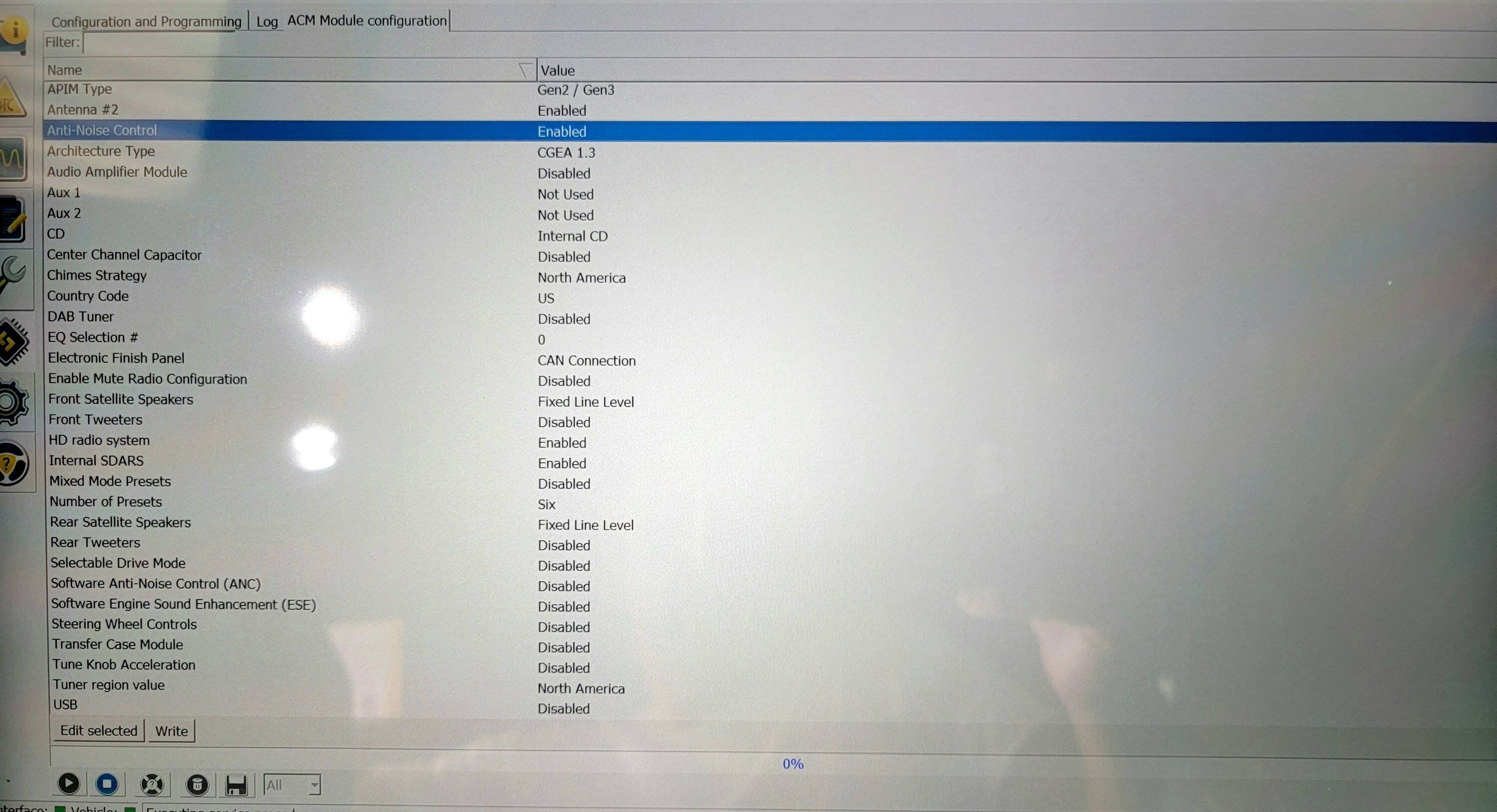

My system sounded horrible until I checked forscan and found that my front, rear, and center speakers were disabled. So I enabled them and now the system sounds like a premium sound system.
I had to read and reread your post a couple of times as to why your system sounded horrible and unless I’m totally missing something….
If your front, rear and center speakers were “disabled” in the Forscan findings, wouldn’t that mean your vehcile had no sound?
